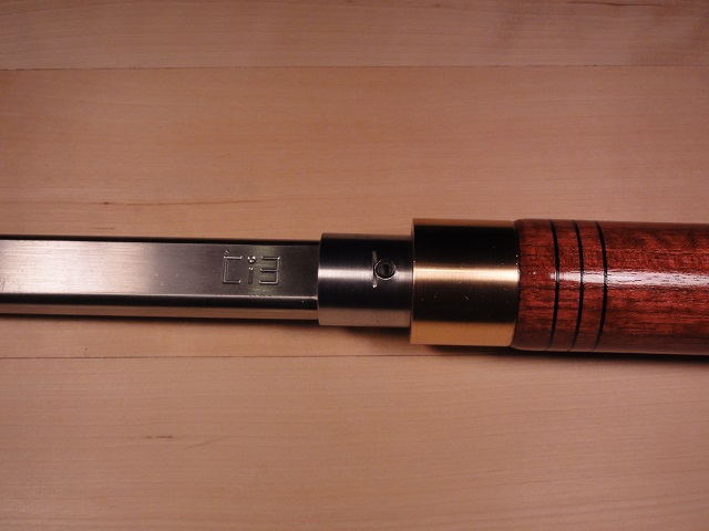

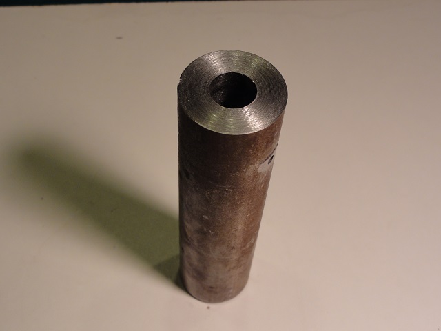

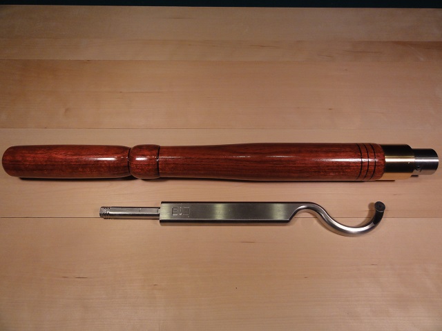

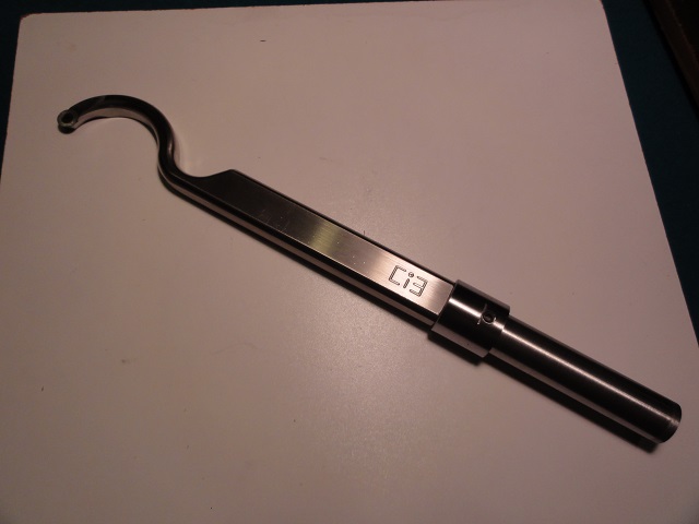

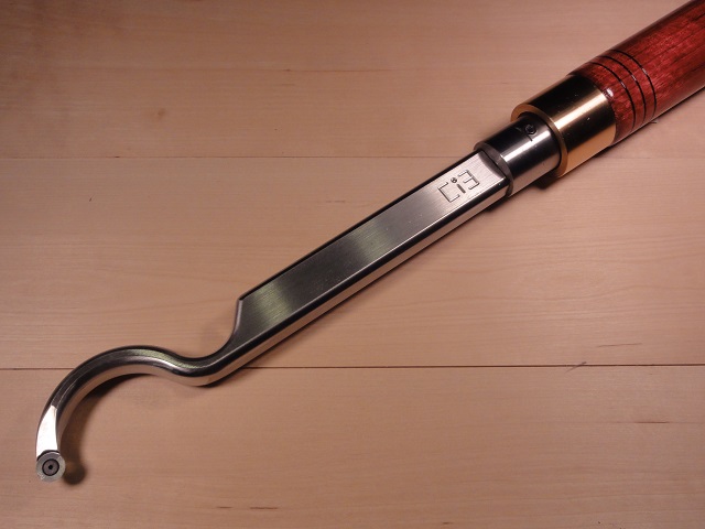

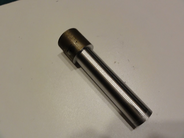

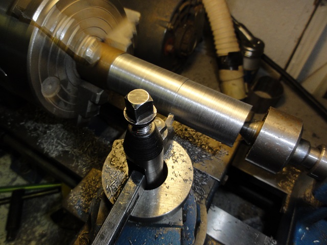

June 4, 20179 yr Popular Post comment_111773 I bought an Easy Hollower by Easy Wood Tools some months ago. I bought it without the handle with the idea of making something special for it. I figured I should make the tool removable since there are other hollowing tools available for future purchase possibilities. I had a piece of 1.5" diameter steel rod out in the metal shop so I cut a 4" piece off and took it to the metal lathe and drilled a .5" hole 3" deep for the tool tang. I stuck the end with the hole in the chuck and turned 3" of the shaft down to .875" (7/8) diameter to be inserted into the wood handle. I also drilled and tapped a hole for a .25" set screw. Here is the tool with the insert attached. Time for the handle. Took an 2"X2"X22" piece of Purple Heart and chucked it into the lathe. I drilled a .875" hole in the end for the insert and turned the end to fit a brass bushing on it for support and installed it. Turned the rest of the handle for a total handle length of 18" and with the tool mounted the overall length is 27.5". Next up is a project putting it to use. That will be soon and in another thread. Report
