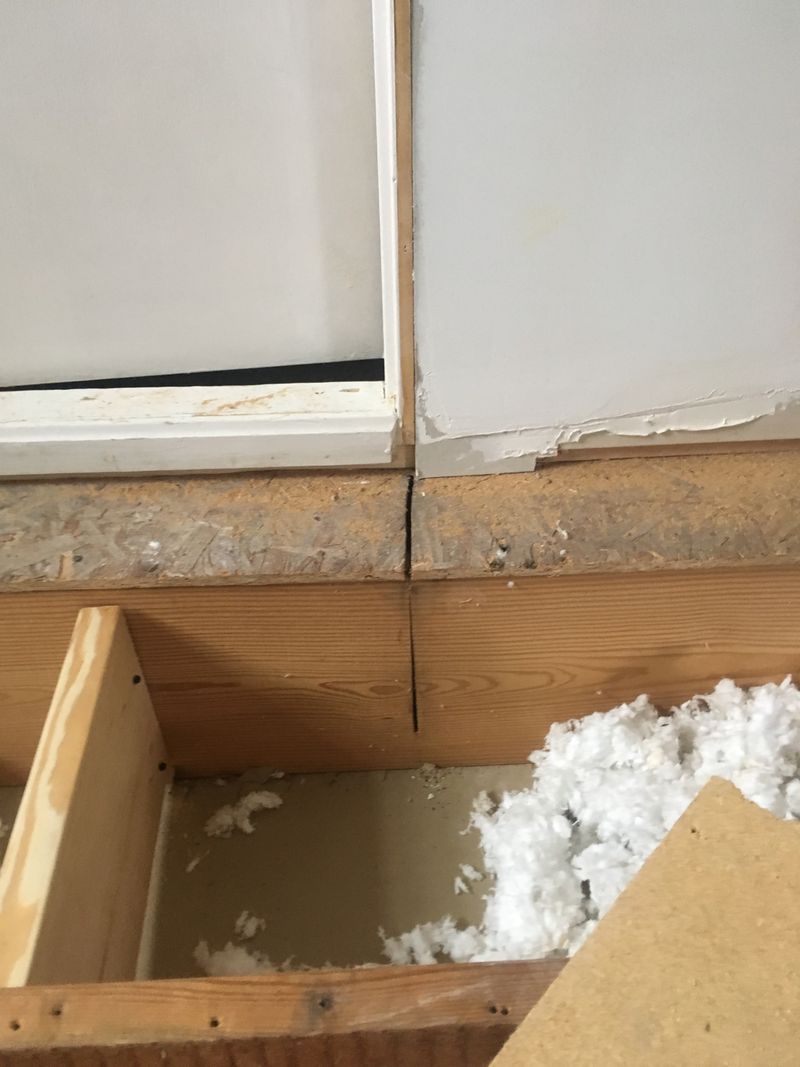

Cal Posted May 6, 2017 Report Posted May 6, 2017 (edited) Maybe I should be happy that they placed the crown up on these boards... Continuing with the upstairs remodel and the two bedrooms. In the one room, the particle board underlayment was quite wavy and so not level. I decided I would pull it up and lay a new layer of 3/4" t&g OSB underlayment. After pulling the particle board up it was very obvious to me that the subfloor had been rained on during construction 30 years ago. It was pretty wavy and soft in a couple spots. I decided to pull a couple pieces of the subfloor and install some canned LEDs in the living room below. Two of the 2x12 floor joists were cut nearly all the way through. I guess they did that to eliminate a high spot? It is not evident in the ceiling downstairs. In any event, I scabbed a piece of 2x10 across them and installed bridging. Years ago I had paid good money to have that space insulated with blown in insulation. Pretty evident that didn't get done properly either So, installing insulation, scabs, bridging, screwing down the subfloor, leveling and screwing down the new underlayment I moved onto bedroom #2. Not quite as bad to begin with, the floor was pretty level and the particle board in "ok" shape - but I pulled it anyway. Only one joist cut, and pretty much zero insulation... Cal Edited November 19, 2017 by Ron Dudelston Added tags Quote

Cal Posted May 6, 2017 Author Report Posted May 6, 2017 Building inspector? We don't need no stinkin' government building inspector looking over our shoulder!!! Building codes? We don't need no stinkin' government building codes either!!! In this area 30 years ago I think it "might" have been somewhat normal for the building inspector to give a "nod & a wink" to a contractor friend who obtained a building permit to build a house "for themselves". After completion the for sale sign would go up; probably because the contractor's wife changed her mind regarding location/colors/style or whatever, and the process would be repeated. I hope it is not like that today. Gene, you are correct that I did not anticipate quite this much. And I am happy to be correcting it as I move along. In that first bedroom there was a full 3/4" dip in one area I had to correct to level up the floor! And yet, the ceiling below it is pretty level. The only explanation I have at this time is that it was constructed with that wavy floor and simply masked with a thick carpet & padding. Cal Quote

Stick486 Posted May 8, 2017 Report Posted May 8, 2017 when a lot of that happens the studs are suppose to get stud shoes... the joists are suppose to be box framed to the joists to either side of the cut member to form a chase and those joists to either side getting sistered w/ full sized/length joists or two additional continuous joists need to be installed, one to either side of the cut joist and the cut joist getting headered to the supplemental joist.. HARO50 and Cal 2 Quote

Cal Posted May 9, 2017 Author Report Posted May 9, 2017 1 hour ago, Stick486 said: when a lot of that happens the studs are suppose to get stud shoes... the joists are suppose to be box framed to the joists to either side of the cut member to form a chase and those joists to either side getting sistered w/ full sized/length joists or two additional continuous joists need to be installed, one to either side of the cut joist and the cut joist getting headered to the supplemental joist.. It might be late, or it might be that brew I had with supper, but I do not understand this Stick. Nevermind the stud shoes, I am not there yet. What is box framed? And what is meant by getting headered to the supplemental joist? As I read, and re-read; and re-read your reply - sure seems like it would have been much simpler to put new joists in during construction. Cal HARO50 1 Quote
Cal Posted May 9, 2017 Author Report Posted May 9, 2017 And to follow up my findings in bedroom #2. Where I had seen one joist cut... that joist was cut in 3 places! And, a joist beside it was also cut; down to 1.25"!!! But, I know why the ceiling does not reflect it in the room below - I can put my finger between the ceiling drywall and that particular joist (the one cut in three places). Cal HARO50 1 Quote
