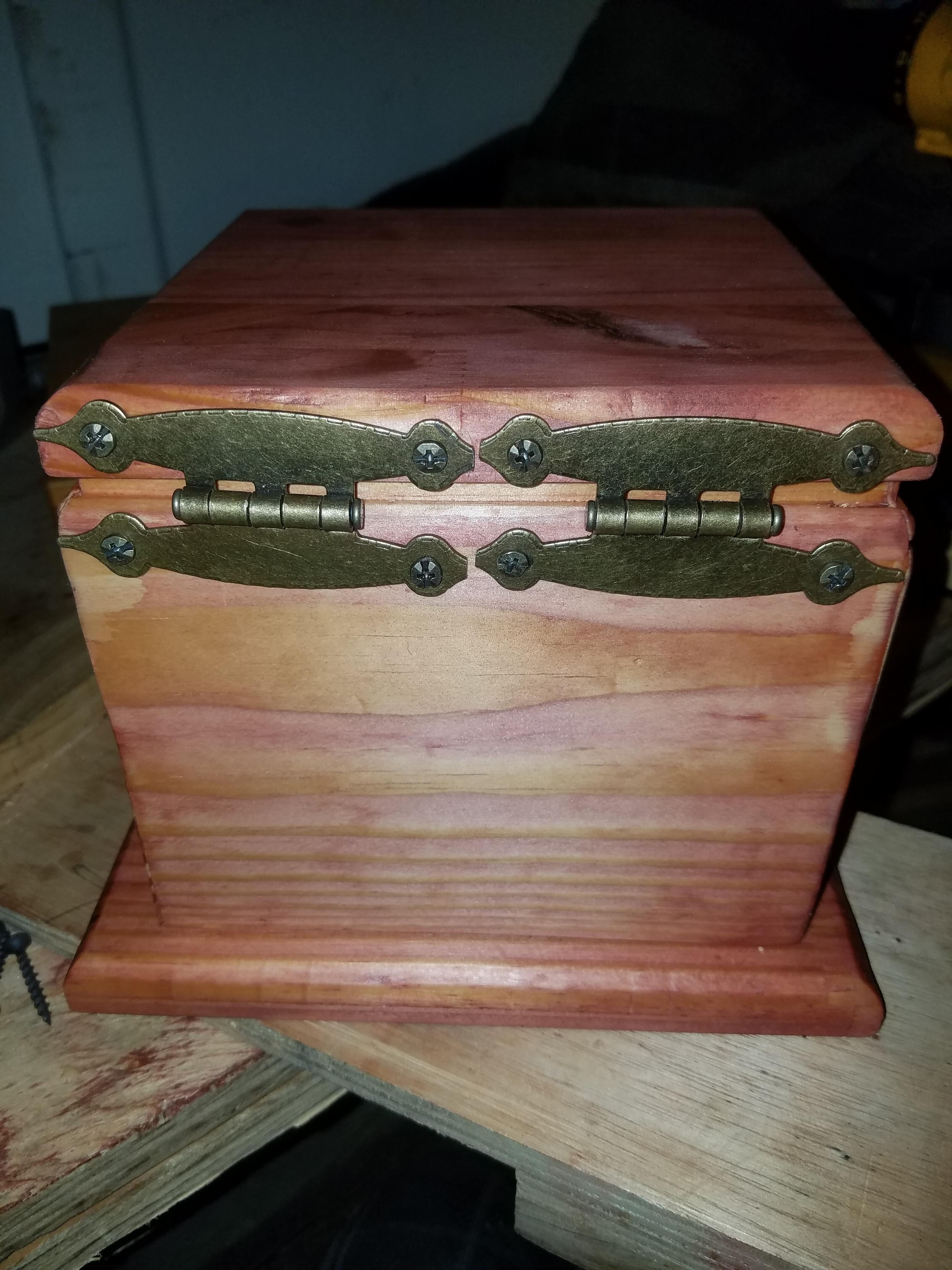

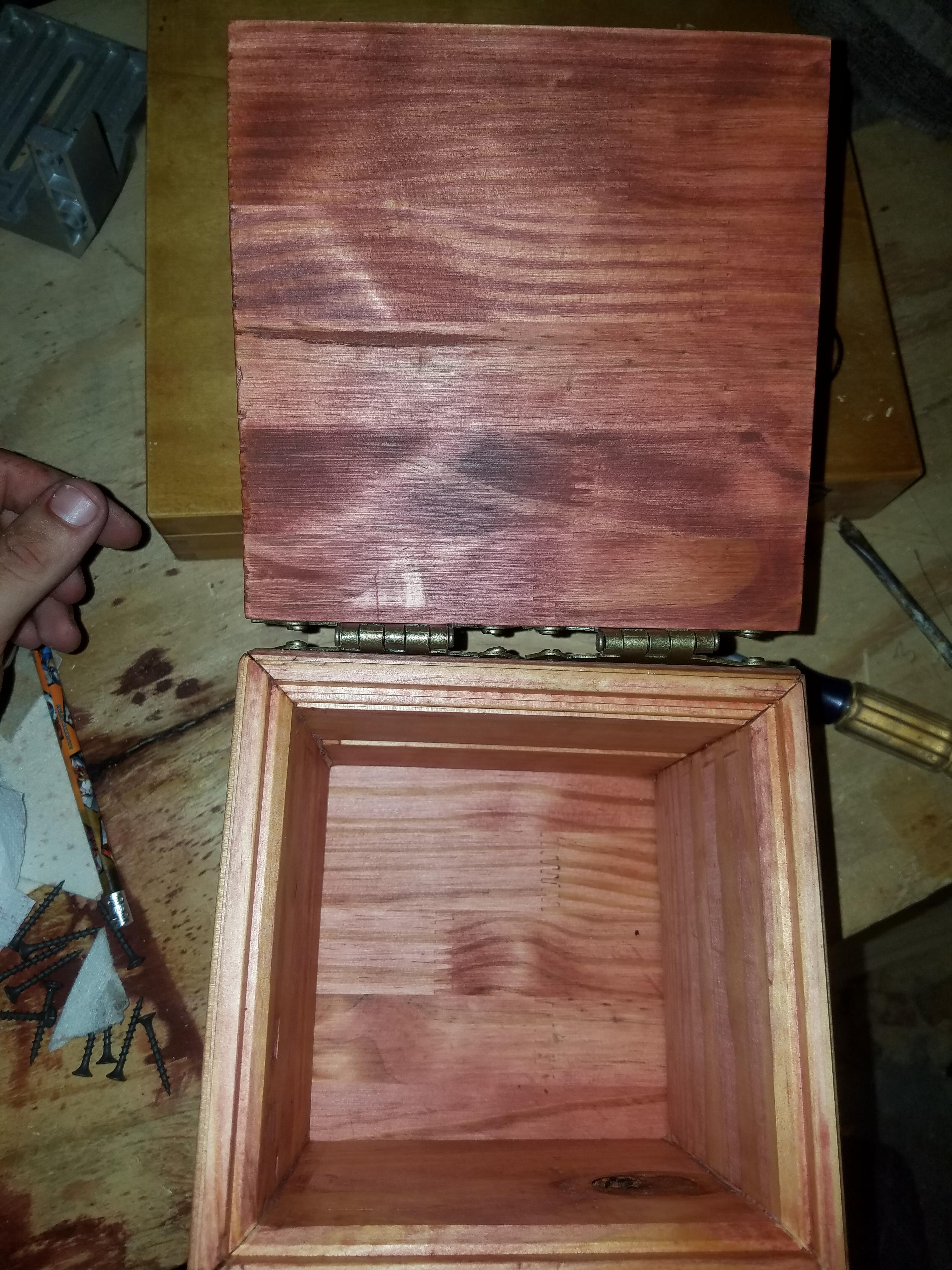

So everything with this was a first time for me. I need ALOT of practice lol. Im a perfectionist so i see every little flaw but pretty happy with how it turned out and first satin ive ever bought or done...........do you guys smell that????

Looks good.  Two hinges keeps a better alignment on the lid.

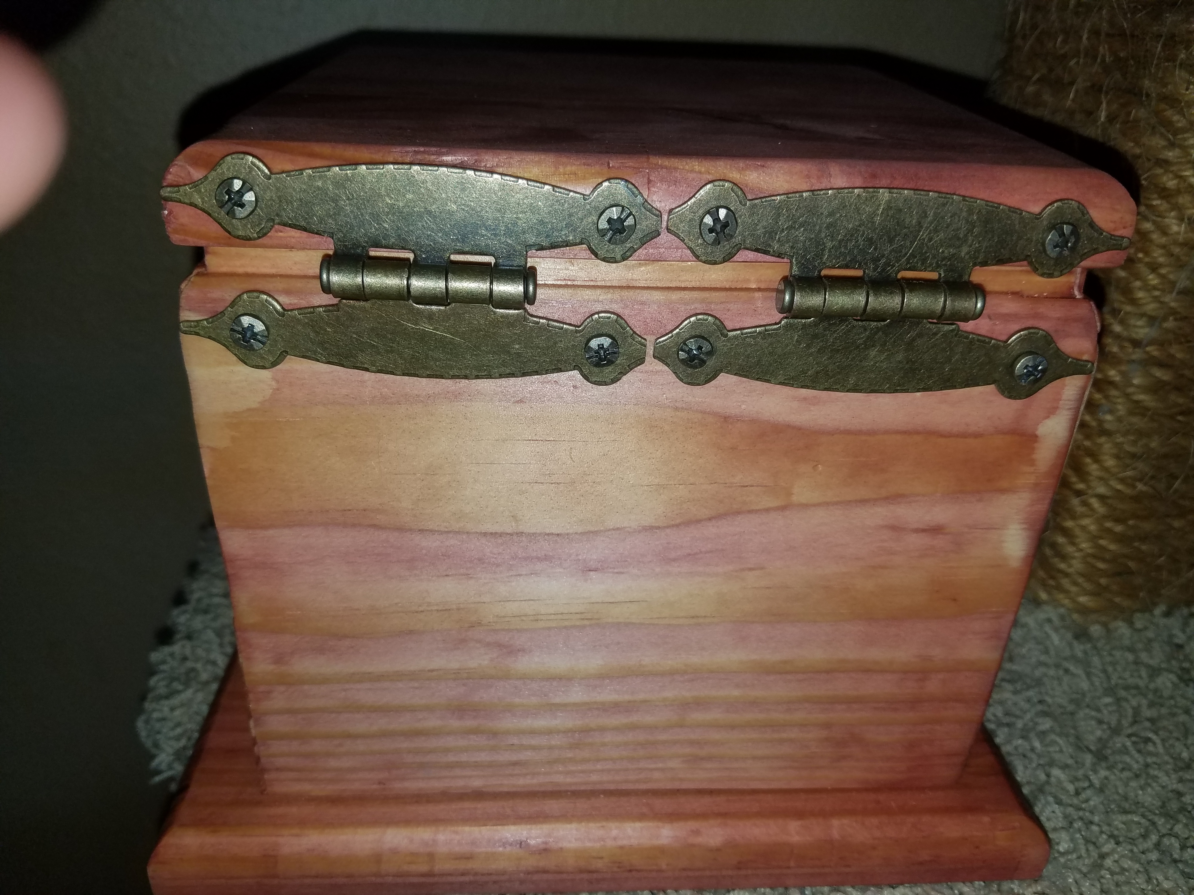

Lmao bug is my littlests nickname for ladybug. And fixed hinge thabkfully they are big decorative so hid the holes

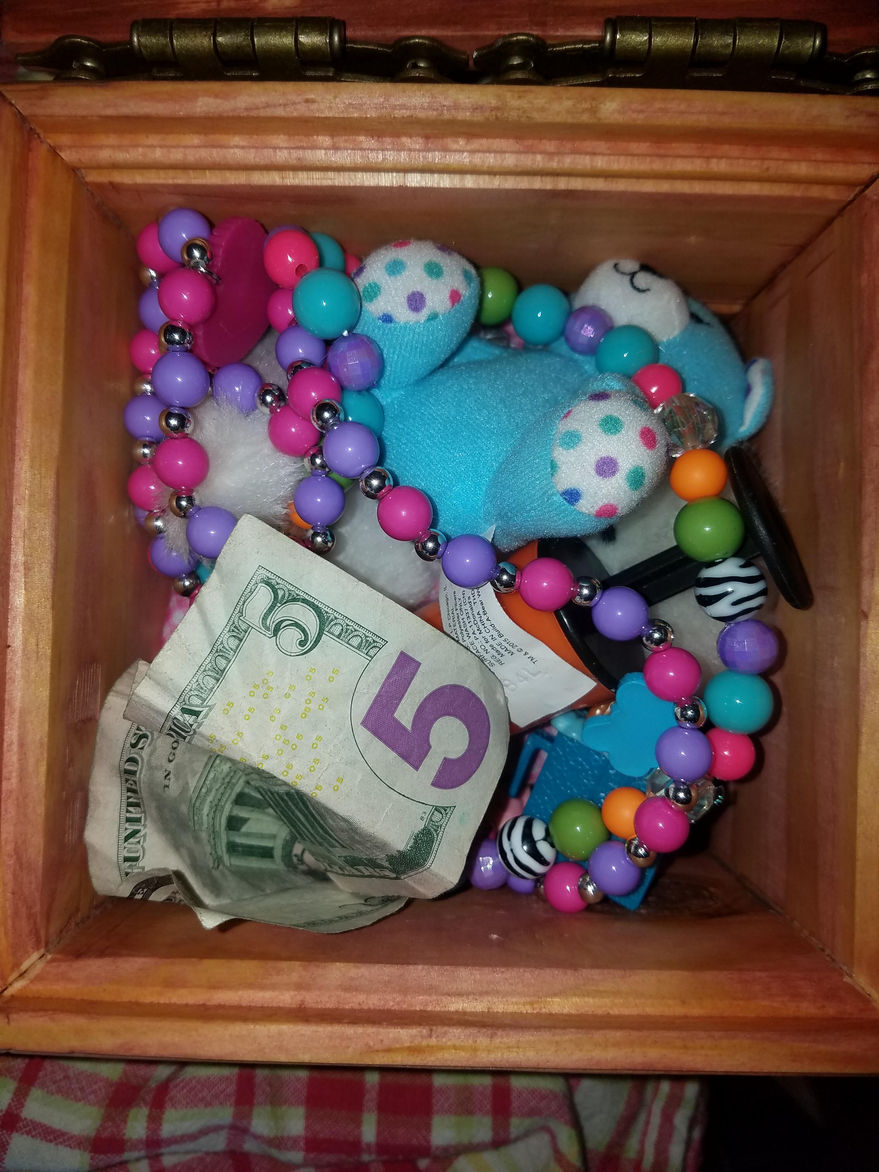

Well it was a hit! Huge smile and gasp! (She loves boxes and anything else she can squirrel away stuff. She did an about face ad  took off..... not 5 mins later it was full and playing out of it. So happy she likes it!

Thank you! Cant wait to start making more man glitter! Ava want wife to paint 2 small things on it. Best paint to use and seal wood with after?
Oh and dint see left hinge crooked untill after i posted it. Thankfully thier big decrotive hinges so it hit the holes lol
For painting, I'd put on a coat of sanding sealer (or shellac) first and then use an acrylic paint from the hobby center. Once it dries, then an application or two of clear poly or lacquer.
Like Lew said definitely seal coat with shellac is preferred. Then any finish you want to use. I made the mistake of using ploy directly on cedar box and within a few years the finish crackled. Apparently this is a fault of finishing cedar and why I do not like to use it along with the fact that the dust is problematic (protect yourself).

    By the way on the inside if you finish it only shellac as poly or varnish will offgas for a very long time.

Shellac works good for me too.
