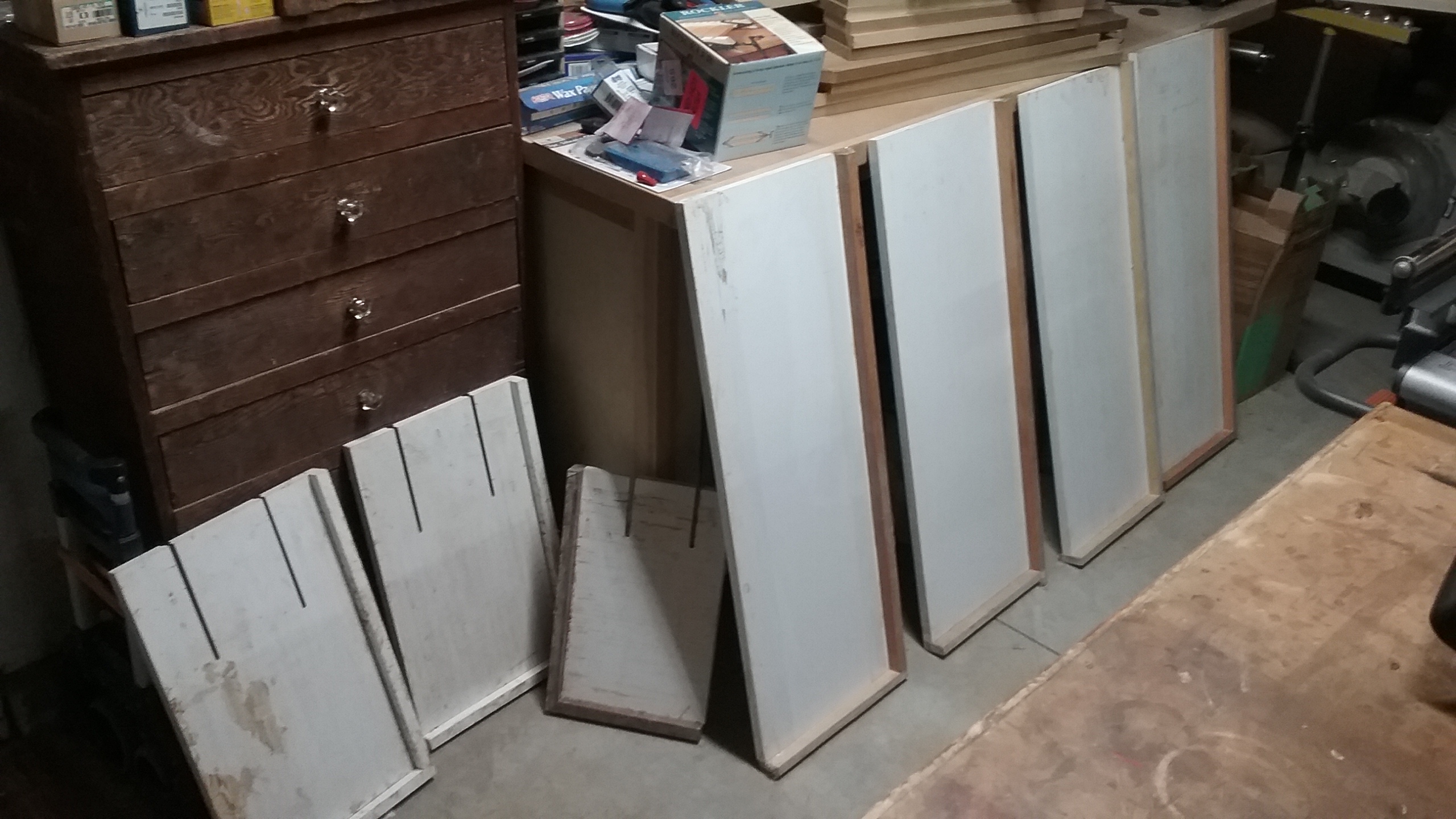

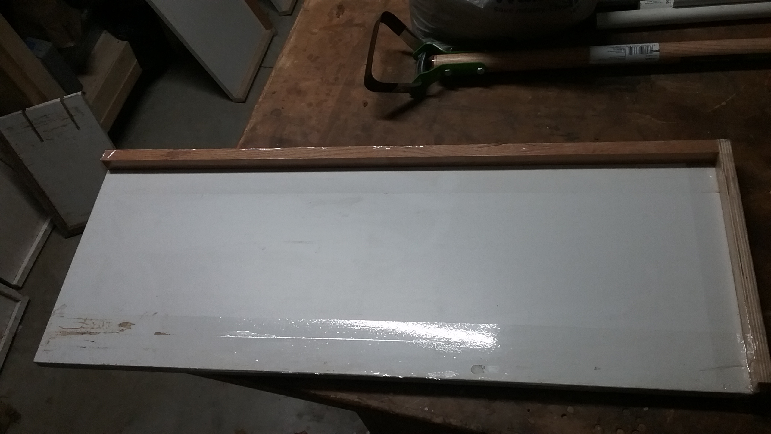

I have made a whole bunch of cutting boards over the years with different patterns and designs. After having issues with getting some bowing in some of the boards, I made up some gluing trays to keep things square and flat. I use melamine as it is resistant to glue residue and attach hardwood/plywood on 2 sides there is no movement when clamping. I use clear strapping tape on the edge pieces as glue does not stick to the tape. Even though the melamine is resistant to glue, I also put down some wax paper to make the clean up easier. The large trays I can get 2 large cutting boards out of them and 1 cutting board with the small trays.
Allen, that is how I do it too.
