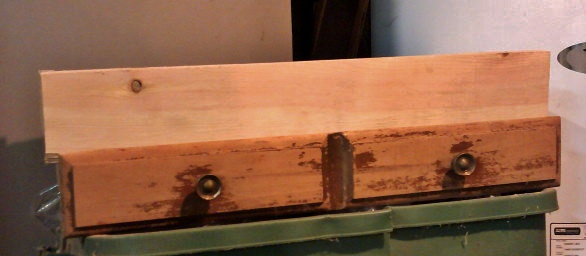

February 17, 20179 yr Author comment_98368 No top on this thing.....yet. However, a few other items were finished up. Drawer came out of the clamps, and the dovetails were cleaned up... Keep in mind, this drawer isn't even 3" deep. Got the drawers to fit into their places.. Face frames were a bit too snug, spokeshave and chisel opened things up. Speaking of "opening things up".. While trying to bandsaw that round-over on the end grain, the blade skipped out, and skipped into a finger. Barely "notched" the skin. I had better luck doing a large "Hollow" A few relief cuts helped out. The usual toys were brought out.. Hammer was already out. Marking gauge to cut a line around, saw to help out. Chisel to hog out the flats, spokeshave and plane to round things out Went to Lowes to buy two boards, to make a glued up top. Picked up some short screws, and two knobs.... Forgot about those top dovetails breaking out, will add a molding across the front. False front on the new drawer is screwed and glued in place to the drawer box. A pair of knobs were added, to match the knobs above them...almost. Might just paint all four. Loaded up the bottom drawer. Drawer will need a kicker added, next time I drag this mess out.... And the top drawer. Getting close to being done, I hope. Report
