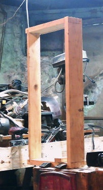

Ok, after a break from the action down in the shop, snuck back down to do a wee bit more.....
Getting the long stiles grooved was easy, just hold them between dogs.    The short rails were a different matter.  In order to get the plane to work like this....
I had to add a couple blocks, one for the vise to tighten with.   I had to notch the jig's jaws a bit, to allow the 45's fence to go by.   A few taps with a hammer to set things into line.
Groove is offset a bit, to the outside.  The square is to double check the depth stops..
Close enough.  Two of these get a single groove, another gets a groove on each edge.  Once I had these grooves done, I could cut a few tenons, and try things for size, as I needed to cut some plywood panels to fit..
Something like this.   Then some clamps and glue, and a few nails..
Then set this mess aside..
As I needed to get these done, while the 45 was set up.   Instead of 1/2" deep, I changed back to 3/8" deep.  Again, the long front piece was easy to do, it was these short ones that were "fun"
Got the sides and the front grooved for a plywood bottom, but needed a dado in the back..
Changed the cutter to match the thickness of the back.   More jig work.  Then a test fit..
Back is about 1/2" thick ( more room in the drawer that way) Got the other side done, and put things together..
So I could cut a plywood panel for it.  Panel is cut, and will need a bit of fine tuning.   Might be up for glue, tomorrow?
The reason for them long legs?   They have to fit over the bench's stretcher.    maybe tomorrow, I can have the other side into the clamps, and start on the web frames for the two drawers to slide on?    Might see about copying the front of the older drawer?  Maybe a back installed?   and work on the top?....Much to do, little time to do it....stay tuned...
