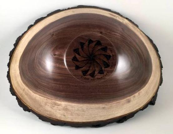

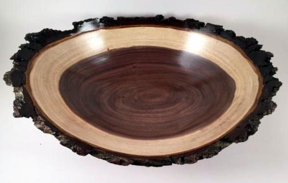

Turned natural edge again. I've got probably 20 or 25 of these in process, so, fair warning. :) This one is just over 12" long by about 9" wide and 4" deep. Walnut just really lends itself to this style of bowl I think. The grain is pretty  but not spectacular so I put a little wood burning on the bottom.
Thanks for looking
Steve

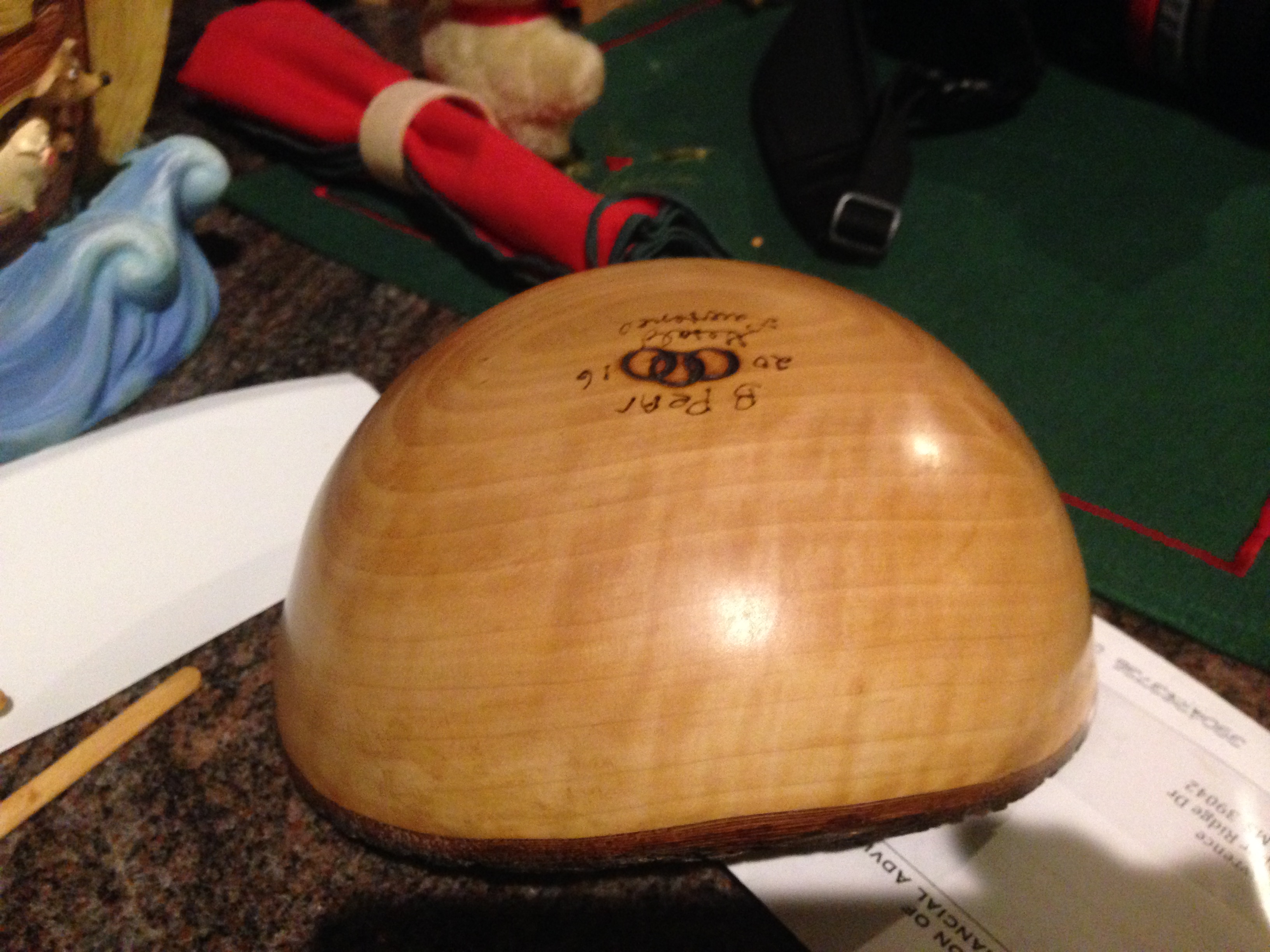

Love the walnut. I notice you put a foot on yours, I have been doing some (not 20 by any means ) and using a calabash bottom. We had a demo at the club with 3 lathes and I did NE. One of the other turners picked it up (he is really good) reversed it on the chuck and did a calabash style bottom. I really liked it and have been doing several. For delacate things like NE it means not much will be put in it. Still working on a cherry one and did 3 in bradford pear cannot find the pic.
Steve I have started doing all my NE all the way in one turning also. With the NE you cannot really tell about a warp
18 minutes ago, lew said:
Are you using a fully rounded bottom?
I wonder that too, I know what a calabash form is but not sure how to apply that to a bottom? Enlighten us, please
Steve
Yes the bottom is fully rounded. To do this leave the bottom just a little thick and when reversed the tenon will wind up with about half or less of the thickness still on the bowl. Then you round the shape ,with tailstock pulled up,and blend the bowl into a round bottom. This will give you a rounded bottom with no flat and will discourage heavy loading of the bowl. It takes a little finess to get the shoulder of the tenon removed but it just takes time and an easy touch.
A picture is worth a thousand words

Nice~!!  How do you keep the  bark on Cyanoacrylate?
If you're talking about the walnut bowl, yes.
Steve
I usually only apply CA if the bark is loose.
