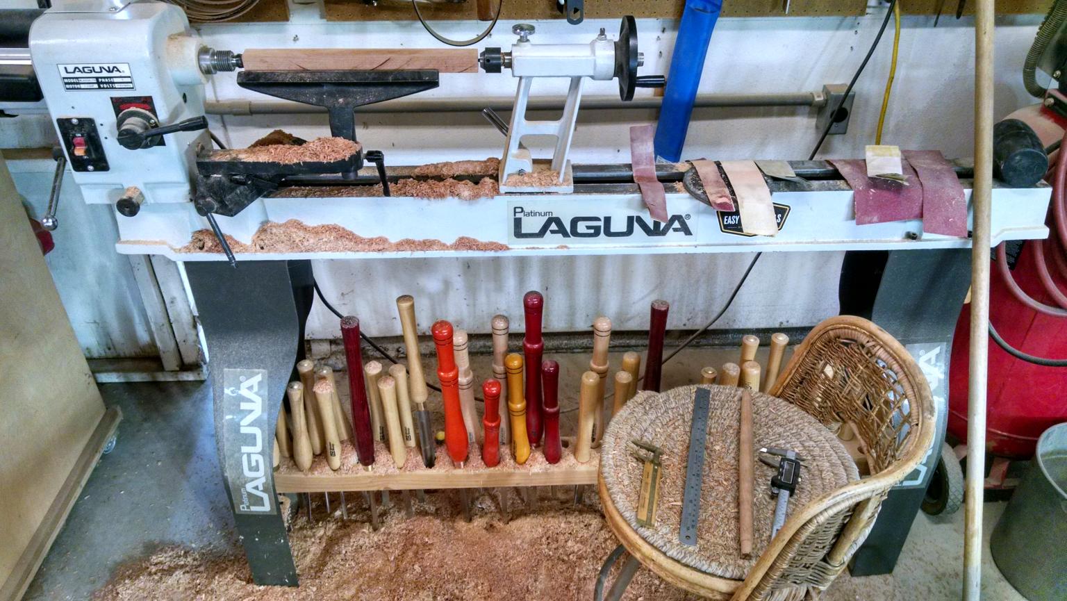

I got tools sitting on a chair, I figured perhaps I should have a work table nearby?

John I use underlathe drawers and rolling drawer units for storage.

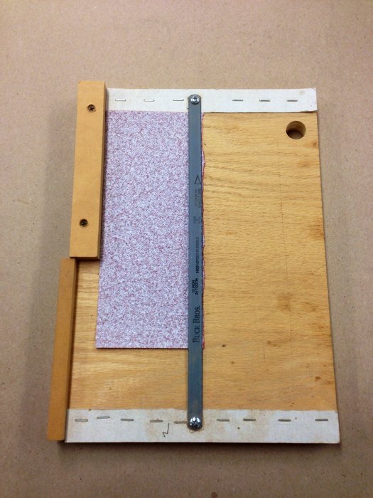

I use Mirka base cut paper for hand sanding, sheets. Like Gerald I cut into smaller pieces, in my case I get 12 pieces from a sheet. Do you have a sandpaper cutter? Simplest thing in the world to make
sand paper cutter.jpgA worn out hack saw blade and a piece of scrap plywood. FYI, the smooth side of the blade cuts the paper better than the toothed side. This one isn't mine, mine is much more crude. For calipers, again, like Gerald, I have dozens, different types for different situations. For spindle work a cheap pair of verniers(or three) will work just fine. Grind the points off so they don't dig into the wood and grab. I do have a tool rack for my lathe tools but when I'm turning, more often than not they are on the lathe bed. For chucks, face plates, centers,etc etc I have rolling mechanics cabinets.

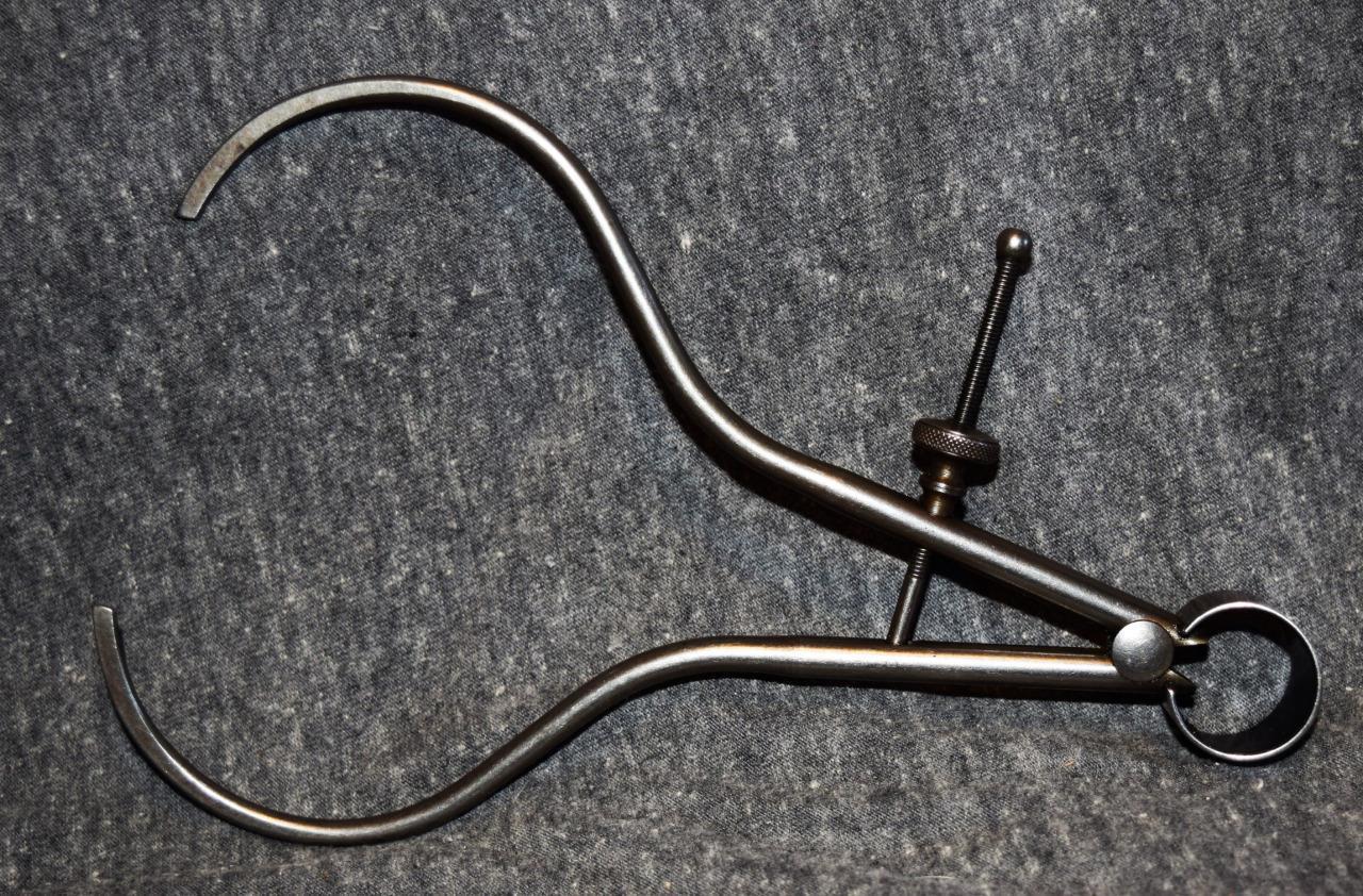

As far as calipers go, if I just get a half dozen of thesehttp://www.grizzly.com/products/Stainless-Steel-Outside-Spring-Caliper-8-/G9275?utm_campaign=zPage&utm_source=grizzly.com  I'd be good to go, and I could keep them set for one use only. I'll be turning spindles for chairs and there about a half dozen common dimensions that I could use each one on. Sound reasonable?

Shoot, my button finger hit Buy Now, and it bought now! Got these just now off of Ebay for 12 bucks including shipping, nice American made 6" caliper.
