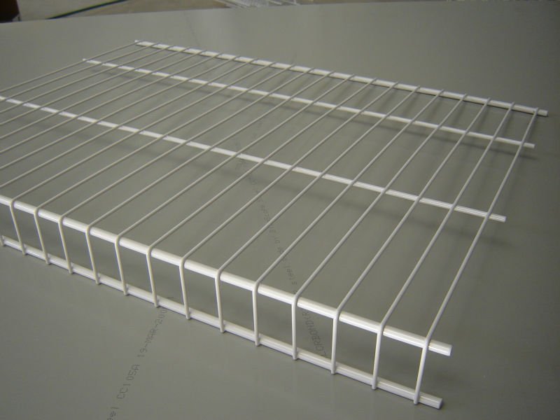

use a piece of this for your tooling rack mount up on the wall....
easy visual and it won't collect much in the lines of chips...
build it a frees standing rack...
put it on a compound arm and hook the arm to the lathe base or wall...
there are a lot of variations and sizes to choose from...
Stick, that's a wonderful idea, thanks so much, I actually have some of that hanging around, left over from a closet job.

Handy Dan built one... but I can't the picture of his...
this style works really well...
use the shelf upside down. set it at a slope (to or away from you) and lay the tool handles on the wide portion of the shelf...
slide the blades through the perpendicular bar...
8fb80b2a-d61f-4602-a6fc-bb4b3de49e88_400
Thanks a heap Stick, I love the concept and idea.

Here is the stand I made from Stick's idea.  I did add a locating block up at the blade end because the tools would fall over to the side for lack of support.  The bottom is the weight from a discarded pole lamp.  I added legs to it also for more stability.

That is a shelf from a refrigerator and I used it as is.  I set it by the lathe and it holds the tools being used on the job at hand.
I've got closet shelving that should work well, same set up as yours.
