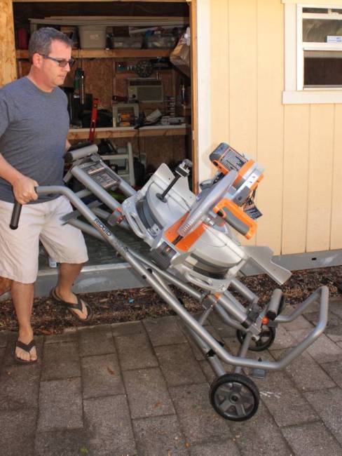

January 11, 20179 yr comment_92259 A lot of it is going to be based on how much room you have in your shop and if you will be using your miter saw in your shop only or if you would use it for off site for projects as well. My shop is a 3 car garage which I have to have my wife's car parked in it. So all of my big tools (table saw, router table, band saw, drill press, miter saw and work bench are all on mobile bases. I used to do a lot of off site work for church and when helping some friends with projects so portability was important for me. I had looked to make a miter saw station similar to the plans that you posted and chewed on it for awhile. But I decided to buy a Ridgid Miter Saw Stand and it was the best thing that I could have done. It gives 9' of support and is easy to move as needed as well as it folds down (with the miter saw attached or I could remove the saw in less than 15 seconds) and I can easily get it in and out of the bed of my truck and roll it where it needs to go. So just a little food for thought. Here is a link to the Ridgid site as well as 2 pics I pulled up.https://www.ridgid.com/us/en/ac9945-miter-saw-utility-vehicle# Report
January 11, 20179 yr comment_92342 @Allen Worsham, Where is the fun in that? I'm sure I can spend way too much and spend too much time making a mobile base by hand. Report
