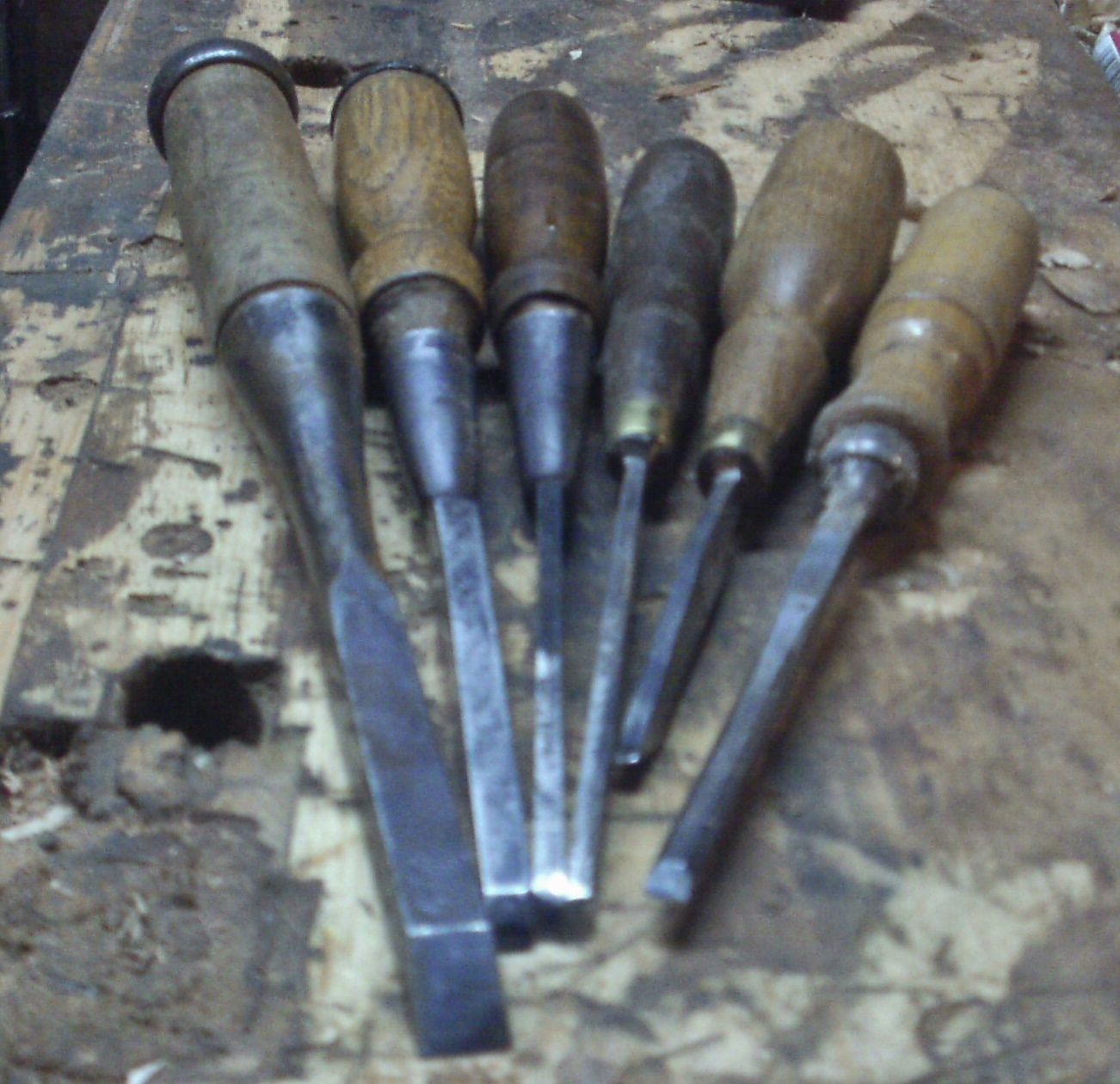

December 28, 20169 yr comment_89824 Ok guys, you have turned me into a junky. While I was waiting for a glue up to set I went scouring the garage for any chisels I might have and have abused. I found one and had to clean an sharpen it up. This time I did a 25* to 600 grit and then I did 30* and the back up to 2000 grit. I had some blue magic in the cabinet and gave'er a try. The bevel is shinier than the chrome on my motorcycle. I played around with it a bit an I am not too sure I like the 30* bevel. On the current project I used a straight 25* and I think I liked it better. Report
December 28, 20169 yr comment_89825 The 25 is more a paring type of chisel set up. For use with a mallet /hammer, the 30 holds up better. On the Mortise chisels I have, they are 30 to 35 degrees out on the end, then about halfway back they level off to 25 degrees. I can chop all day long with the 30 degree bevels, then clean things up with the 25 degree paring chisels...( confused yet?) These are all mortise and sash-mortise chisels. Meant for digging down into a mortise, powered by a mallet. Report
