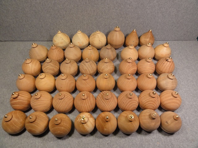

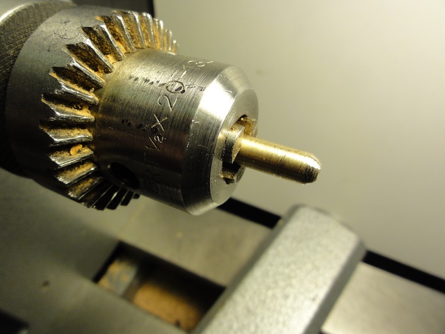

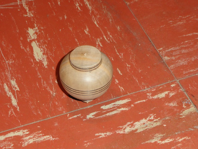

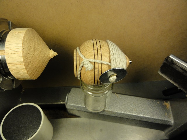

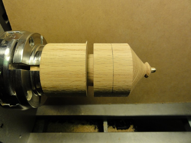

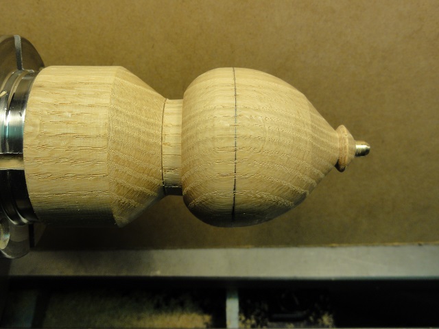

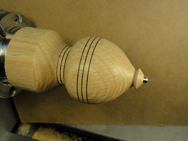

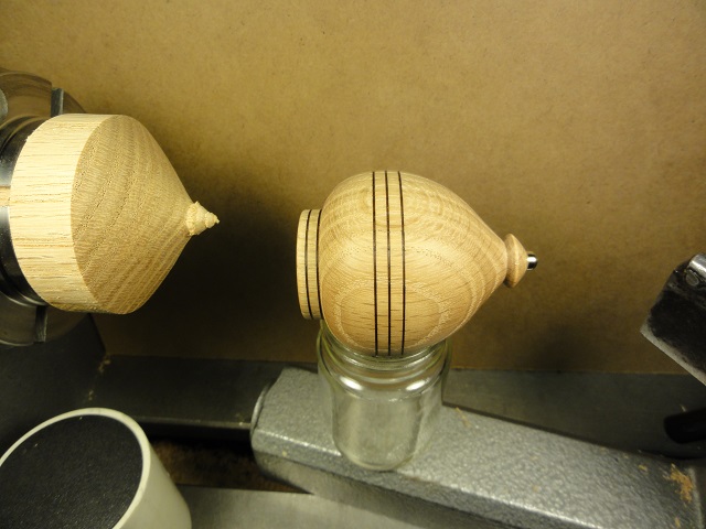

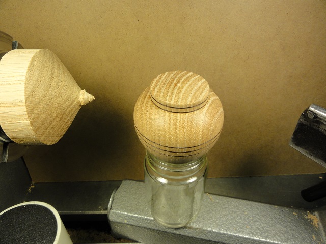

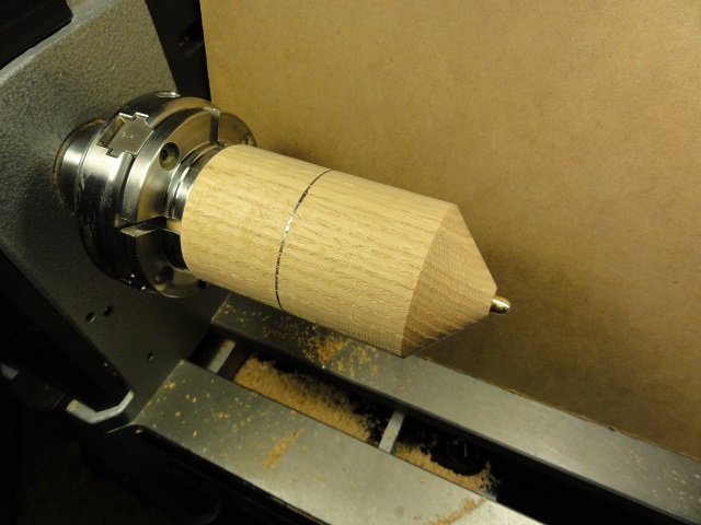

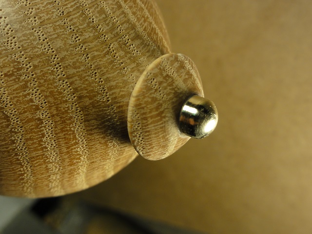

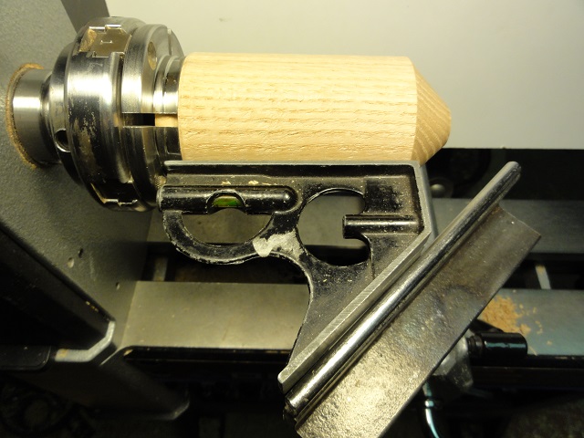

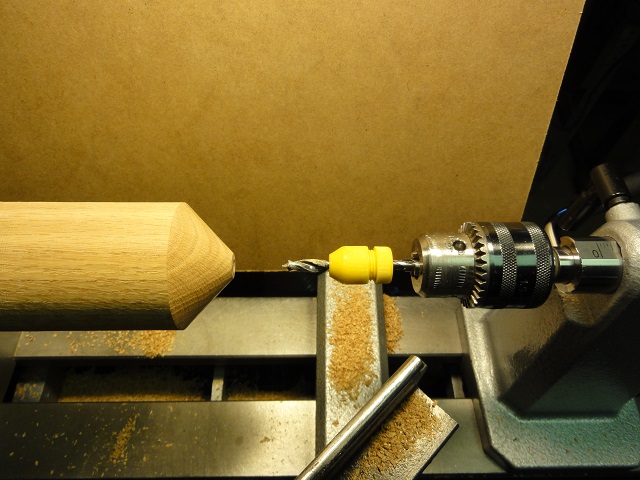

November 5, 201610 yr Popular Post comment_82810 When I decided to do string tops I did a search for information on how to turn one and more importantly the dimensions for them. Surprisingly there is very little information out there but our Charles Nichols gave me the best information on how to get started. After turning a few and experimenting with different dimensions and angles here is what I found works best for me. I start off with a blank 2.5" square by 5" inches long mounted between centers. I then turn it round and size an end to fit my chuck. I also hog off the other end to an approximate 45 degrees while the support is there. I get it mounted in the chuck and turn it true again and take it to a final diameter of 2.25 inches. I also set the banjo perpendicular to the ways and adjust the tool rest to 45 degrees which is the angle I find works best for the bottom. I then true up the bottom to the 45 degrees and prepare the end to drill for the tip. I started out by making tips on my metal lathe and found it was a waste of time. I don't know why but a sharp point on the tip makes it spin a while longer but the top will not stand straight up with it. I found that a ball shaped tip works best to get the top to stand straight up. So for the tip a 1" piece of .25" brass rod is all you need. So now is the time to drill a .25" hole .75" deep for the tip. I take the tips and put them in a drill chuck and roughly round them over. Now take the tip and glue it into the hole making sure it is firmly seated to the bottom of the hole and measure off the overall length of the top and mark off a line. Overall length is 2.75" for the wood body. Do not include the brass tip in this measurement. I leave the tool rest set to the 45 degree angle because it is now time to work the tip end again. Turn the end again to get a smooth transition to the tip and then work on the lower string catch turning away at the 45 degrees and stopping at the catch. At this same time go to your length line and make the upper string catch. Take the parting tool and make a .25" slot on the tip side of the line taking it down to a 1.375" diameter remaining. Measure and mark the middle of the remaining total diameter. Round it over from the center line. Sand it and add some burn lines or maybe some other visual decoration. Now is time to finish shaping the tip. If your hole wasn't exactly on center this step will cure that. I take a skew chisel laid horizontal on the tool rest to finish shaping the brass tip. I do it at sanding speed or a little less and shape the tip end round like a ball bearing. Sand it to 320 grit and polish it with fine steel wool. When done the tip will be perfectly centered. Take it nice and easy. If you get a catch it is possible for the whole top to go off center. BTDT. It is now time to part it off and take it for a spin. Report
