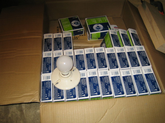

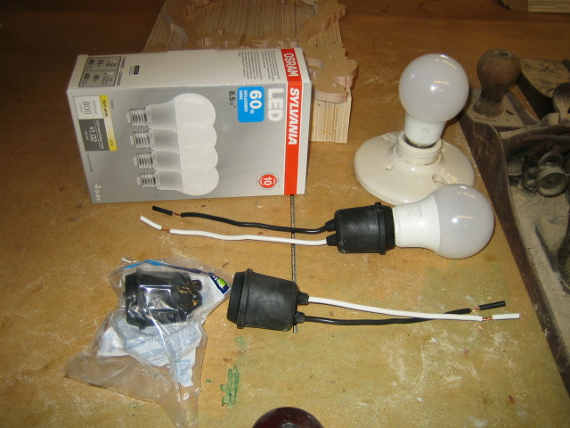

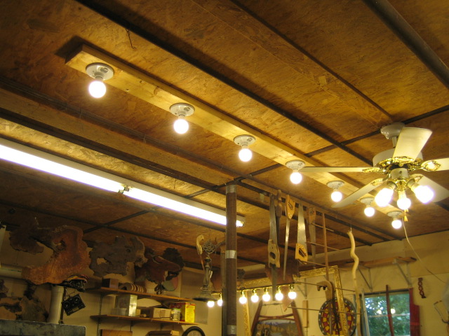

I've been getting the 60 watt equivalent led bulbs from Walmart and putting together a string to go here and there. The bulbs runs about 2.25 each at four at a time. Sometimes cheaper.
   The ceramic base is cheaper than the cheapest hang down type. I,m mounting both type on 2x4 and 2x6's. Just run a groove down the back side for the wires. I do have to drill a large hole for the ceramic wire hook up. Don't remember the size but about 2" or so.

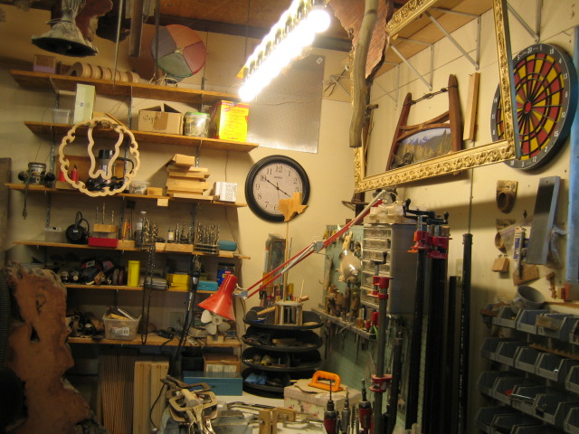

This second picture is in the welding area of the shop and it ain't ever had any good lighting. With the light
I have started finding things that have been lost for 15 years or more..
  You can get this brass set up from garage sales or habitat for humanity for 2 or 3 bucks less the bulbs. Lots of these being changed out in remodels.
  I think it says each bulb will cost about 2.25 a year to run but you can probably take that with a grain of salt, what ever that means.
