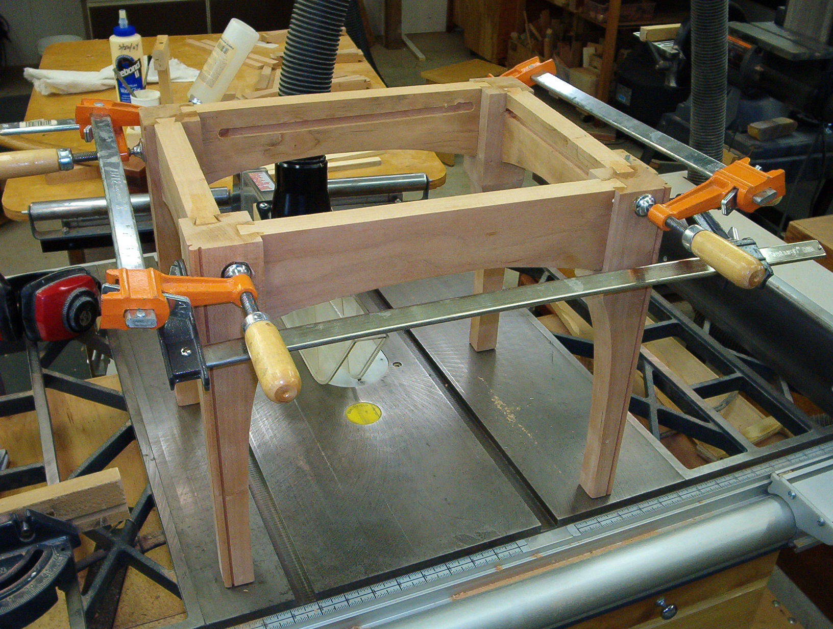

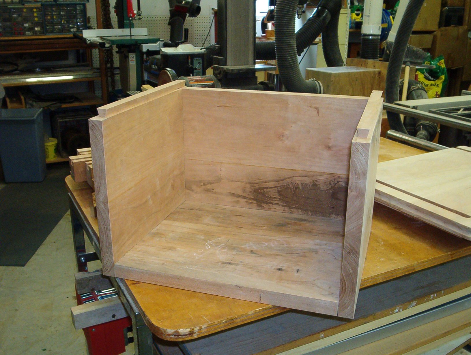

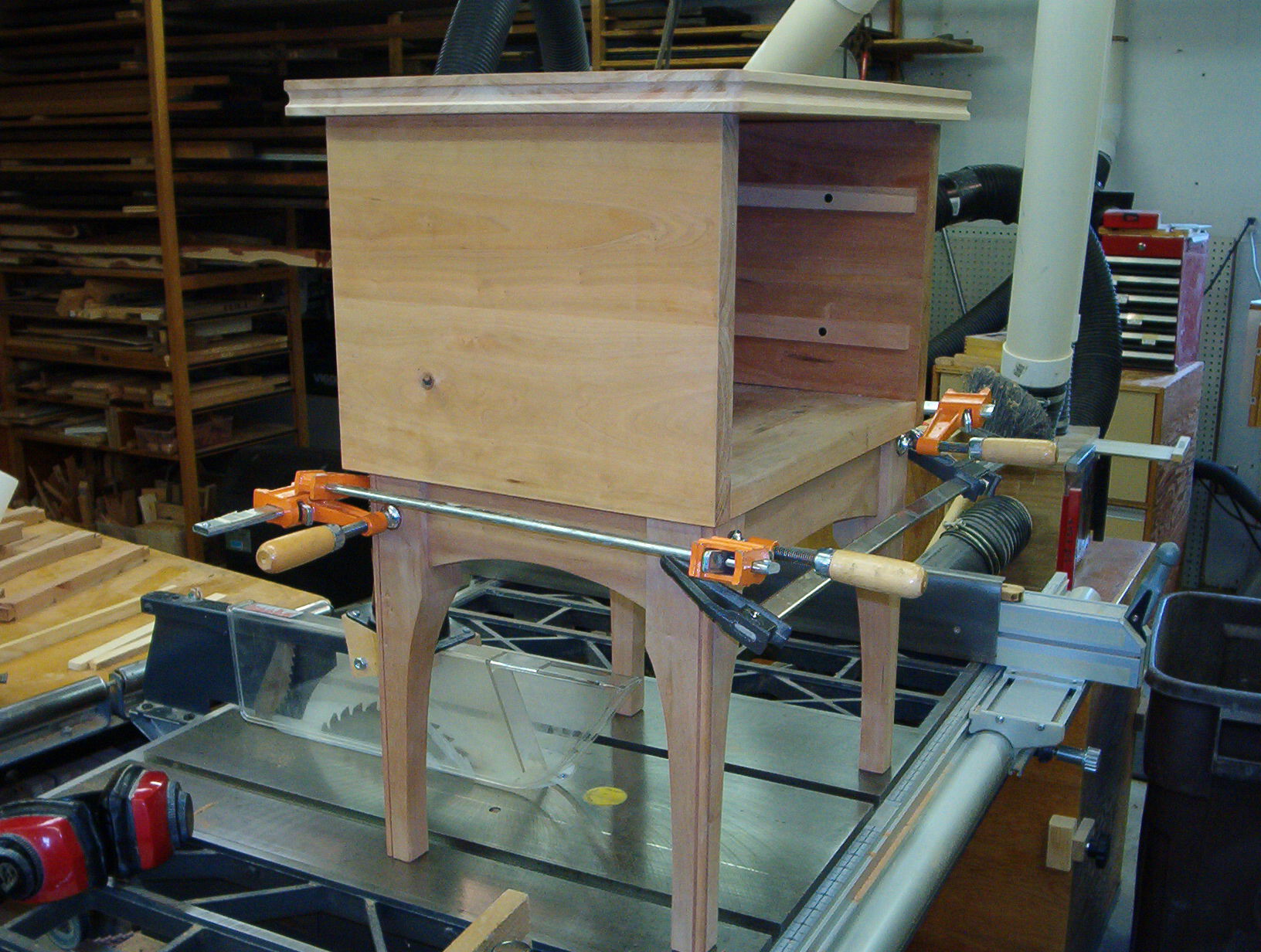

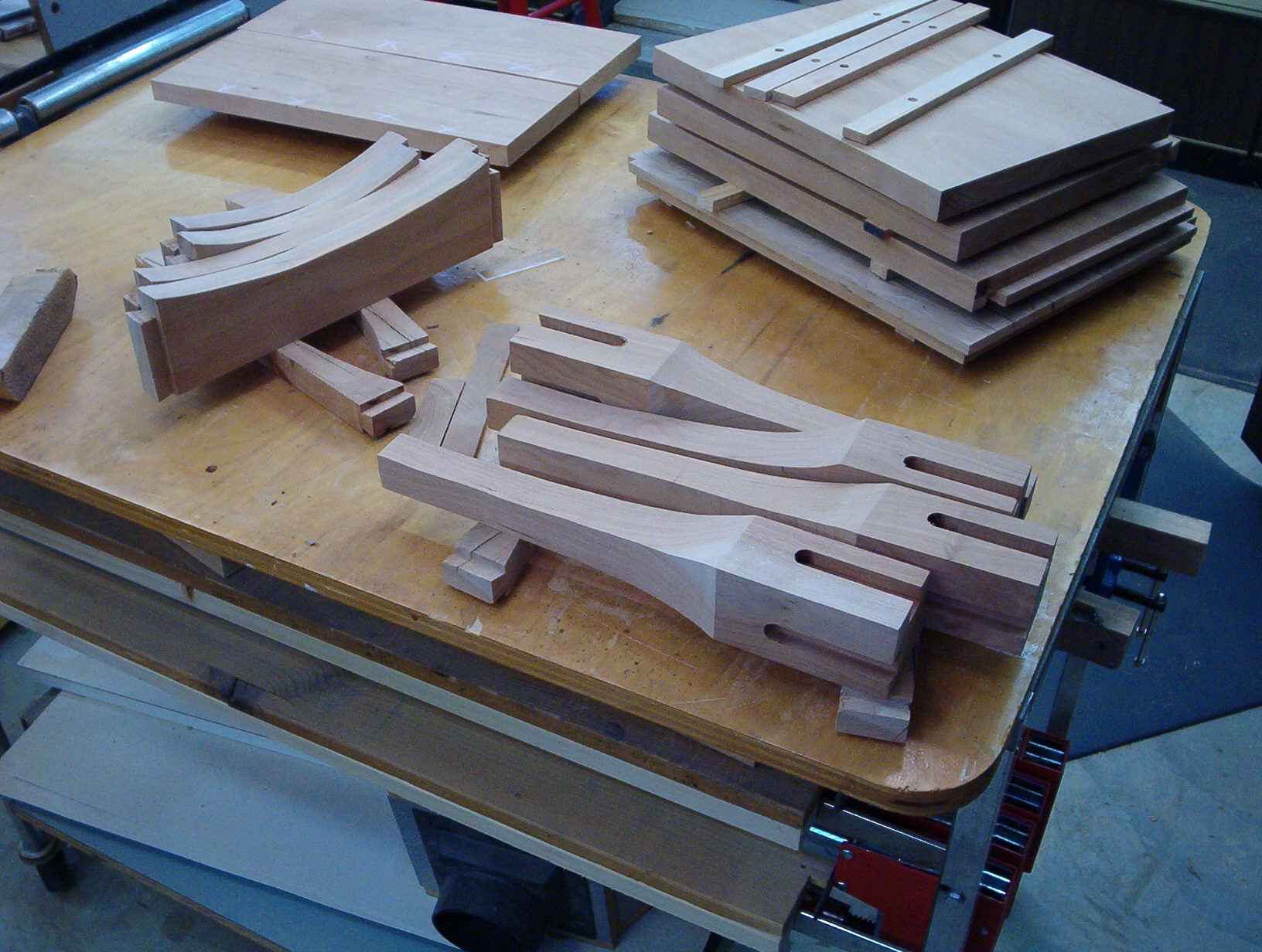

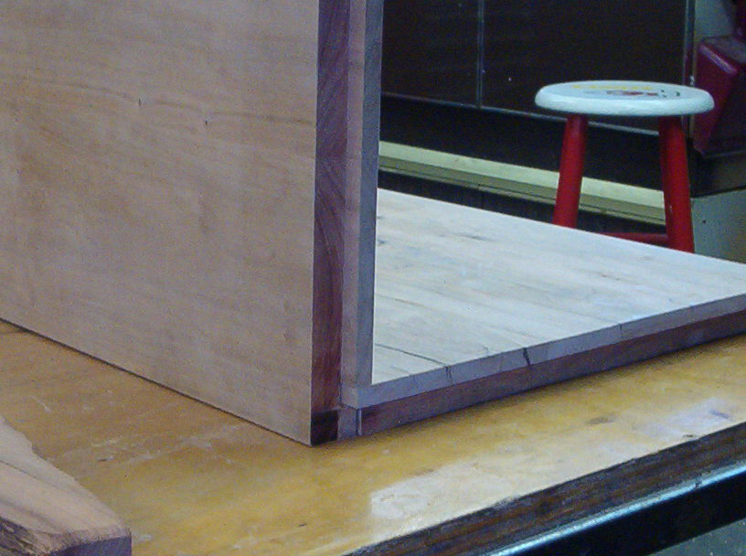

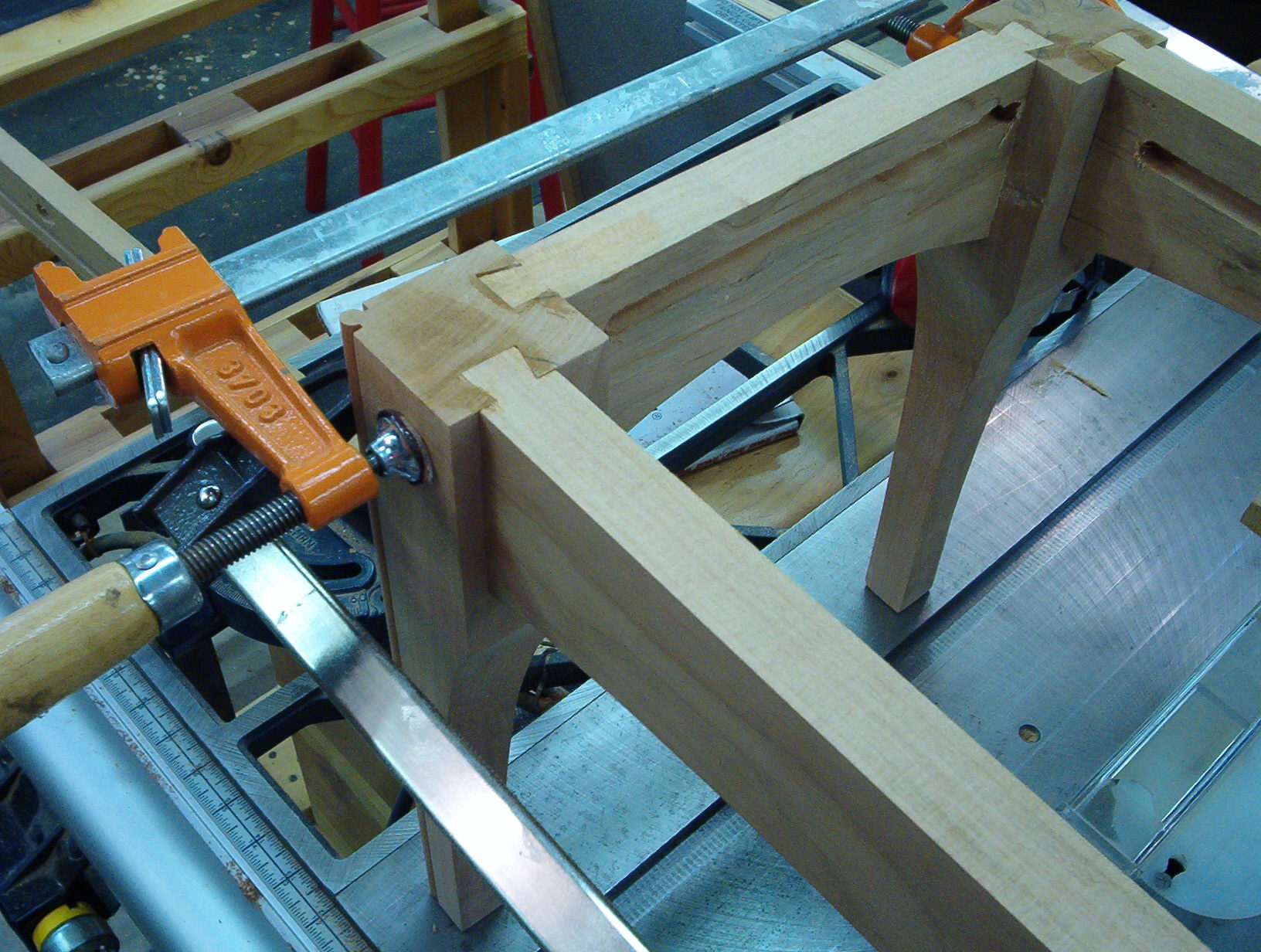

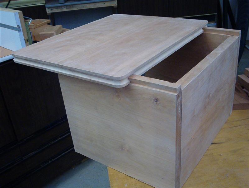

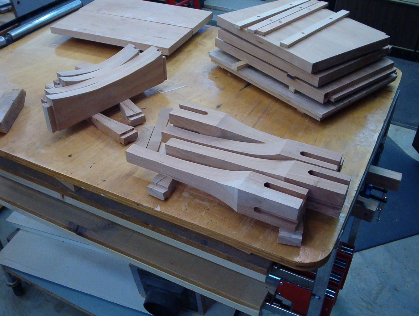

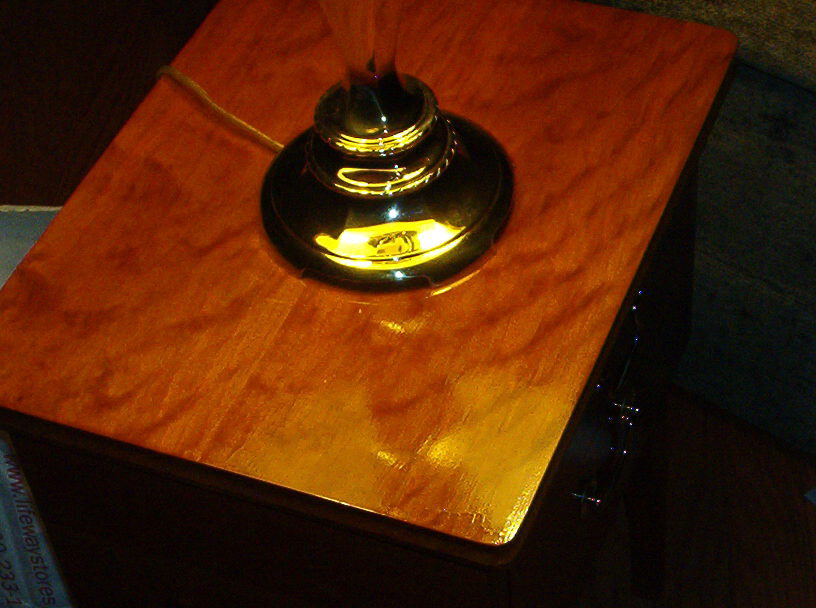

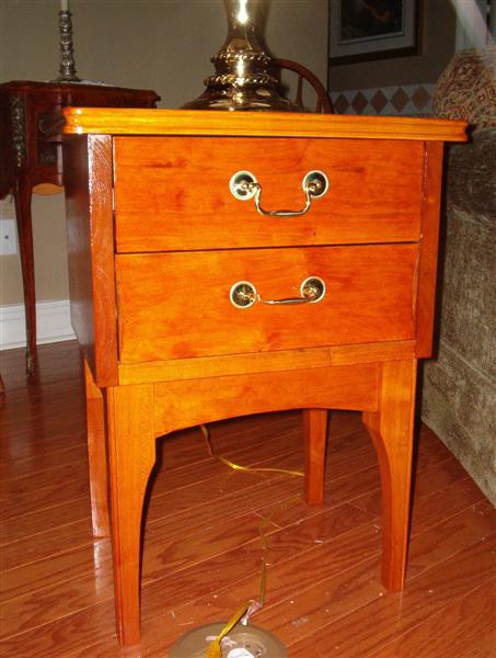

August 31, 201610 yr Popular Post comment_70961 This is a side table I did based on a shaving stand Norm did on NYW. I used sliding dovetails for the side and bottom and to put the top on . The drawers have my first try at handcut dovetails. The only screws in the piece are in the base to attach it to the drawer box and in the drawer runners. The top had a nice figure in it which I did not see till I applied the shellac. Also my first time to french polish with shellac. The garnet shellac (the only finish) will even out the color of cherry so even the sapwood will not look so bright. Edited August 31, 201610 yr by Gerald Report
August 31, 201610 yr comment_70974 Looking at these pictures a word comes to mind, "craftsmanship". Really nice project done really nicely! Thanks for sharing. Steve Report
August 31, 201610 yr comment_70977 Excellent work and great details. Just curious what wood was used, Pine? Report
August 31, 201610 yr comment_70978 That looks great. Nice layout and execution on each and every joint. Report
August 31, 201610 yr comment_70991 Great Job Gerald! Wonderful work and the PIP photos are great too. Report
August 31, 201610 yr comment_71105 Wow! now that is one nice piece of craftsmanship. Very well done. Report
September 1, 201610 yr Author comment_71313 Thanks for the comments. This is one piece I can say was truly a pleasure to build. Report
