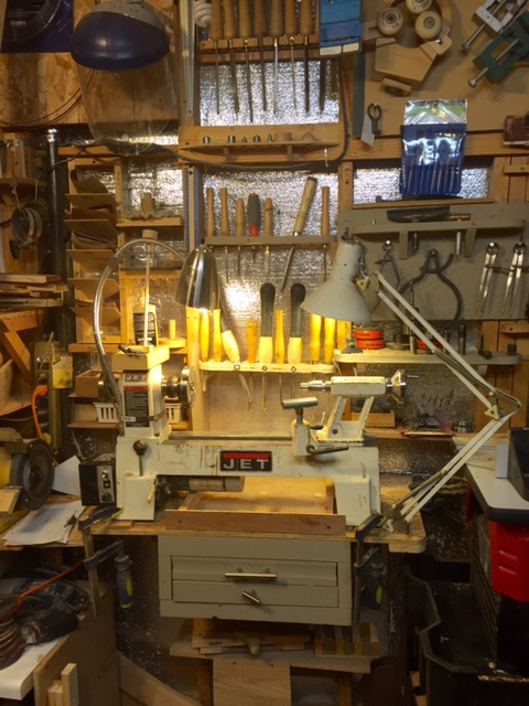

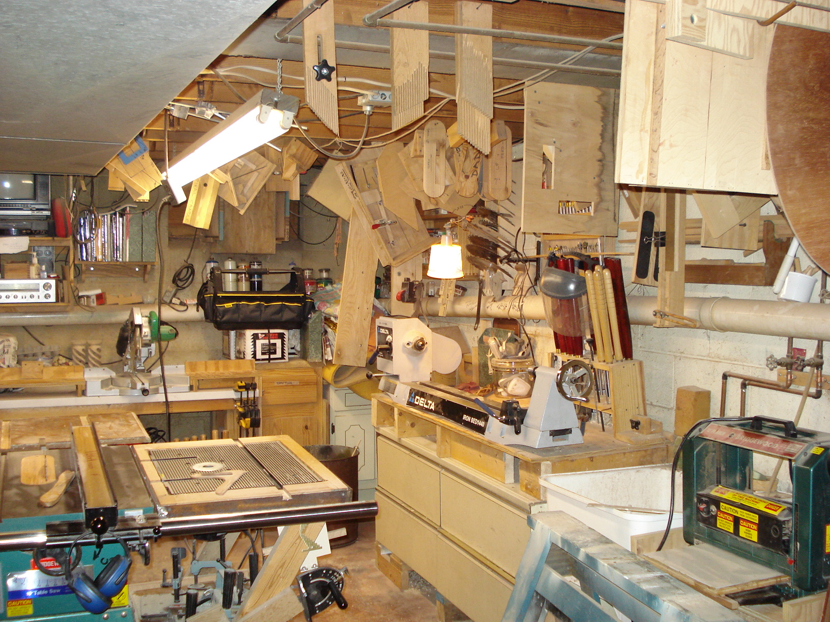

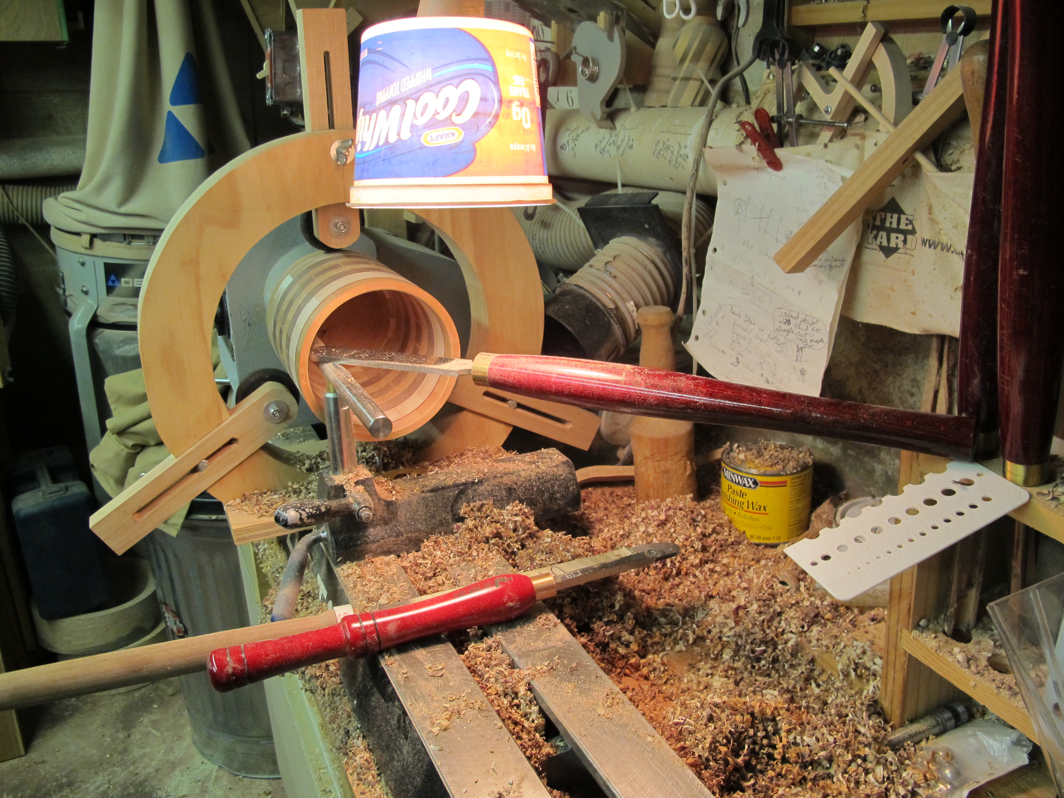

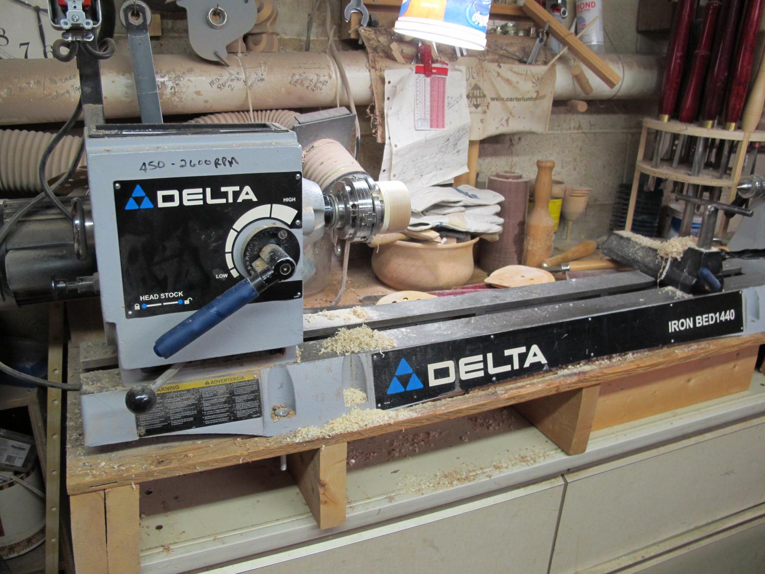

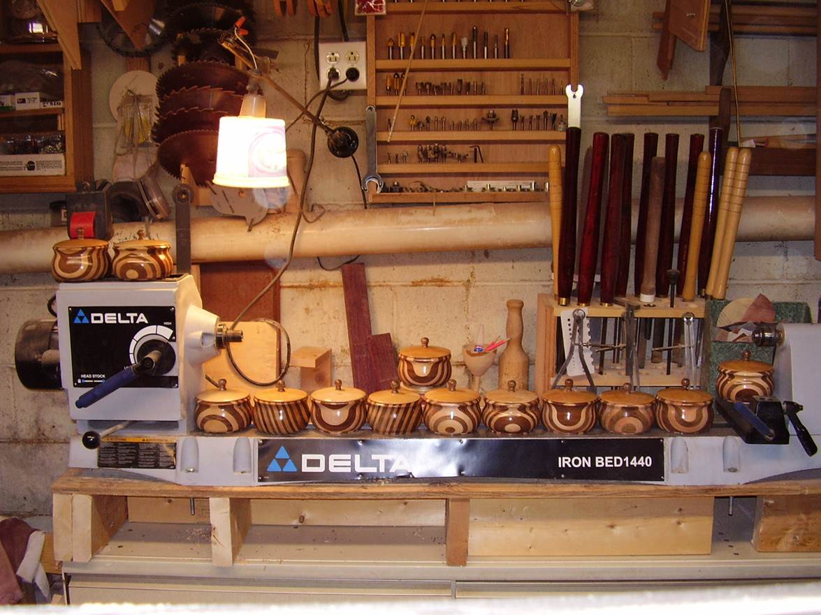

Here are a few I found. They are not in any chronological order. Please don't laugh at my lathe light. I'm gonna replace it with an LED one- someday.
This one show the location of the lathe and that it sets on a drawered cabinet.
There is only about 2 feet between the lathe and the saw.
A little better front view
This shows how chips can build up on a table top.

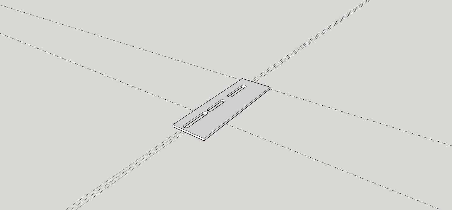

Lew thank you so much, beautiful work in the picture!! Nice shop also. As far as the wood chips if I made a table with a cut out behind the lathe would that be a good idea? That way they can fall thru it and off the front?mi mean not a huge one just long enough and such to be able to brush them out..
Hey Lew, I noticed your lathe stand is enclosed at the base cabinet, do you ever feel compelled to put one foot up on something as a rest, and cannot because of the enclosed base?
That would work. Maybe a series of slots
This is not to scale, just a quick picture. The separated slots would provide more integrity to the top
So far that hasn't been a problem. I move around so much when turning that having both feet on the floor is a help. The problem I do find is that I store most of the small lathe stuff in the drawers and when I start turning I forget to fully close the drawers. Even a partially opened drawer is a great chip catcher;)

Lissa I would consider creating a "U" shaped countertop to allow your shavings to fall through. Perhaps even adding a sloped chute to direct your shavings into a tote/bucket.
