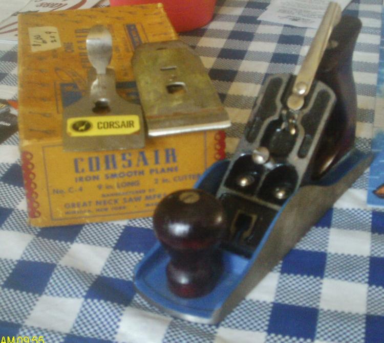

Found a place on Aldrin street.  Had a router set up for a shop.  Router tables, jigs, and a big box of bits.....$85?    Well, already have all of that, pass.  In the fron of the garage, a shaper with a cast iron top, and huge tray of cutters and jigs......$260?   Pass.   Got to looking around on the tables, picked up a box with two planes in it. Yep, two planes!
The box was what that blue Great Neck Corsair C-4 smooth plane was sold it.  The little blue object with it?
A Little Giant Razor Plane, the one that was an oval (egg?) shape?  Still has the Wilkinson blade in it!   Haven't figured out who made the two chisels ....yet.  This box was $6 plus two for the chisels....$8 total.  Not too bad a day.   Cheap.   Other than going to Menards, to buy the wrong sized bandsaw blade ( return for the correct one tomorrow) and lunch.   Not too bad a day...

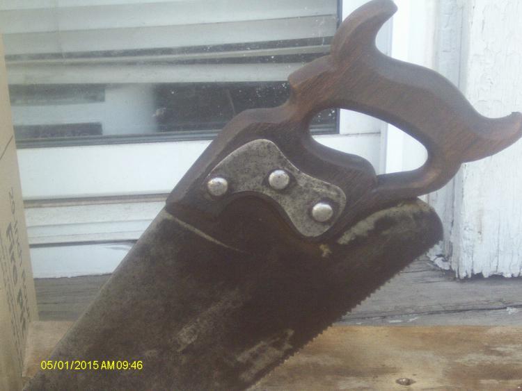

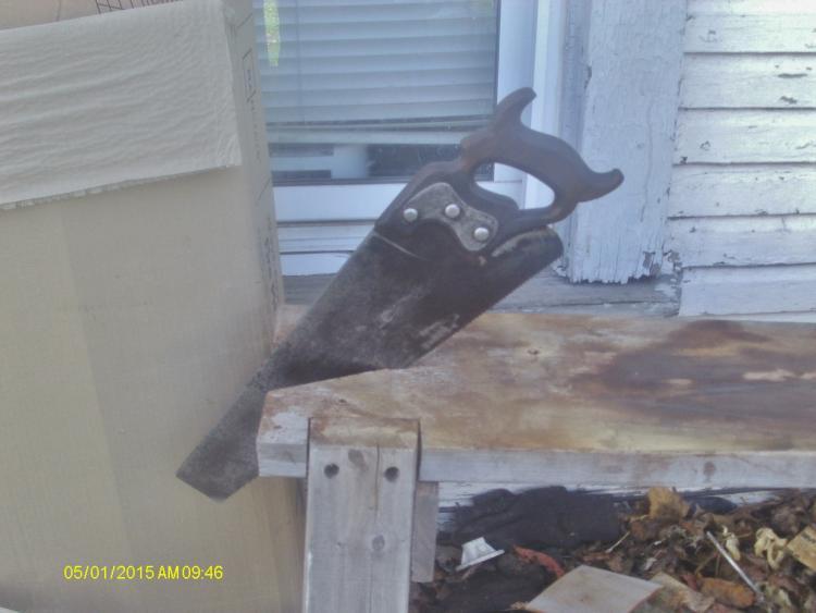

A small panel saw @ 8ppi with a steel plate riveted to the handle.   It even has an etch......Columbian Brand it says.

Took the Corsair apart.....yep, iron was installed upside down.  Happens a lot.  Will need a trip to the stones, and it just might make a shaving

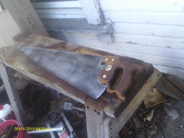

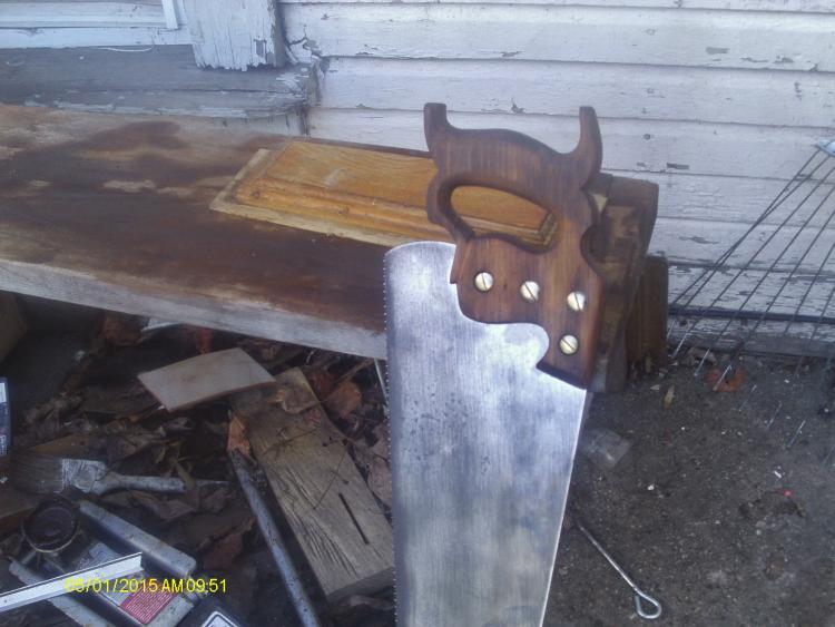

Two saws are now cleaned up and ready to go
The Disston D-7 10 ppi crosscut saw.  Brass is now shiny, and "clocked"post-3502-0-89844500-1430492610.jpg

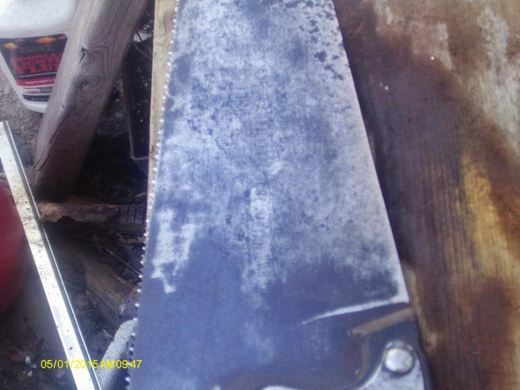

As for "Shorty"
plates are shined up. Found an etch, too
So far, not to bad for a quarter a piece?post-3502-0-19767900-1430492868.jpg

Seems the short saw with that metal plate was a "local" one.    Columbian Brand Saw Works of Indy, IN, made by Atkins.
As for the "D-7"?  Not really a "D" model.   A wee bit older model, call a No. 7  Lightweight Ship's Pattern saw.  Brass bolts are from that era, as is the medallion. Open top style handle, rather than the later "closed top" handle.  There is a FAINT etch showing up, now.    Can make out parts of the  Henry Disston and sons across the top of the keystone.    There is no "D" inside the Keystone logo.  So, this saw is from before 1928.   Maybe right after WWI?
Have the Corsair all cleaned up.  Sole was actually flat.   Iron is now flat, and sharp.   Chipbreaker needed a bit of work, to mate up with the iron.   Everything is tight, no looseness, no backlash.  Handles are even a hardwood....ooooh, aaahh.

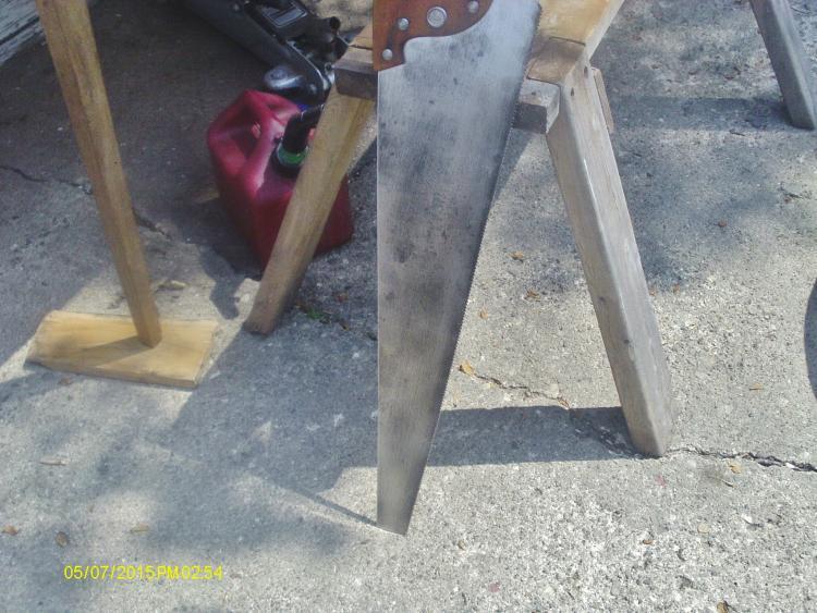

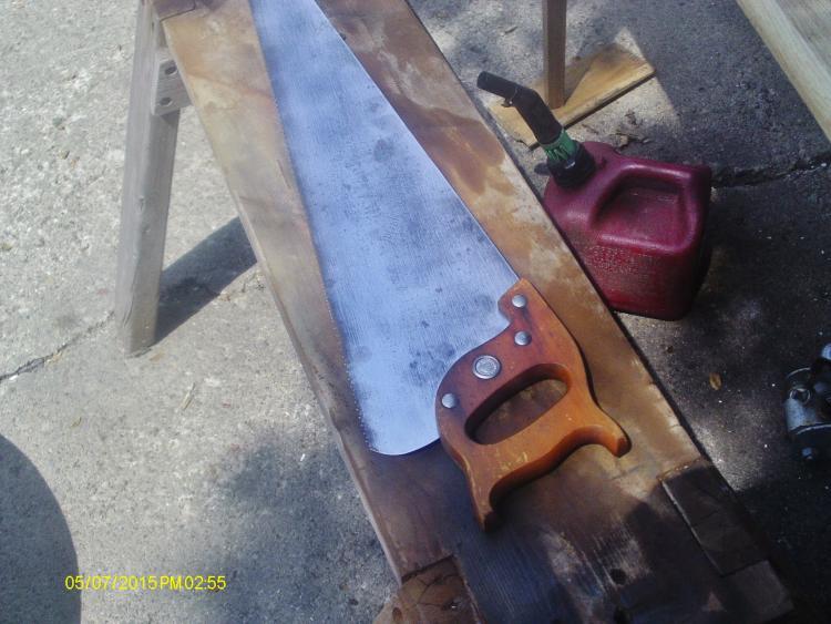

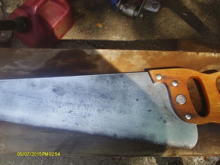

The third good saw out of that bundle has been cleaned up.   Rather spiffy now.   Took a sander to the saw's plate.   Took a wire wheel in the drill press to the bolts.   This is what came out of maybe a 1/2 hour's work...
There is a readable etch going on there..
Seems this saw was made for the "National Hardware Show" in 1954.    This is Henry Disston's National Hardware Special.   At least that is what the etch says.  Cleaned up nicely, though
If I were to keep it around, though, I would need to sharpen it up, just a hair on the dull side of things.
Three saws for $2?   That works out to be .....$0.66 each?   Still might clean the Great Neck Tool Box saw up, just to see what it does look like.   May have to refinish the TB saw's handle.  A little weather beaten...
BTW:  now I have TWO of those Disston  National Hardware Specials in the shop.  Wonder what to do with them.....
