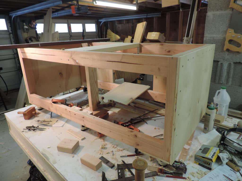

The project is a pedestal for a front loading washer dryer
It's made from  mortised 2-by material.
Shelled in with half inch birch.
Will be filled and  painted to match the appliances. nothing fancy
Rise height 24" or thereabouts  (emphasis on the thereabouts)
The wheels in the rear  are swivel type the ones  in the front are Great Lakes Casters that pick the wheel up off the floor when I rotate a little star-wheel in the caster in order to lock them  Three in front three in the back.

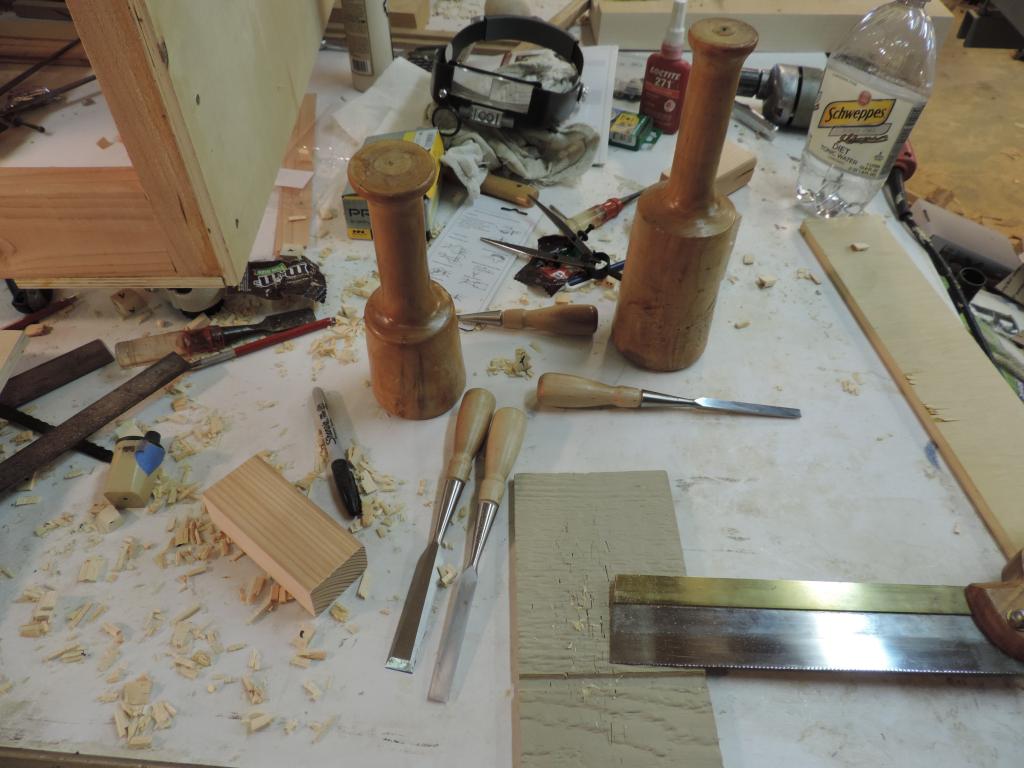

I used my hand made DT saws.  Note one is brass backed the other  still has the back that came it from the BORG when it was a sheet rock mud scraper.  I got lazy.  Both are 24 TPI.   Getting the "hang" for the handle was a bit of a trick as I didn't even know about "hang" when I started.  I made the saws mounted handles and  when I started a cut they just stuck solid like they were nailed to the wood.  The handle's angle and location is important.

Some tools
My two DT saws

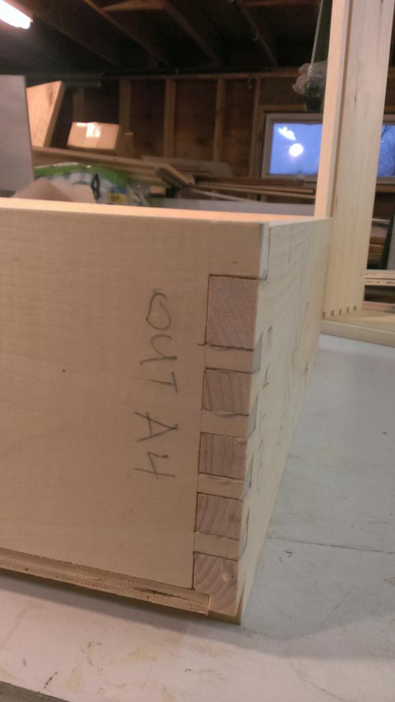

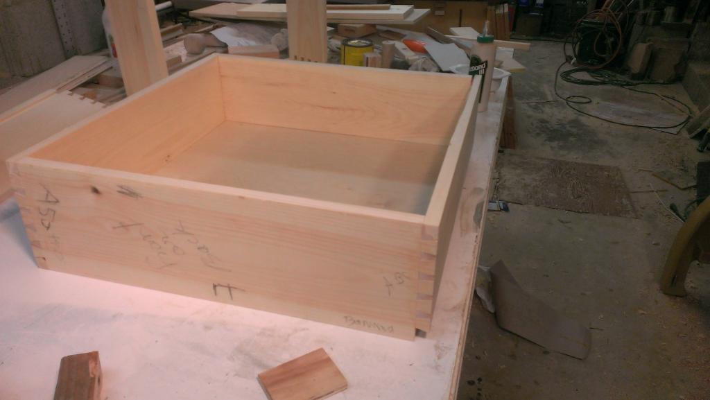

The first Drawer all glued up with the bottom ( half inch Birch)

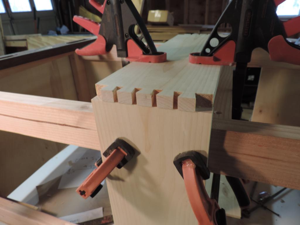

I haven't built a moxxon vice so I just used the project to hold the drawer sides.

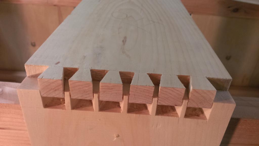

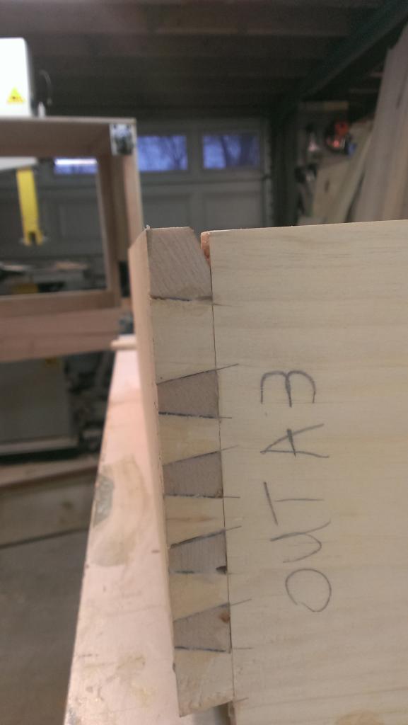

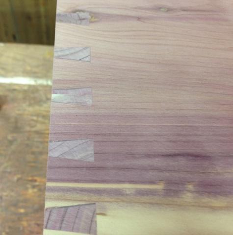

Marking out the pins or are they tails - - it gets so Konfoozin

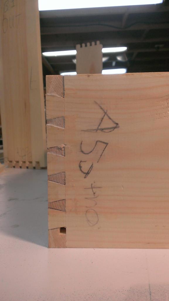

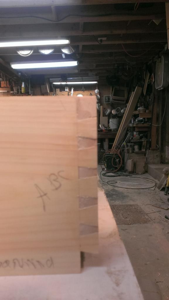

Ohh look~!!  they might just fit.
Fitment detail to follow

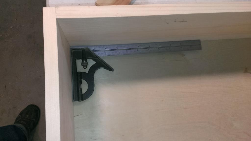

And the thing is square too

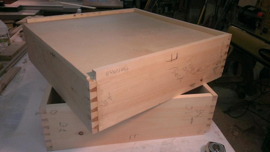

both drawers
Pretty dang good for your first attempt!! I am also a fan of "tails first".
Nice  shop made saws. Did you file the teeth by hand?
I always had trouble making straight cuts until I switched over to a Japanese style pull saw. For some reason it works better for me.
I've sworn to never handcut DT's, but if I ever do it would be like this....on something where the appearance is, well, less important. But you really did a nice job, as for me my DT saws will still sit unused for a while.
Tried toothing by hand  - - - - FAILED  miserably.  It's a whole trade skill of its own that one needs time to learn.
I'd already mastered another trade so I used my skills as a tool maker/machinist to build a saw toothing machine.  Works great; relies on allthread to advance the blade to get even perfect teeth.
Cliff those turned out great! What a wonderful first attempt, if I can make them like that I'd be happy! And I am happy for you, heck I am just happy right now period.
After you plane those down flush they are going to look even better. Ok guys, we got us a Dovetailer on TPW!
Nice and tight.  Great looking job Cliff.  BTW, that job must have taken alot of energy.  I see the empty M&M bag laying there.
Wow and wow Cliff. Those are great first time or not. I have got them with a router and jig and they may not have been that tight.

Great job and I love the whole idea of raising the washer and dryer and doing it this way rather than buying the metal one.

Great job. Just did a bunch for a customer and like you first time. Hats off to you !
Here are my router and jig cut DT's and they are not any better than your hand cut ones. I think you did great!
Hey Cliff, those are some really pretty chisels too, what kind are they, or what is manufacturer?
the socket chisels are  the cryo treated lie neilson  socket chisels the poly handled one is stanley
The lie neilson's are quite good  they take and hold an edge as well as if not better than anything I've ever held.
