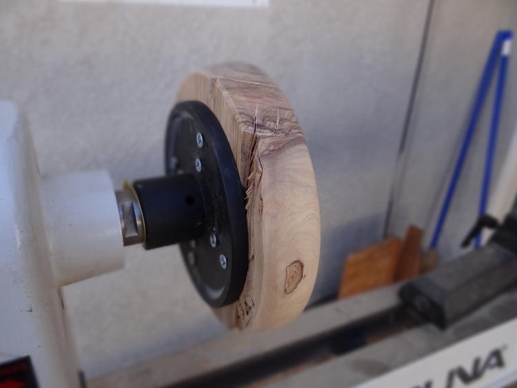

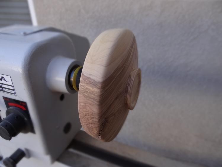

October 14, 201412 yr comment_55475 Well I had to hit it again today, had the day off so after extensive clean up in the ol shop/garage, I found some time to turn a couple pieces. First I attempted a small bowl with California Live Oak. I was successful turning the outer shape, but when I flipped it to hollow it out that is when everything just got to grabby and studdery and chips and gouges occurred, so I think I have learned today, at all costs stay away from Oak for bowls! The image below is an olive wood bowl I cut from a log then chucked it up on the lathe and came up with this shape. It is green wet off the chisels. I loved it, it was a tad warm today and I could feel the cool air coming off the small log as the chisels cut into it. Right now as I sit here, the bowl is still on the lathe faceplate, it may crack overnight it may not, cross my fingers. I just read that nice little topic Cliff put up about soaking the work in a solution of water and detergent, that'll be one I'll have to try for sure. Image below, Olive Wood Bowl Outer The next image is the top of the bowl at the face plate, you can see it's pretty rough looking, I am not sure if I am going to be able to successfully complete this one without it fragmenting into 3 different pieces during the process. What do you guys think, should I abandon ship on this one, or give it a whirl? This is great fun. By the way I have a stack of green olive logs about 8 feet tall and 20 feet diameter where I work, I can get these any time! Cool figure eh! You know the shavings actually smell like the olives we eat too. Report

October 16, 201412 yr Author comment_55519 A word of caution from me. Turning wood is contagious. Not only is it contagious, it is addictive. You will find yourself wondering about the wood and what you will do next. You even think ahead about what you will turn tomorrow and how you will do it. It effects your mind. You will find yourself thinking about several projects and how you may do them. Problems develop when your turnings fun take over and you find you would rather take to turning wood that turning to your wife............This can be serious and could lead to a separation. Separation is bad, it can ruin a good project. :-) HAHAHAHA! That was good Ron, and the scary thing is, I can see this becoming very addictive. The main reason is the quick satisfaction one gets. It's not like building a piece of furniture where takes weeks or even months before it is finished. Yet a bowl can be turned and finished in an hour, after work, or just because, it is very cool and I love it so far. A note on that olive bowl above, woke up this morning and the crack got bigger, dividing the bowl virtually, no way to hollow it now without it shattering. I wonder if epoxy could be used to fill it then turn it? Report
October 16, 201412 yr comment_55529 A note on that olive bowl above, woke up this morning and the crack got bigger, dividing the bowl virtually, no way to hollow it now without it shattering. I wonder if epoxy could be used to fill it then turn it? CA to penetrate, Epoxy to fill and then a large hose clamp. Wrap the turning in a piece of inner tube to protect the outside, if it has bee sanded. Report
