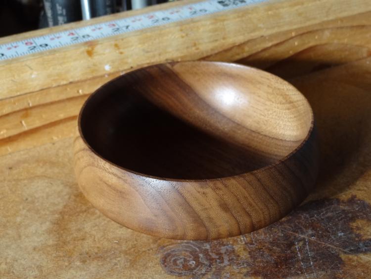

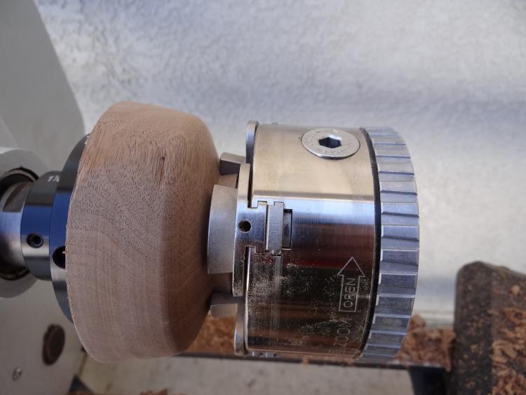

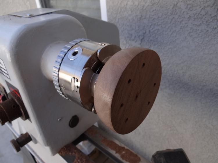

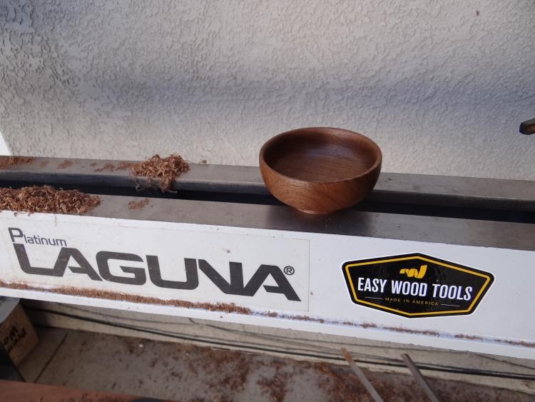

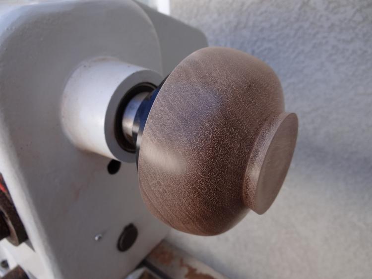

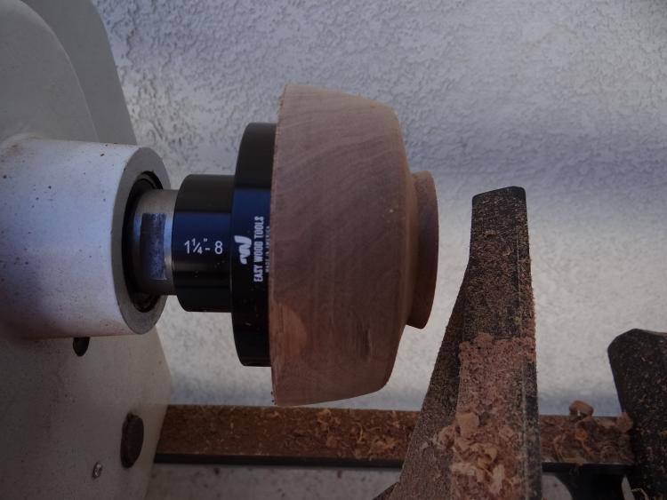

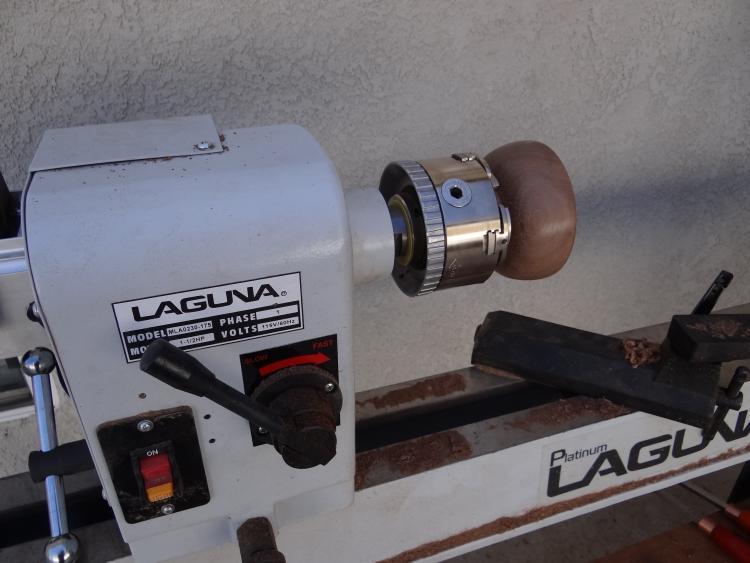

October 13, 201412 yr comment_55444 Well I finally got into the shop today and finished up the lil bowl I started last night at the last minute right before the sun set. I rolled my lathe out to our patio because our garage is still full of our household kitchen contents from the flood we had over the summer. Even with the shop empty of foreign items, this is an outside process right now. So I just had about 15 minutes last night before it got to dicey to be turning in the dark. I was able to mount a chunk of walnut onto my Easy Wood Tools 3.5" Diameter Faceplate and get the outside of my lil 5" diameter bowl turned, then I shut it down. Woke up this morning ready to roll and finished up the bowl in about a half hour, it was so fun I went for another! I am finally getting a chance to get to know my Laguna 16-43 Lathe. I love it. The first image is my bowl roughed out while mounted to the Easy Wood Tools Faceplate. In order for the Easy Chuck to work, I have to shape a bottom or base that will be the base of the bowl, and it has to be angled slightly in order for the jaws to grab. A by-product of this being the case is, it looks good too, I like the base the bowl ends up with. In order to be sure the Easy Chuck was going to be a good fit I did a test run before moving on to the next step. I mounted the Easy Chuck to the base just to make sure. I also hollowed out the bottom ever so slightly to ensure that it would sit flat. It took me about 15 minutes to sand through the grits to 600, basically burnishing the outside of the bowl to a nice sheen. Once I was satisfied with the outside of the bowl, and after the test fitting of the Easy Chuck at the base, I removed the bowl and flipped it and chucked it into the Easy Chuck, I love this chuck! We are ready for hollowing. After I hollowed out the bowl, I hit it through the grits again to 600, and brought it to a nice sheen. While it was still chucked up to my lathe, I applied BLO, I know there are better alternatives for a finish, but I am winging this right now, I don't have much knowledge yet in this skill, nor do I have the proper tooling, at the ready. But I am learning. My first bowl finished. My second bowl did not take as long, I am already feeling very comfy on my lathe and the tools I use, by the way I used the Easy Rougher and the Easy Finisher, two tools to complete these bowls. My second bowl below. I am starting out small guys, I am not confident with the big stuff yet, both these bowls are 5" +/- diameter. Bottoms Top I really had a fun couple of hours with these guys, I can see myself coming home after work and gravitating to my shop for a quick bowl. I can see why this is do addicting now. Also I am using the Easy Wood Lathe Tools, they are a joy to use, I have no frame of reference to compare them too, but for this newbie I experience only a couple digs and that was because I was rushing it, other then that they worked flawlessly, and for this knuckle head to be able to jump into this as easily as I had, that says a lot about those tools. The Laguna 16-43 Lathe is smooth and nice, I love the variable speed lever it comes with, the lathe is heavy, and solid, and I can't wait to get some big stuff on there, thanks for sharing my first bowl adventure guys. Report

October 13, 201412 yr comment_55465 Both bowls are absolutely fantastic, John! Super shape and proportions. Those Easy Wood Tools really cut cleanly so there is little to no grain tear out. Great finish, too. The second one has really delicate walls- Great Job!!! Report
October 13, 201412 yr Author comment_55470 Both bowls are absolutely fantastic, John! Super shape and proportions. Those Easy Wood Tools really cut cleanly so there is little to no grain tear out. Great finish, too. The second one has really delicate walls- Great Job!!! Awww shucks thanks Lew! I am working on a third one right now and I am learning that oak is not a good medium to turn with. Or is it? I am having horrible luck, and I can only imagine because of the course grain in oak, but it's a PITA! Report

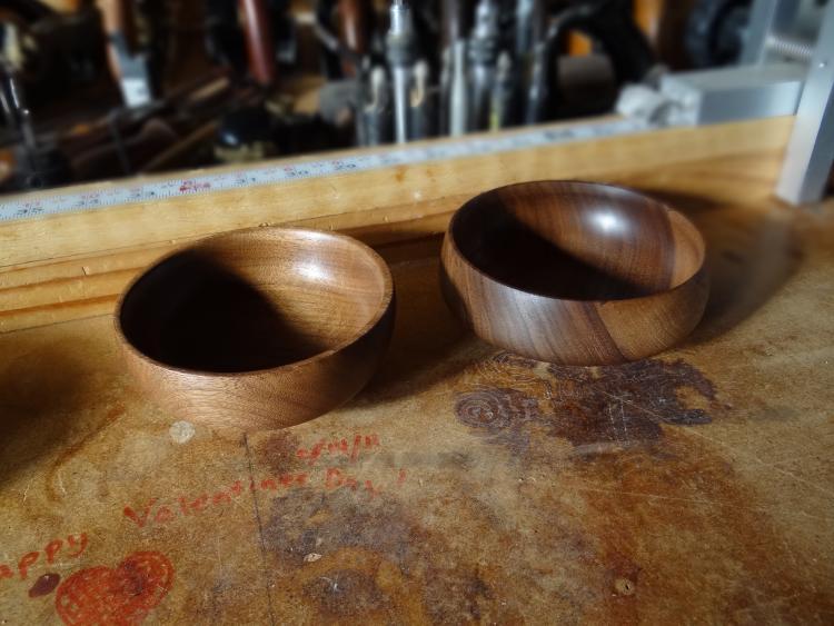

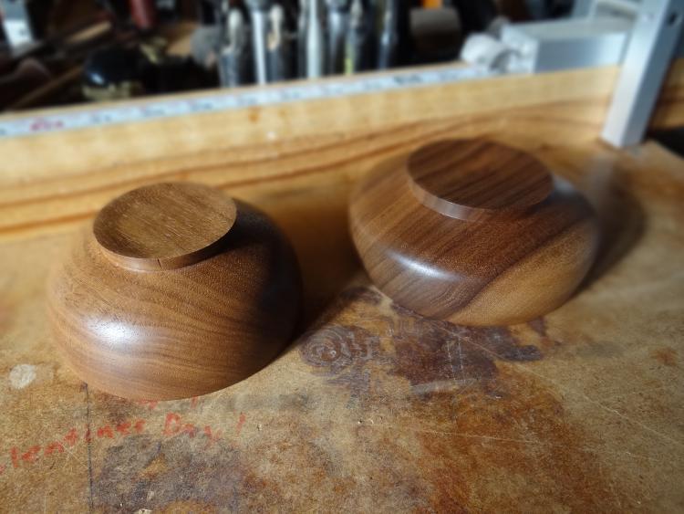

September 7, 201610 yr Author comment_72488 My first bowls, I thought I'd bring this back up to the top, for the new folks to see one of my first attempts at turning. Ya, I was pretty proud of these. Small, but hey, it's a great testimonial to EWT's, even a beginner can turn cool stuff the first go out. Report

September 7, 201610 yr comment_72535 First two look great. You got them smooth with no tear out visible. You are a brave man using Walnut for your first. My first ten were pine. Report
September 7, 201610 yr comment_72569 I like the shape of the first one best. Now we can work on your foot and maybe teach you how to embellish the bottom. Seems like we have all developed a trademark style , Steve has his Zentangle and I have my 3 rings. Or you could just brand it. Point is to identify it as yours so your kids or the giftee can say "John made this for me". Report
