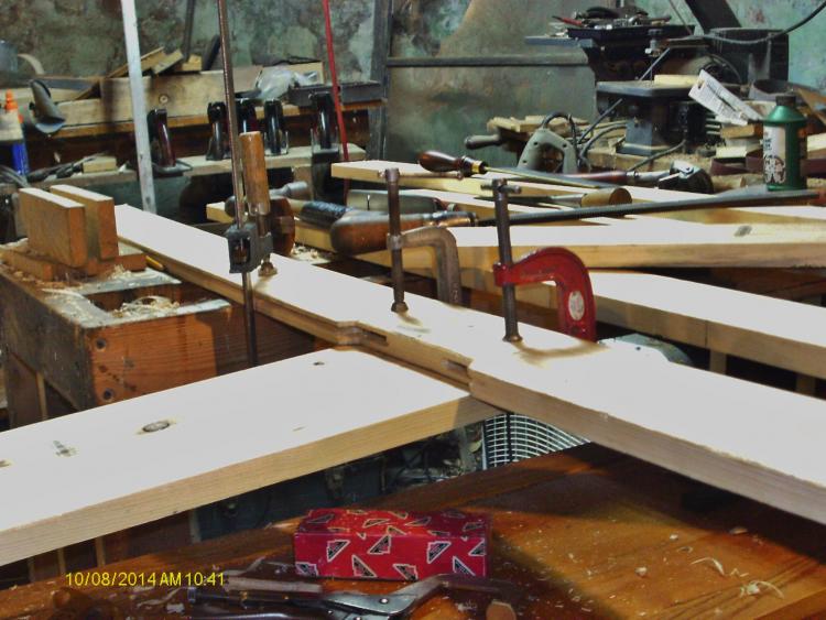

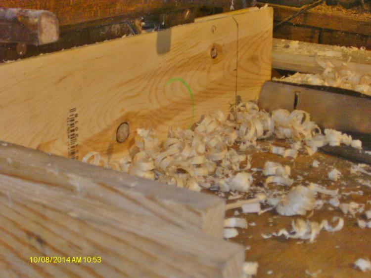

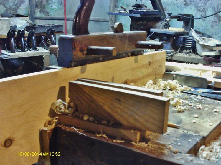

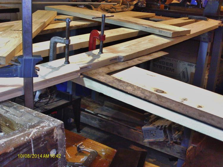

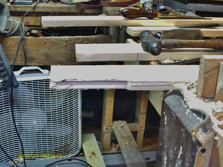

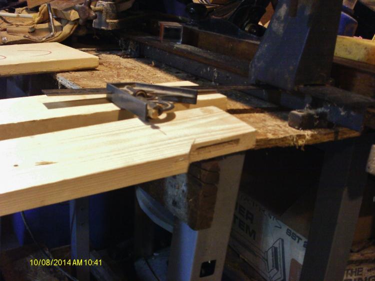

October 8, 201412 yr comment_55291 Ok got a few things done. One stile is now completed. Grooves and mortise cut, cut outs for the rails to snuggle into. GGrooves were cut with a Plough Plane From about 1860 or so. makes some nice curlies Got some mortises finshed up One for the bottom rail Top rail's mortise. Note a 45 degree cut? The rail will match this, will look like a mitered joint. The center Lock rail was a bit different Double tenons. Double 45s. Grooved on one side, will have a rebate on the other when things get put together. Checked the joint for square, then marked out for the tenons. Not too bad, so far. Need to cut a few tenons next. Then locate WHERE a middle stile will go. Make that part, and measure for a couple raised panels. Might do one big panel, rip it to size, and have a book-matched panel for the bottomof the door. So far, mainly hand tools...LOTS of them. List of "Toys" so far: Mortise Chisels 3/16" and 1/4" Firmer chisels BIG hammer, as the wood mallet just won't drive the Mortise chisels Couple of squares Marking/cutting guage Plough plane, 1/4' x 1/4" grooves Low angle Block plane, #1455 Gents Saw, crosscut/miter cuts Backsaw, filed rip. For rip cuts Full sized handsaw, 8ppi crosscut, cut the boards to length. ( cheated on some, got out the Craftsman 7-1/4 circular saw) Tape measure, of course. Might come in handy? Stay tuned, the CUSSING is just beginning... Report
