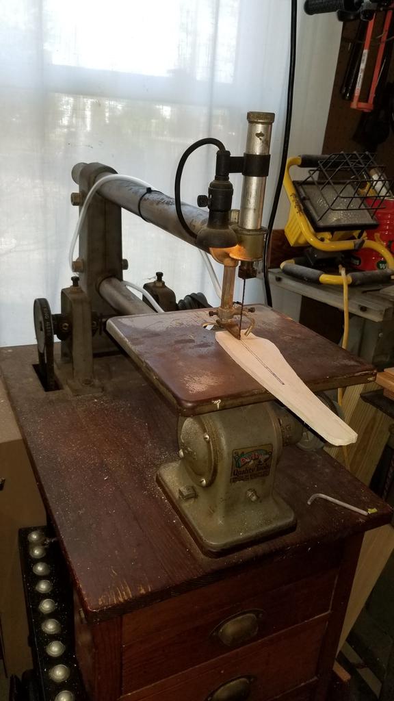

Hi again,
I spent the past weekend building a buffer to polish the frame tubes, and other parts such as the brass upper plunger tube, and bolts and nuts that I won't be replacing. I also finished cleaning parts that had not been done yet. I'll let the photos show the progress.100_01281?width=721
I used Porter Cable buffing compounds.100_01292?width=721
The table cleaned up well with the random orbital sander.100_01301?width=721
I began assembly with the table.100_01321?width=721
I polished the angle gauge with the buffer, it still has some minor scratches that I'll live with.100_01311?width=721
Then started to assemble the frame.100_01331?width=721
100_01391?width=721
100_01401?width=721
Inserting the tubes into the frame legs, and drive housing turned out to be a little more than expected as they are a tight fit. I ended up having to repolish the upper tube due to the fact that I scratched the upper one when inserting it by giving it a twist going through the inboard leg. The scratches showed badly between the legs so I did the repolish, then inserted the tube without twisting the second time.
That's about it for today, tomorrow I'll assemble the drive assembly.

Hi again,
Today I assembled the lower drive assembly, and most of the rest of the saw. I need to pick up some RTV sealant, and pipe joint compound to properly seal the drive housing cover, and bearing housing assembly to the drive housing. I'll let the photos show todays progress. The first photo shows the parts before assembly.100_01411?width=721
The next photo shows the inner bearing installed on the crankshaft after packing with grease, it also shows the fibre washers installed into the bearing housing.100_01422?width=721
The next photo shows installing the crankshaft into the bearing housing.100_01451?width=721
Now the outer bearing.100_01441?width=721
The bearing cover.100_01501?width=721
Felt washer first then fibre washer.100_01511?width=721
I got out of order here so now I'll go back to the blower pump assembly.100_01461?width=721
100_01471?width=721
100_01481?width=721
100_01491?width=721
The completed bearing housing.100_01531?width=721
Now installing the lower plunger shaft.100_01541?width=721
Installing the cross-slide.100_01551?width=721
I lined up the hole in the cross-slide with the dimple on the plunger tube so the set screw would be in proper location on the plunger tube. The two dimples are directly across from each other in case you would want to change which side your drive pulley is mounted. I will be adding a second set screw to lock the cone pointed set screw to keep it from coming loose.100_01591?width=721
The set screw is located in the center circle on the back side of the cross-slide. There are plenty of threads to add a second set screw to lock the first one, this should prevent the cross-slide from coming loose and further damaging the plunger tube. I also have to pick up a cork to put inside the plunger tube to prevent oil from coming up the tube, and prevent broken blade pieces from making thier way into the crankcase. This is per the diagram that I downloaded from Vintage Machines. org website. The vertical wings on the cross-slide above and below the set screw hole fit into the groove on the back of the housing cover to prevent the cross-slide from turning in the crankcase. The next photo shows the fibre slide block installed.100_01561?width=721
The pin on the crankshaft fits into the bronze bushing in the fibre block above.100_01571?width=721
I only finger tightened the screws that hold the bearing housing, and crankcase covers as I have to apply RTV sealant to form a gasket for both pieces. I will also use pipe joint compound on the bolt threads to prevent oil leaks. The manual says to use shellac but with todays sealants I'll get a better seal. The next photo shows the table installed.100_01621?width=721
The green air hose is from a medical oxygen machine. I made clips for the air hose that were shown in the manual that I downloaded, it just showed that they were there but not what they looked like. Neither saw had them or the chip blower tube which I will also fabricate.100_01711?width=721
100_01721?width=721
I will be adding the other end cap from the second saw to cover the lower frame tube end. On the upper tube there is a through rod that attaches the upper plunger assembly to the saw, I will use the bolt that tightens the drive housing to the lower tube from the second saw along with one of the wooden plugs I used to spin the tubes on the lathe to attach the second end cap. A look at the almost assembled saw.100_01601?width=721
100_01611?width=721
100_01621?width=721
100_01661?width=721
I still need to fabricate the chip blower tube, install a pulley, finish cleaning up and polishing the table inserts, and do an alignment on the saw but it is getting closer to being a working saw. I also have a steel lower blade chuck coming (from ebay) for the saw so that I can replace the cast pot-metal one. I also have to make my decals which I found the materials for. I haven't had a chance to figure the software out yet. It's a Testors decal kit for models, that I will be using to print decal images that I downloaded from the Vintage Machines. org website WIKI. So maybe next time I'll be able to quote Frankenstein and say IT'S ALIVE!

Hi again,
First off I would like to thank everyone for the kind comments. I've made a little more progress towards the completion of the saw.
I recieved the steel lower blade chuck yesterday, and as I had hoped it is a direct replacement. I also fabricated the blower tube, and made a pair of table inserts from fender washers. I also painted and temporarily installed the drive pulley. I have to start writing myself lists when I go for parts as lately I forget half of what I go to get. I was looking through the 1931-1937 Delta catalogs again today, and saw another part that I feel that I will have to fabricate for this scroll saw. That is a finger guard that Delta had in I believe was the 1935 catalog. Of course I'll make it out of brass. So for now I'll let everyone see the small amount of progress since the last update.
First up a comparison of the lower blade chucks.100_01751?width=721
100_01761?width=721
100_01771?width=721
100_01781?width=721
The cork was sanded to press fit size, and is installed into the lower plunger tube to prevent broken blades from entering the crankcase. The following photo shows the homemade blower tube, and table inserts.100_01801?width=721
The following photos show the parts installed.100_01811?width=721
100_01821?width=721
100_01831?width=721
The wife says that the red sets off the color scheme that I used, so I believe that I will stick with this color scheme for the rest of the machines that I will be doing.  I myself like it better than the typical Delta grey, and as an earlier photo of the American Boy scroll saw shows, it was a color scheme once used by Delta a decade earlier.
So next time I will take a list when I run for supplies, and maybe in the next update we'll be able to make some sawdust.
Now to figure out how to make decals, and how to do video on my camera so I can show making sawdust.
