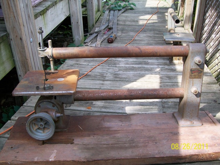

I am about to undertake the restoration, and upgrade of a Delta model 700 Scroll Saw. This model was available from 1931 to 1937 in the Delta catalogs. I have two of these saws, and will be using the best parts from both units to complete one machine. Both of the machines as I received them either had the upper blade chuck missing or broken, so this is where the upgrade part of the restoration comes into play. I will be using the plunger bearing, shaft, and upper blade chuck from a later model Delta Scroll saw to replace what I have found to be a rather unobtainable part to locate. At the same time I will maintain the ability to index the upper blade chuck, plus add easier to perform blade tensioning to the saw.
First the saws.
ning-100-0012-41281-93.jpg?width=750

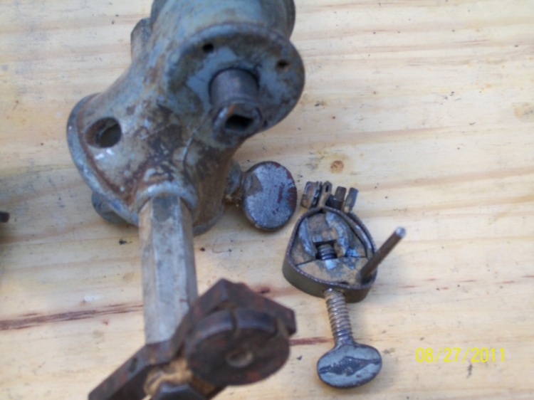

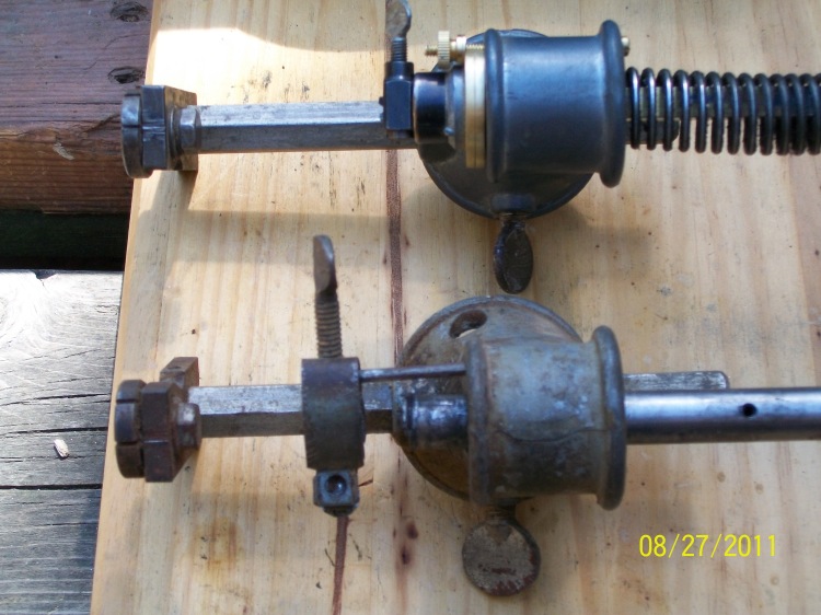

Now for a look at the original upper blade chuck assembly.
ning-100-0038-41281-29.jpg?width=750

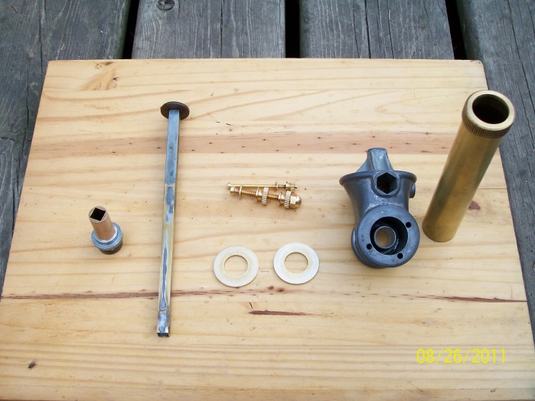

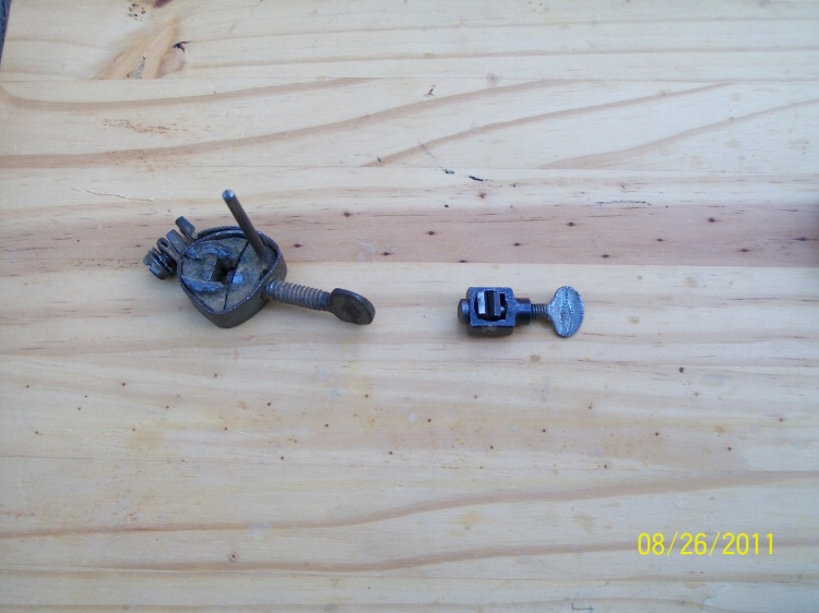

Now a look at the parts that I'll be using for the modification.
ning-100-0019-41281-6.jpg?width=750

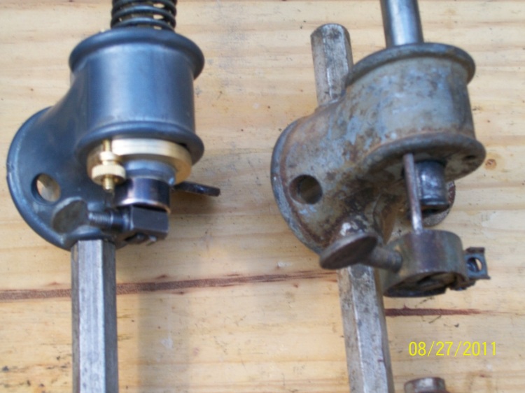

A comparison of the upper blade chucks, I'll be using the smaller one.
ning-100-0021-41281-76.jpg?width=750

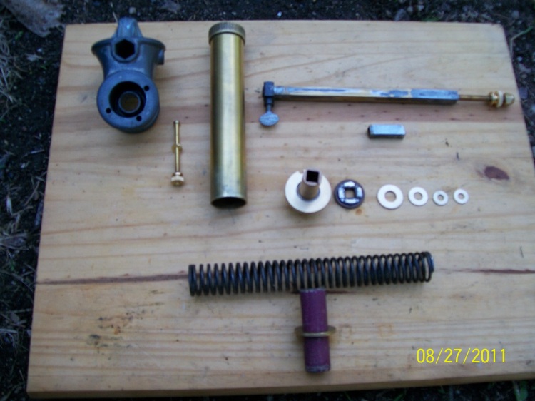

A showing of the parts after a little rework.
ning-100-0024-41281-19.jpg?width=750
All machining work was accomplished using 180 grit sandpaper, and a 1/8" round file.
The bearing was turned down with sandpaper to fit the upper head casting, and the large brass washers inner diameter were enlarged to fit the shoulder on the plunger bearing. These were in turn epoxied to the bearing shoulder, and each other. The file slot is for blade indexing, and gets secured using the 6-32 Brass machine screw, and knurl nut. The plunger shaft was cut just below the fiber washer, then 1" was removed from the shaft. The next step was to turn the head of the 10-32 machine screw down to fit in the end of the plunger shaft. This was then silver soldered into the shaft. This will accomplish the bade tensioning by shortening the shaft's length. The smaller brass washers will be epoxied to the top of the fiber washer assembly's metal part.

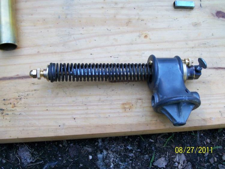

Another view showing the assembly.
ning-100-0030-41281-75.jpg?width=750
Another view showing original versus the remake.
ning-100-0037-41281-23.jpg?width=750
And another.
ning-100-0036-41281-88.jpg?width=750

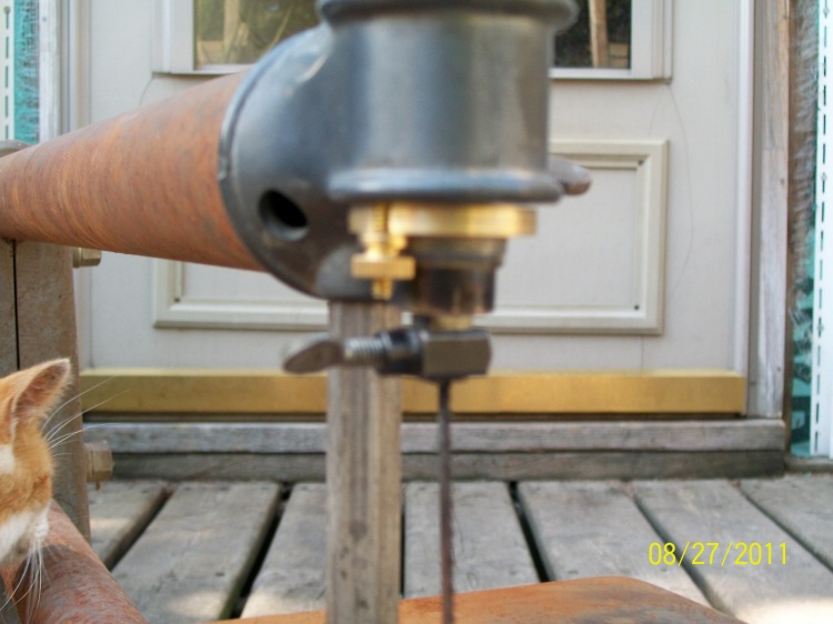

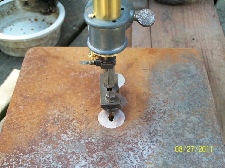

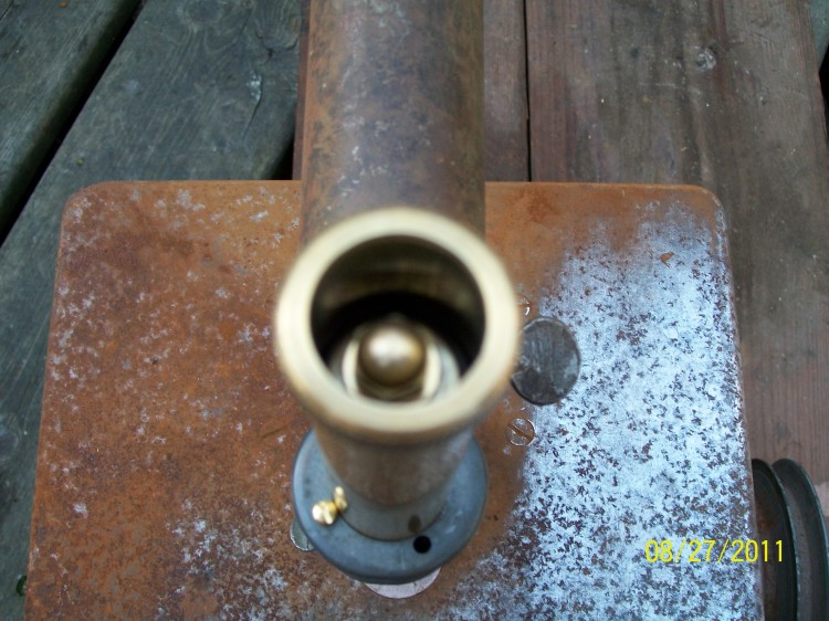

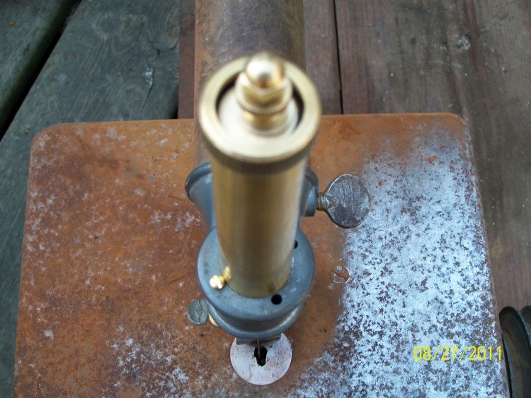

And a test fit view on the saw.
ning-100-0040-41281-76.jpg?width=750
ning-100-0042-41281-92.jpg?width=750
ning-100-0043-41281-21.jpg?width=750
ning-100-0044-41281-62.jpg?width=750
Sorry about the photo quality, but this is my first time using a digital camera, it's also the first time that I've posted pictures to a website. So thanks for understanding.
