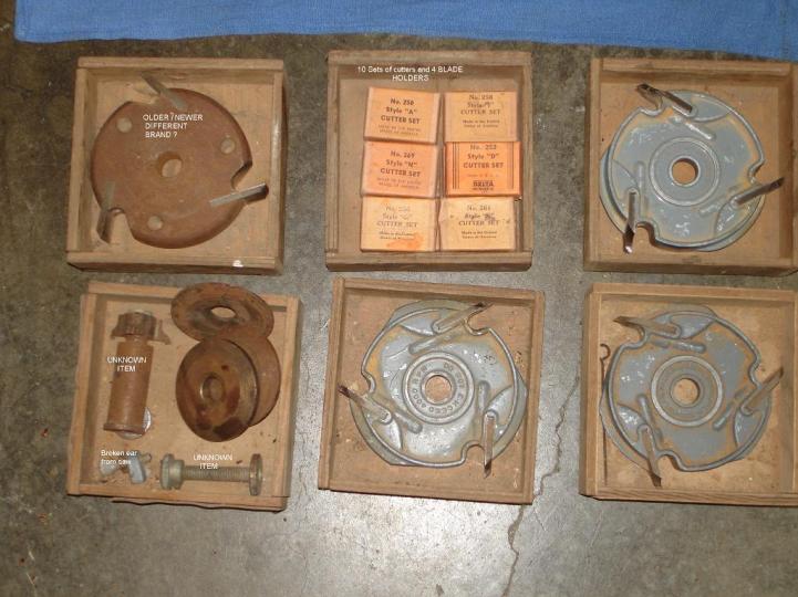

Here is a picture of some extras that came with the saw. The molding shapper cutters had been used as I also received three blade covers that had been cut out special for the blades to come up through. There are 10 sets of cutters all in their original boxes. There was a screw with a broken ear attached that I now realize was part of the front trunnion. It is an adjustment screw for table travel limits. DANG!
There is a shaper cutter also that is like a router cutter that does not fit anything I have it and a bolt and nut that may go to the saw but remains unidentified at this point.

The three matching molding heads are the first style of Delta molding heads. The heavier steel one is the newer second style Delta molding head. Nice assortment of early molding knives! From your earlier photo of the arbor, and this photo it also looks like you have both sizes of the spacers for doing tennons also. ( I'm missing one )
I was wondering from your earlier photos if the front trunnion was missing a stop or not, but now see that it is.
It will not affect the performance of the saw however.
As to the other two items I would need different views of them to try to identify them.
Without seeing the table inserts they may be original Delta items. There were three different ones available, a standard, a dado, and the molding inserts.

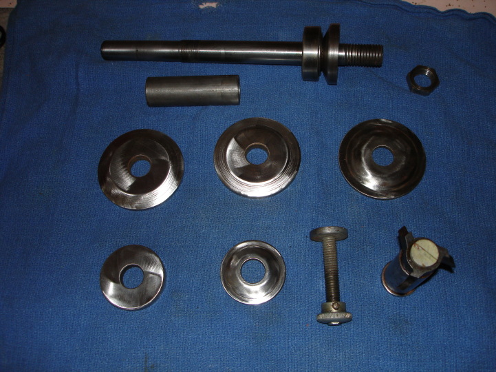

I don't know anything about making tennon's? Are these spacers what you use instead of the smaller ones when using the molding cutters or should these be on the saw now with a regular blade? The table inserts are just home made ones out of plywood. Nothing special there. I will post some more pics of the unknown parts after I clean them up.

The thick flat washers are the tennon spacers, they are used between a pair of dado blades to cut tennons. The beveled washers are arbor washers used to hold the blade or the molding heads, they go just behind the nut on the arbor.

The only flat washer I have is a small one the size of the blade washer that is part of the shaft.
The bigger washers have a taper on one side like the outer washers. You can see them better since I cleaned them up.
The odd ball cutter I have, I also cleaned up. It has a taper in the back end that looks like a morris taper. The cutter threads on to it and has a left hand screw in the end to lock it down. It must be some sort of a router cutter.

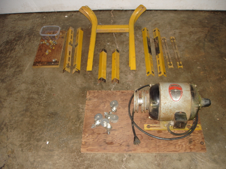

I also got the stand all pulled apart this morning to clean up and paint.

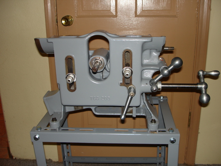

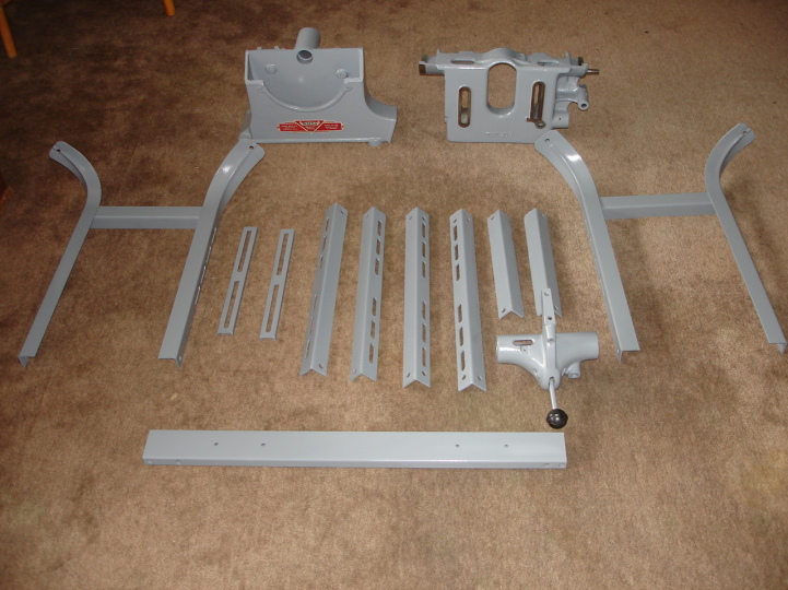

Well It's been awhile since I posted an update on my project so I thought I would let everyone know how it is progressing.
The saw was completely disassembled and cleaned up. The frame pieces were bead blasted and sanded to remove rough spots. The Heavy casting pieces were scrubbed and wire brushed to clean them up as best I could and masked off to keep the paint off critical areas. Everything was painted and polished up and reassembly is going smoothly.
I was able to get some new bearings for it from a local bearing house. The old bearings felt very tight as far as wear goes but turned stiff, I popped out one dust seal and found the grease to be hard caked, I got them  spinning free after cleaning out the grease but didn't want to use them without the seals.
The table got scrubbed up and painted this past weekend and I sanded and shined up the top surface and will be put on soon.
I still haven't decided weather I want to break into the motor to replace the bearings in it or not, but it would make the project look complete with a nice new paint job on it as well.
Things are coming along nicely.

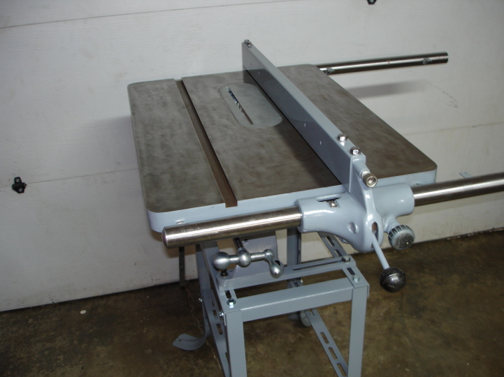

ning-dsc03212-32563-97.jpg?width=721ning-dsc03201-32563-1.jpg?width=721ning-dsc03211-32563-65.jpg?width=721

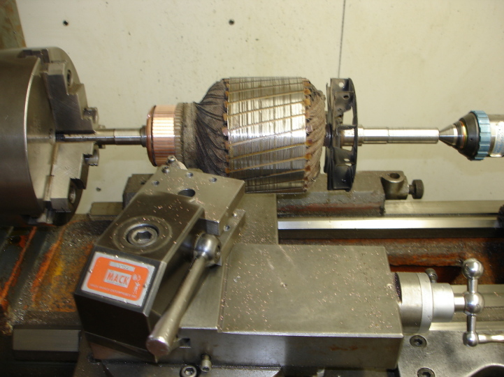

I have made some progress on the old saw so I figure it is time for an update.

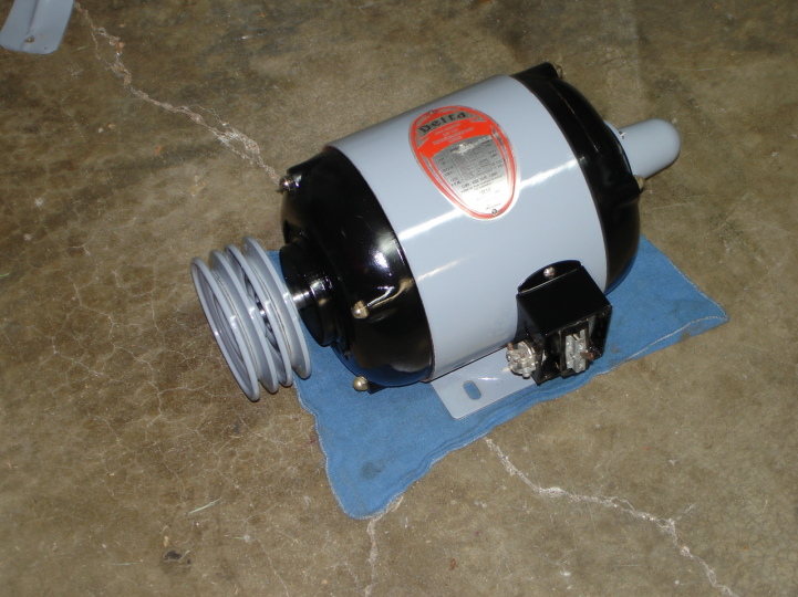

I cleaned up the table surface with a sander and painted the sides and bottom, I spun the guide rails in my lathe to clean the rust off first with sand paper then scotchbrite I pulled the motor apart, cleaned up and painted it and took the outer shields off the bearings to clean out the grease that was hard as dried mud. I didn't replace the bearings but instead just re-greased them and put them back in. They were in good shape other than being caked up.

Randy this saw is looking fabulous man!!! Did you go any further to clean the inside of the motor at all, the windings etc.? I am asking because on my Walker Turner I am debating how far I should go to clean the inside of the motor up.
Edited by Larry Buskirk
John-
My motor was pretty clean inside and just blowing the dust off the windings and washing out the end castings was all I did. I didn't have a clue on how to pull the windings out, they must be just pressed in the housing? After sanding the rust off the outside I did run it under hot water to get the dust off and I wasn't really trying to keep the water off the windings but I didn't just hose it out either.
My commutator was worn down somewhat so I turned about .010 off and sanded it to clean it up. The fan was tweaked out of shape so I straightened it out when I had it in the Lathe.

The electrolysis method is not mine, I saw it on other websites and thought I would give it a try. I only brought it up here for members that may not have been aware of it. I also need to find a larger container so I can do my table. I've got pieces of two different machines ready for paint but the weather is not cooperating. It's either raining or to cold for painting outside which is where I have to do my painting.

Using a metal container is possible from what I have read. The main problem would be keeping the part you are cleaning from coming in contact with the container causing an electrical short. The other problem is that the container would become part of the sacrificial metal during the process.
I'm trying to find one of the hard plastic wading pools for doing my larger items. It's probably not the ideal container but I don't want to have to mix up a large batch of electrolyte.
