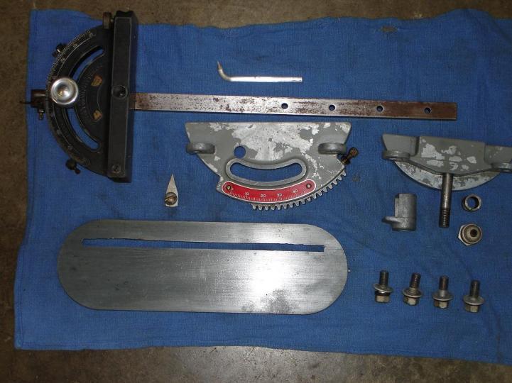

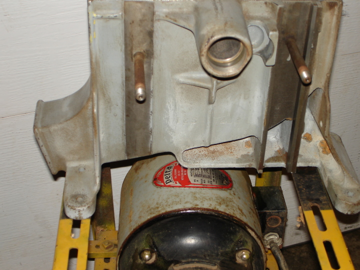

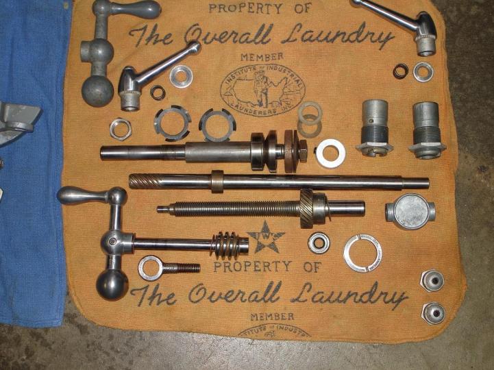

Here are a couple more pictures of my progress. Everything is in various stages of clean up. I am polishing all the knobs and handles, they clean up pretty nice. Painting will start this weekend I hope.ning-dsc0314750-32581-83.jpg?width=721ning-dsc0314850-32581-94.jpg?width=721

Randy,
Looking Good! It looks like you got bit hard by the OWWM bug.
I'll be polishing up the shafts, knobs, handles, etc. on mine also. My paint scheme will be the same hammered black / metallic brass / safety red that I used on my Delta 700 scroll saw.
I'll be painting all of my " Old Delta's " the same way.
Now that the weather is improving, I'll be getting back to getting things accomplished. I hope!
