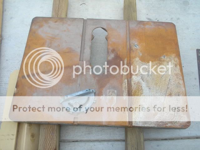

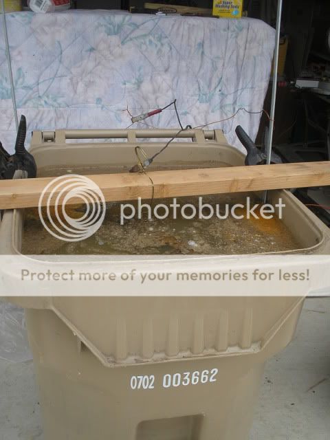

Hi Everyone,
I figured that I would show how good the method works at removing almost everything from a casting. So I put one of the main body castings for my Delta 1160 table saw into the electrolysis tank. Here are a couple of before photos.
Hmm, it looks like the soups ready Yummy!
This photo shows the scum buildup after four hours on the sacrificial metal plates.
The end result after about eight hours of cooking.
There is very slight traces of paint still present but I felt that it was clean enough. The slight amount of rust still present rubs right off with a Scotch-Brite pad. Sure beats trying to clean up such an irregular shaped casting with a wire wheel!
It also doesn't damage the machined surfaces like sandblasting does.
Now I'll clean up some of the casting flash, and it will be ready to paint.
I'll be using the Electrolysis Method for most all of my future projects!
Edited by Larry Buskirk

Don't forget that it works "line of sight". Meaning that the area that faces the anode will be cleaner than the protected side. It will also clean the opposite side but not as well. One way to combat that is to add more anodes. I usually use rebar or old metal channel and connect them with some copper wire.
Posted (edited)
Ken,
I found that out, and added a second piece of scrap plate steel. I do turn the part being cleaned around and over when I check on the progress. I also scrub and rinse both the part being cleaned and the sacrificial anodes, it seems to help keep the process working more effectively. I should probably add a couple of more anodes so that there is four sided coverage.
You had mentioned another method that you were using in a private message. Do you know if it would be safe for the cast pot-metal parts? I want to clean up the trunnions etc. and they are cast Zamak. So I know that it is not safe to do these parts using the electrolysis method.
