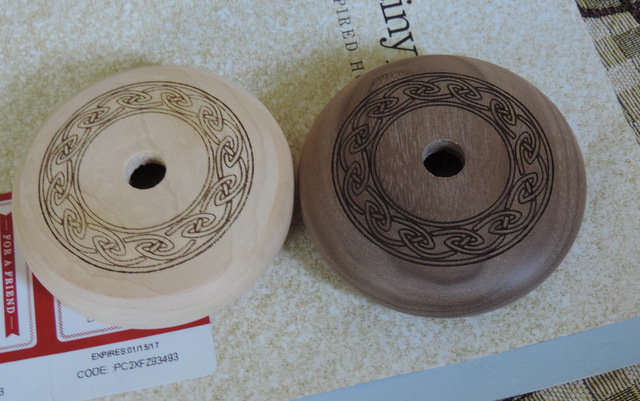

DSCN1546.JPGOne of the items I make quite a few of, are decorative lids for mason jars, and/or honey dippers for mason jars. One of the main things I wanted to do with this machine was to embellish the lids to increase the value of them. I did a couple test lids today using the t2laser software and I'm really pretty happy with the results. One of these is maple and the other is walnut, same settings on both. The nice thing is, once the setup is made, the little laser can work on it's own while I'm doing something else. So, that's where I am at this point, still lots to learn but that's part of the fun isn't it? If someone were to ask me if the machine is worth the cost, I would say it is to me without doubt, just for the learning experience, the rest is all gravy.

How long did it take to do each of the lids?
What types of files are needed for the pattern?  I presume some type of vector file.  Do you have experience with those?
What will that machine do on glass?

First of all, I really suggest you check out the forum I linked to. Friendly bunch of folks and very much more knowledgeable than me. The lids I pictured take just over 20 minutes to do with the settings I was using.  Not a big deal to me as I generally do them 20 at a time or more. I can finish one, stick it in the laser and do some more while it's working. The t2laser software will accept several different file types. Jpg, gif, bmp, png to name a few, as well as dxf. I have limited experience with svg files from using inkscape. I'm not sure if the software will use those. However, inkscape will export to dxf so that wouldn't be a problem if you use inkscape. I have no idea what it would do with glass but I suspect a person would need a more powerful machine.
