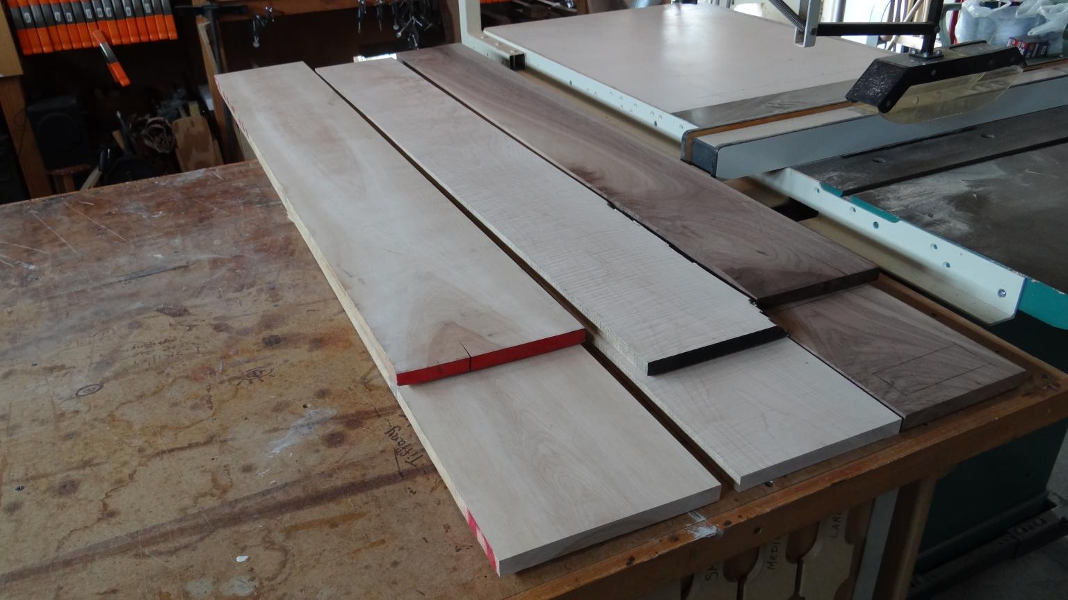

To the right is Walnut, center is the Curly Maple, and left is Birch.
I was able to get out to the shop and get the boards cut and sized, edges chamfered, and all the plaques sanded to 150 for now. Later I'll work through the grits up to 600 in preparation for wipe on varnish.

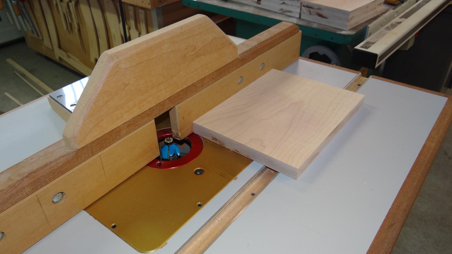

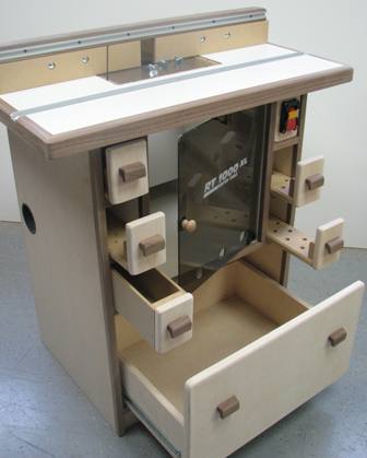

I used a 45 degree 1/2" shank chamfer bit chucked up into my router table. My table is made by an outfit in Canada who sell the RT 1000 series router table, you can't beat the price, and the table is built very well, I have had mine for about 10 years now. The following image is the stock photo of the exact table I have.
When I route any edges on any project that involves routing all four edges of a board, the long grain, and the end grain, I always start by routing the end grain first, the reason is it is possible that you may have some kick out at the tail end of the pass as you rout the end grain, and if that happens, you can always clean it up when you shape the long grain edges. It's just a simple process that gives you a second chance instead of destroying a perfectly good board by not planning ahead for mistakes. The image below does not show the board in the proper position for end grain routing, I took the image as is, but when I fired up the router table I rotated the board 90 degrees to hit the end grain edges first.

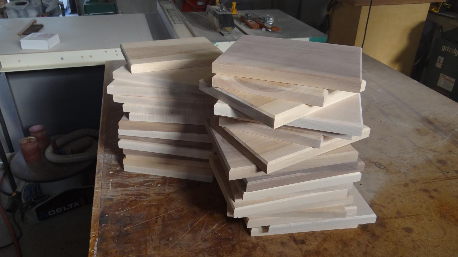

After a few passes with the 32 boards (plaques) I now have something resembling a stack of plaques, ready for sanding.

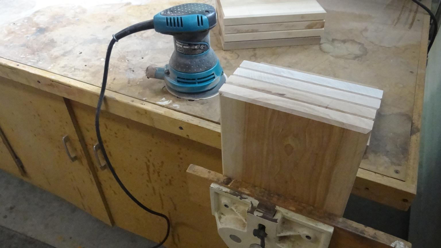

Whenever possible I gang sand boards, just as I gang plane boards, the more the merrier, and it cuts down on the work considerably, not too mention it's just better on your sanding pad as well, it's always better on the sander pad when you can sand a flat area instead of sanding on edge, it's less stress on your sander and keeps your sander pad from wearing on the edges.
After a couple hours of sanding to 150 grit, I finally have some fine looking plaques that are shaping up to be something special, for some very special people. Later I'll take the boards to 600 before I use my wipe on finish.
