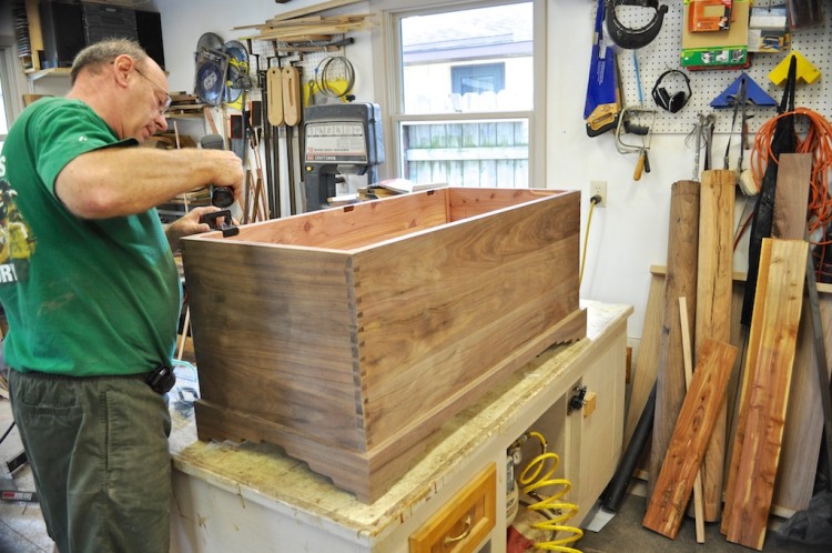

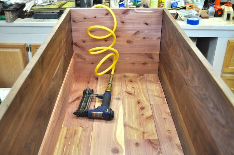

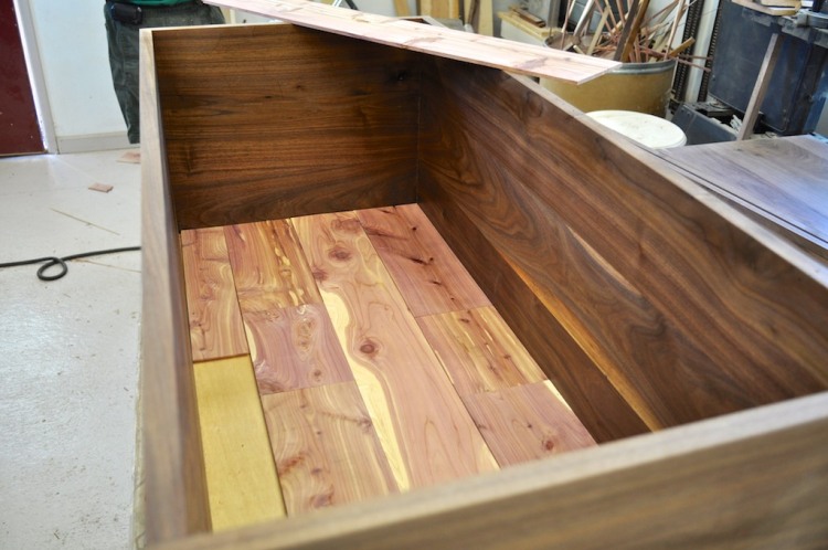

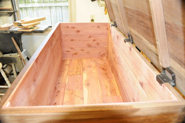

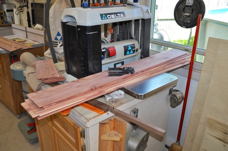

When I got there about 9am Ron had made up the cleats that would go on the underside of the chest lid to keep it flat an not bow and was finishing the final milling of the 1/4" cedar boards to line the inside of the chest. He milled the cedar boards with a small rabbit on the edges so that the boards would overlap so they would all lay flat and there would be no gaps as the walnut moves during the seasons. Before putting the cedar in, he sprayed the inside of the chest with shellac to seal it. Then Ron started with the bottom first, then the ends, and then the front and back. He wrapped it up with vertical 3/4" strips on the seams in the corners to make all look clean. The cedar boards are just held in with brads so there is no glue and the walnut can move with changes and the cedar will move with it without gaping.

After we got the base trim mounted, Ron is putting on the hinges so we can mount the top.

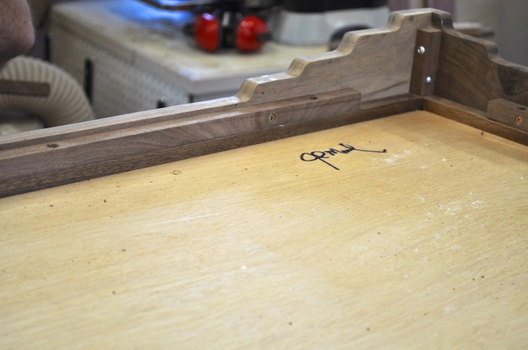

Here is a shot of some of the trim detail. While Ron did the cedar, I made up the the trim using a template from John Moody to trace out the end designs and then scroll saw it and sand it down to final shape on a spindle sander and finish it up with a random orbital sander.The last thing that was done at John's shop in Alabama was to have Ron and John sign on the bottom. Ron's signature is on the other end. Ron and I mounted the trim together and then attached the 3/4"x3/4" trim under the lip of the lid to seal out dust from getting into the chest.

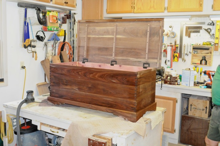

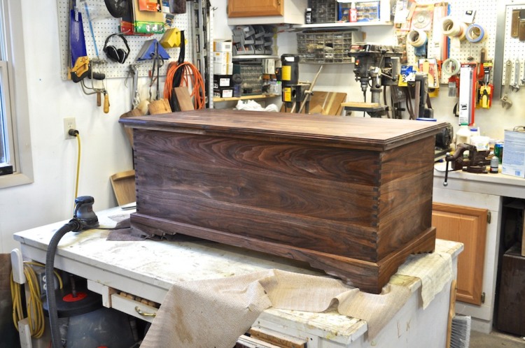

Here are an open and closed shot of the completed chest. Ron wiped it down with a bit of Mineral Spirits to show off the grain. You can see the difference in the "open" photo as the underside of the lid did not have the Mineral Spirits wiped on it.

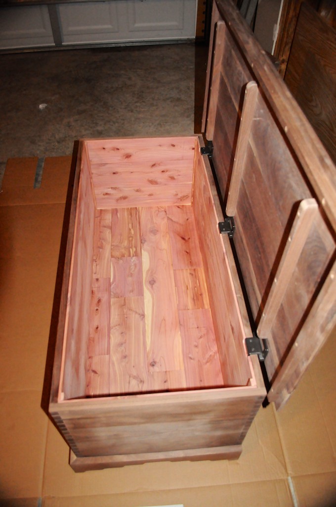

Here is a shot of the completed cedar lining. It sure looks and smells great!

Gene, I really like the trim design as it is a bit more contemporary than a lot of the more traditional designs. The dovetails were really easy to do a John Moody has the dovetail jig from Peachtree woodworking. Once you get it all set up you just line it up, clamp it and route. It was a cool set up.
