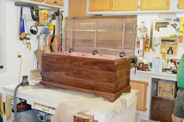

So here is the chest as it was completed at Ron's shop on ThursdayJuly 24th 2014 before we carried it  out to my car. In this photo Ron had wiped on some mineral spirits to show off the grain a bit. The open top did not have any mineral spirits on it so it this is what the whole chest looked liked once the mineral spirits evaperated.

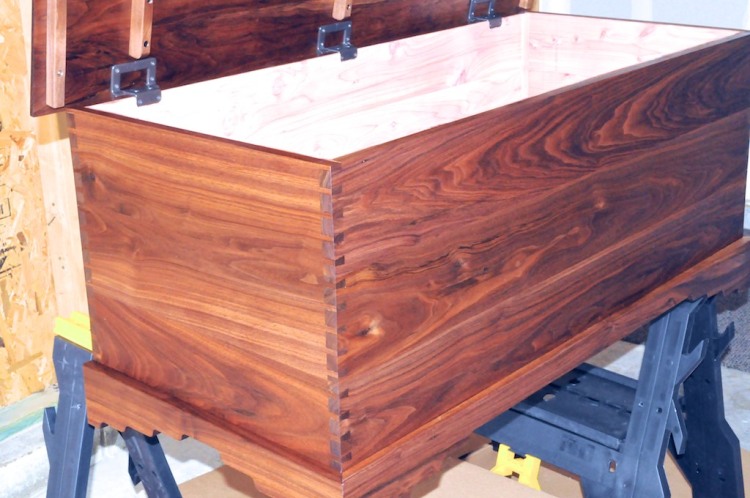

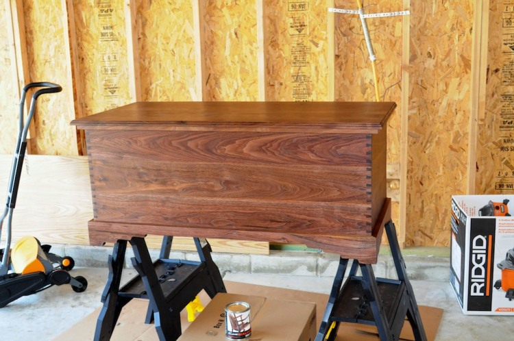

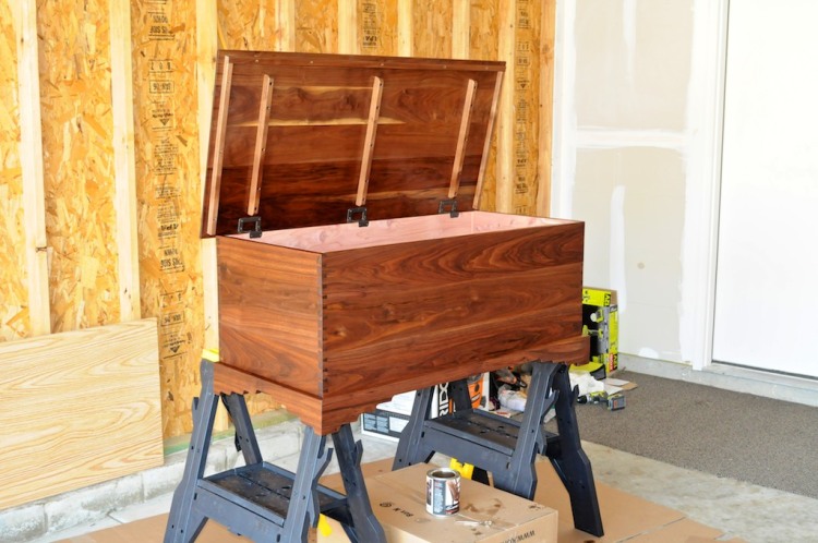

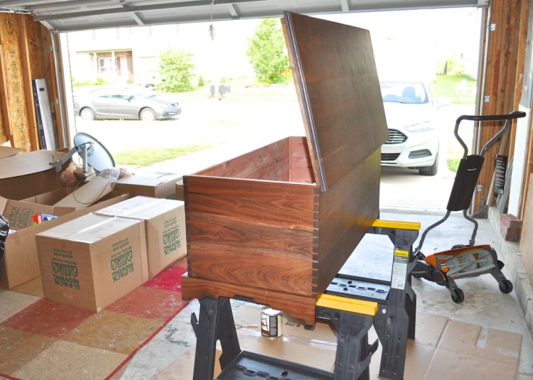

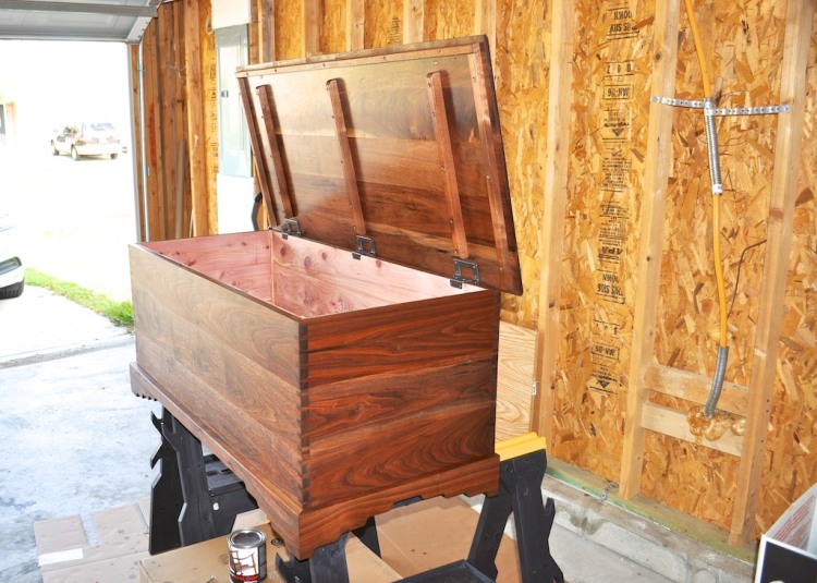

Once I got the chest back to my kids' house in Indy, Tami and I carried it in and set it in the garage. My kids had just moved into this house the previous Monday so there are boxes all over the house and empty boxes in the garage. Since my son has no tools other than a set Husky Tools from Home Depot that I got him when he was 18, I had to go to Home Depot and pick up a few things to get it done. So $300 later I came home with a small shop vac, random orbital sander, 12v drill/driver and bits, 2 folding saw horses to set the chest on and various finishing supplies, sandpaper and a spray can of shellac. As for the type of finish that I was going use I was limited to doing a wipe on finish. So I stopped by the local Rockler store in Indy and bought a quart of the "Sam Maloof Finish" which is an equal mix of boiled linseed oil, tung oil and polyurethane. For the size of this project I could have purchased the 3 separate  items and mixed it myself, but it was cheaper and easier to just buy a can of the Maloof off the shelf. After doing the final sanding from 220-400 grit and getting all the dust off, I sprayed shellac on the underside of the lid to seal it as opposed to putting on the Maloof finish as the oil will cause odors inside the chest. On the outside the chest and lid I wiped on multiple coats of the Maloof finish letting them soak in and then wiping off the excess and then letting it set for 24 hours before doing another coat.
So here are the finished photos of the chest made for my Grand Daughter Nori. Being that it is in the garage and the lighting is horrible, the photos do not do justice to the actual finish.  The grain is awesome and the dovetails look beautiful! The most important thing is that my daughter in law LOVES IT!!
