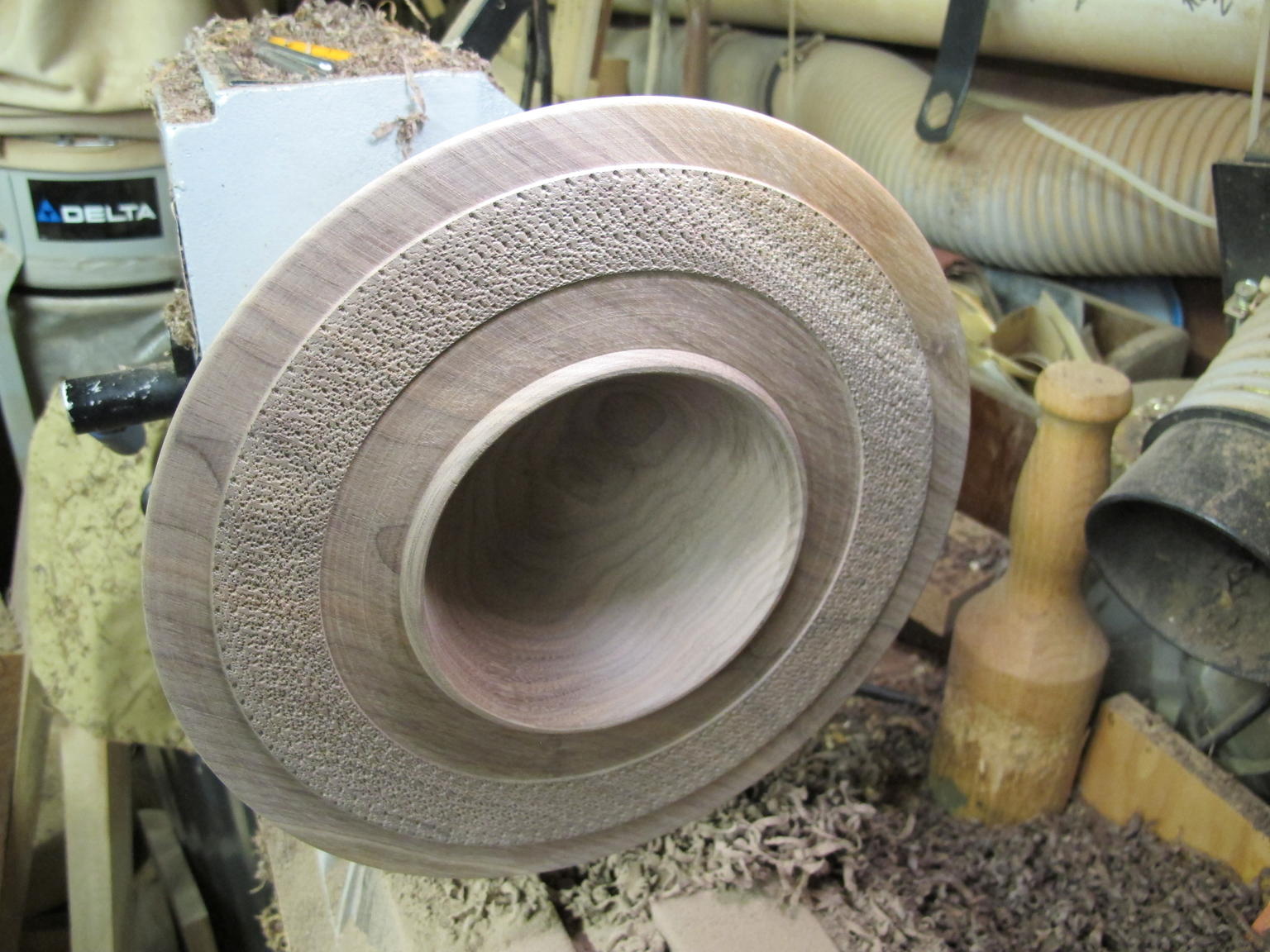

This started out as a 8" x  8" x 2" piece of poplar.  After that, the picture pretty much tell the story.  It is intended for use as a fruit bowl, hence the green rim.  That, by the way, didn't go as expected.  I purchased a green paint pen from Hobby Lobby, intending to hold it against the rim with the lathe on its lowest speed, but the pen was the type that you have to keep depressing the nib on the end to pump the paint to the tip.  That, of course, didn't work with the bowl turning, so I would up having to pump some paint to the tip, get it on the rim of the bowl, and actually "draw" it onto the rim, while periodically turning on the lathe to even out the application.  It eventually worked OK, but next time I will figure out something different.    IMG_20170830_173903444.thumb.jpg.cd1bfe37b04be9cb31db9d48676ceff8.jpgIMG_20170825_180620450.thumb.jpg.11601c3385ab9f580f7a196bab5932a5.jpg59d1538e847e3_Fruitbowl3.thumb.jpg.c40a606a008c2a215657bbd5abfb5064.jpg59d1540ab278d_Fruitbowl4.thumb.jpg.c72e37599a7b9d425066a05cea3d24db.jpg59d154509c91c_Fruitbowl5.thumb.jpg.4952a1fd8bf2ca3e7932d5d1ffd791fd.jpg

I'm not certain there is a "right" way to do it but this is what I do- Apply the paint as neatly as possible (there's always some that's not where you want it. When dry, use the skew to create a tiny capture cut at the edge of the painted area. Burn the line. Use sand paper or scraper or tool of your preference to remove the errant paint from the "other" side of the burn line.
Although I didn't burn any lines on this piece, I did use this process. The texturing was painted completely then the high spots were sanded and finally a scraper was uses to cleanup the inside and outside ring borders
