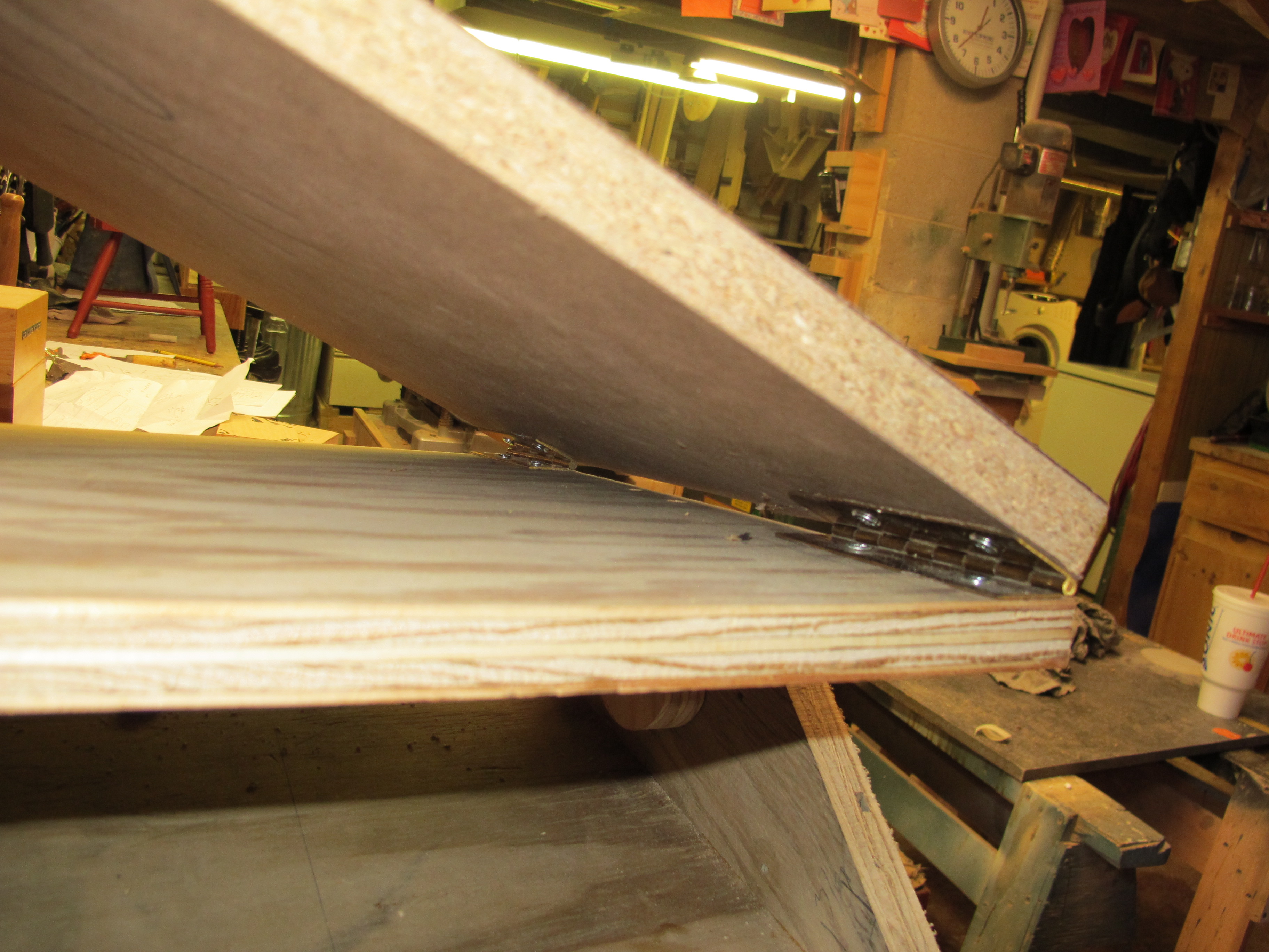

Popular Post lew Posted December 23, 2016 Popular Post Report Posted December 23, 2016 A Sine Plate jig will work for all of your chairs, as the angles will probably change between styles. With this you can set up an infinite number of compound angles. DuckSoup, John Moody, Dadio and 3 others 6 Quote
Grandpadave52 Posted December 24, 2016 Report Posted December 24, 2016 8 hours ago, John Morris said: Legs to the right, rungs in the center, and four fails on the left. "Repurpose" into hammer or chisel handles Looking good John...keep the project pictures coming...better than waiting for magazines to show up in my mail box... HARO50, John Moody and John Morris 3 Quote
John Morris Posted December 24, 2016 Author Report Posted December 24, 2016 8 hours ago, lew said: A Sine Plate jig will work for all of your chairs, as the angles will probably change between styles. Lew, I love that jig you have. I could think of many projects something like that would work well for. But, I like dedicated jigs, for one purpose only. No moving parts, and no thought needed to operate them, and I need plenty of "no thought" in my shop! Seriously though, I have learned that if I stick with dedicated jigs for one purpose, even if it's just to drill one angle, I am better off for it. Grandpadave52 and lew 2 Quote

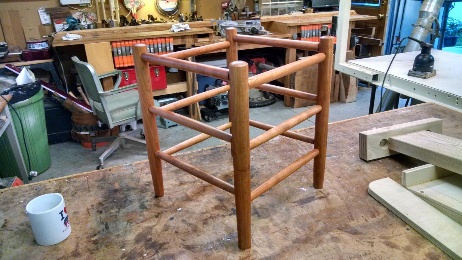

Popular Post John Morris Posted December 24, 2016 Author Popular Post Report Posted December 24, 2016 Well I got a pre glue up stool here. I am happy with it. Ready too glue now. Soon we'll have a few coats of oil on it and a tape seat Grandpadave52, HARO50, Gerald and 2 others 5 Quote
Grandpadave52 Posted December 24, 2016 Report Posted December 24, 2016 Well, as Staples used to say, "That Was Easy" Looks great so for...keep the project coming... BTW, don't forget the Maker Story tucked away in the seat weaving... HARO50 and John Morris 2 Quote
John Morris Posted December 24, 2016 Author Report Posted December 24, 2016 25 minutes ago, Grandpadave52 said: BTW, don't forget the Maker Story tucked away in the seat weaving... Thanks for the reminder Dave! I really enjoy making this, this was a really fun. I'll do another then I should be ready for a full size rocker. The only thing I am not sure about, is the shouldered tenons, they look unsightly to me, but then the originals were the same way, I guess if the Shakers didn't mind them I should not. Grandpadave52 1 Quote
Grandpadave52 Posted December 24, 2016 Report Posted December 24, 2016 1 minute ago, John Morris said: Thanks for the reminder Dave! Even more cool would be to add a copy of this thread...might have to add a little padding...but how cool in 25-50 years when someone re-webs it. John Moody, HARO50 and John Morris 3 Quote
Popular Post John Morris Posted December 30, 2016 Author Popular Post Report Posted December 30, 2016 A coat of finish, and I like it. HARO50, lew, Dadio and 2 others 5 Quote
