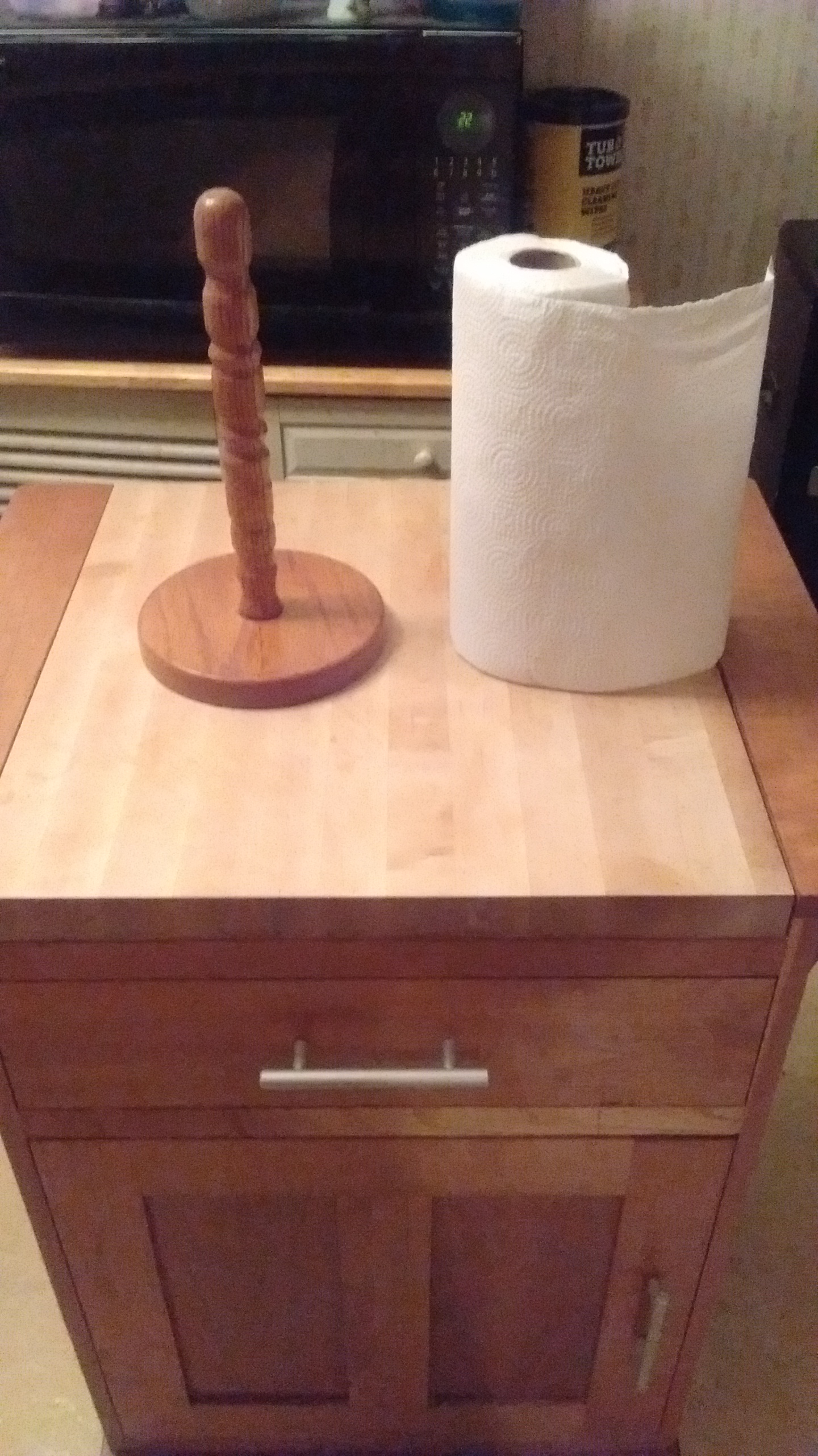

October 13, 201610 yr Author comment_78769 Thanks Steve. Your answer kind of confirms what I suspected. As for what I want to turn, I think I would like to learn bowl turning, and hollowing, such as for pepper mills, goblets, things of that nature. I actually did one piece of spindle work. I was practicing coves and beads on a piece of oak left over from a project. As I just experimented, I thought this could actually "turn" (sorry) out useful. I ended up attaching the spindle to a round base, and gave it to my wife for a paper towel stand. This is how that turned out. Edited October 13, 201610 yr by PostalTom reposition image Report
