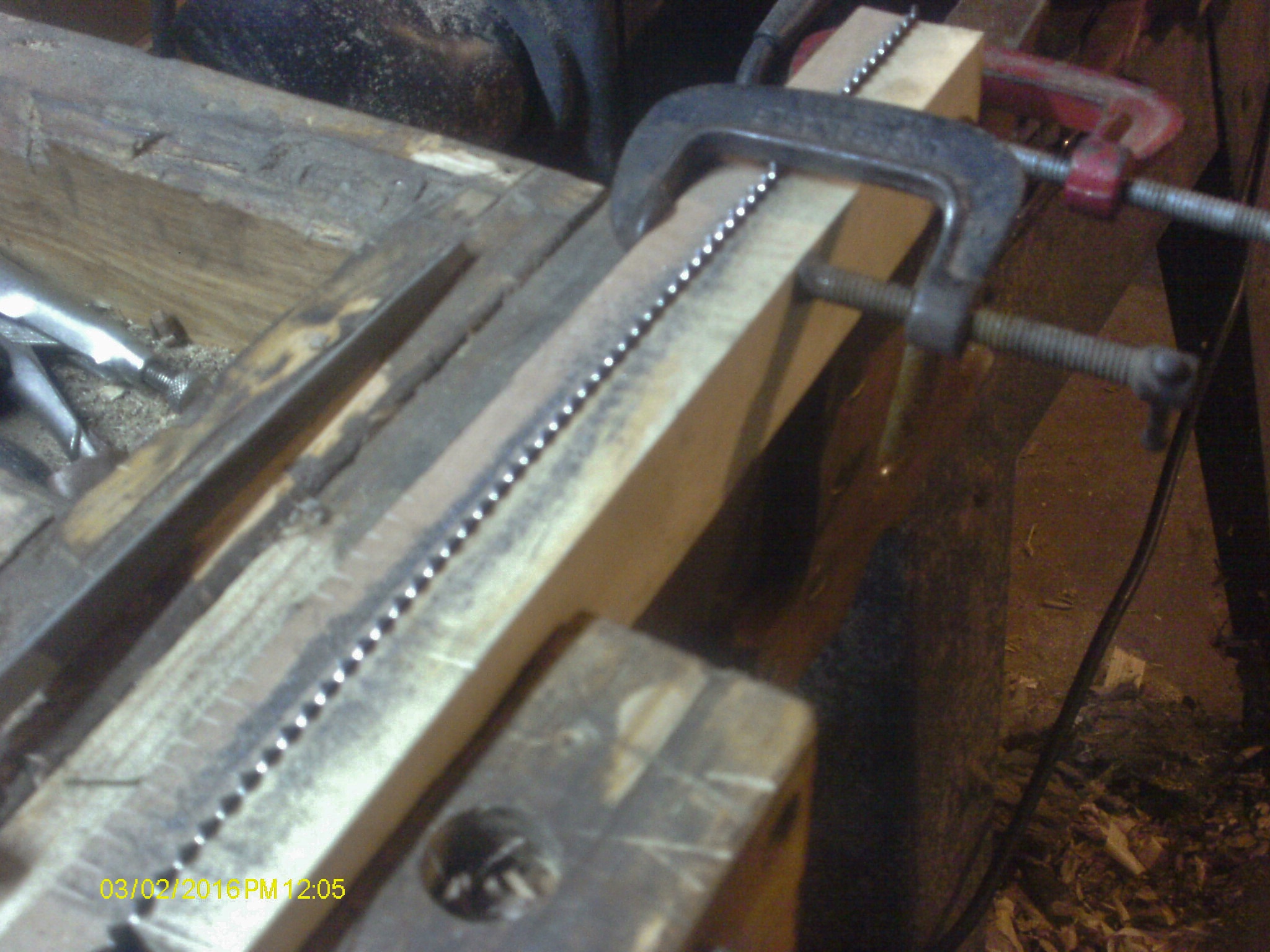

  3. steven newman
    Disston D-23 Rip saw
