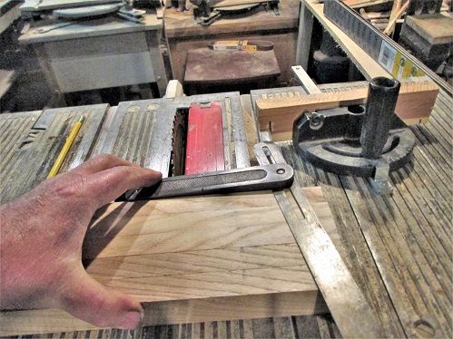

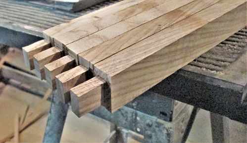

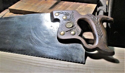

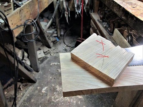

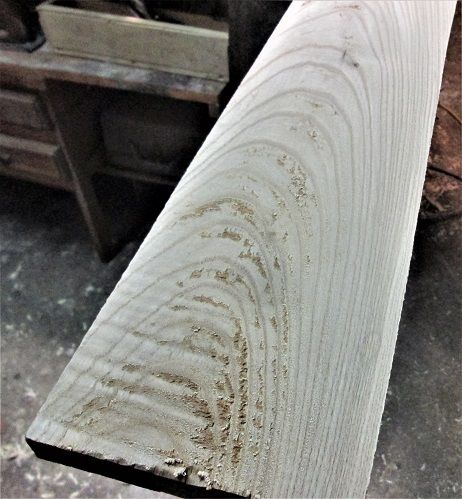

    That what my Daughter wants built. Something to hang or stand near a wall, and hold a few towels...Ooooh, Kay.. So, hauled a plank to the shop.. No room for a 7' long plank...we have ways.. Clear down on the end...handsaw is working on removing a short piece of scrap.. Was trying to do the splits. Measure from this nice, square, defect free end..about 50" more or less...Was trying to avoid.. This Problem Child...so.. Just missed it. Since I had a more manageable plank, I could use the tablesaw..instead of.. This saw....Needed to straighten out an edge first.. Then rip the remainder into 2 equal sections.. And now I have the 2 sides for the ladder. But, a ladder needs rungs, right... There were 2 boards left over in the shop, reset the rip fence a bit narrower.. A kept out the best 5 of the mess....Now, ladder sides tow in at the top, going from 18" at the bottom, to ~13" at the top..oh joy, angled tenons. First, need an angle to set to..we have ways. . About 18" later, and the other end is laid out, as well. need to set the mitre guage to that angle ( ~12 degrees) And make 10 cuts... Then laid the shoulder cuts... Had to reset things to do the other half of these..then attempt the cheek cuts.. Mitre gauge back to 90 degrees, too.. Then over to the bench, to clean up each tenon... Olde School Ways....small hammer, and a SHARP chisel... So...all 10 tenons are now done...3 hours in the shop, everything now hurts...time to stop for today Stay tuned..
