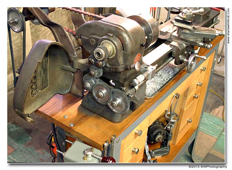

July 29, 201313 yr comment_10929 "Back From The Archives" I recently ran into some financial trouble and had to sell a couple of my machines to make a few house payments. One of them to go was my beautiful Heavy 10 South Bend lathe. It took me about a week to start having lathe withdrawals so I posted a WTB ad on the local classifieds and got several calls. I ended up getting a little Atlas 618 6" by 18" metal lathe for a hundred bucks. The lathe is in great original condition and came with a 3 jaw chuck, lantern style tool post holder, and a very nice tool post grinder that is probably worth several times what I paid for the lathe. (crappy cell phone pic) It didn't come with a stand so I took one of my Delta stands out of the rathole and used that. I added some drawers and mounted the lathe to it this weekend. The center section with the drawers slides out of the stand so I can still access the nuts and bolts used to mount the lathe and motor. The light is a 2 dollar light I got from the local thrift shop. It will work for now until I can find a nice vintage one. The drawer pulls I made out of 1/2" bolts. I cut them down so they were about a 1/2 long, faced the back side with the lathe and drilled and tapped them for a No. 10 screw. The wood is all reclaimed wood from some shelves that I took down in my shop a few years ago. I still need to add a switch and I have a quick change tool post ordered for it. Looking for a steady rest and follow rest for it if anyone has one they want to get rid of. They come up on Ebay but they are pricey.The Atlas is pretty much the same machine as the Craftsman 101 and takes the same accessories. I was worried about the lathe feeling like a little toy compared to my South Bend but overall I am very happy with the lathe. It should work fine for what I need it for. Thanks for looking, Shane Edited November 7, 20188 yr by Larry Buskirk Report

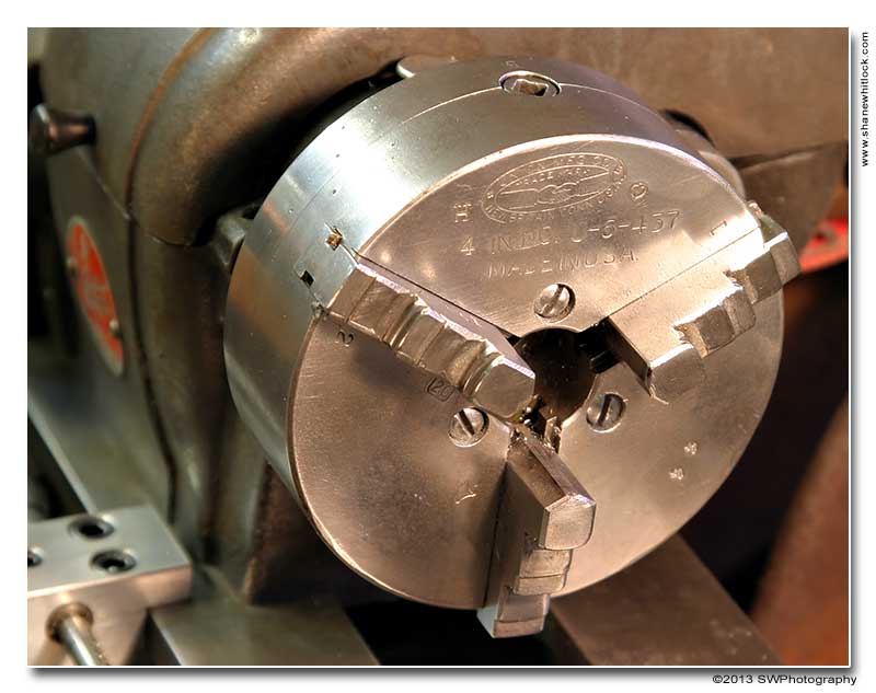

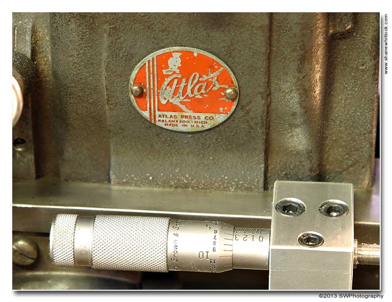

August 9, 201313 yr Author comment_10935 Hi Guys. Thanks for the comments. Sorry for being so slow getting back to ya. I have been using this little lathe quite a bit since I got it and so far I am pretty impressed with it. I needed to make a spindle sleeve for a DP that I am restoring so I needed to pick up a steady rest for the lathe. I found a NOS steady rest and follow rest on Ebay for a great price. They were Craftsman blue so I painted them gray. I also found a nice drum switch and mounted that on the left side of the stand. Picture shows rare earth magnets used to hold the wrenches in place. I made a micrometer carriage stop out of an old micrometer and some aluminum that I had. The Atlas badge on the head stock. A few more misc. pics: Gears for threading and carriage feed. I need to pick up a few more gears for threading but the darn things are pricey. Threading chart. 4 inch 3 jaw Union Mfg. Co. chuck. No. 0 Jacobs chuck with MT1 shaft A2Z quick change tool post Atlas motor badge. The compound rest guard was busted on the lathe so rather than replacing it I cut it shorter and used it to hold down a piece of neoprene. The neoprene still keeps swarf from getting into the threads and when I want to use the tool post grinder or follow rest, which both mount on the compound, I can just flip the neoprene up out of the way instead of removing the guard, which is what you normally would have to do. One last shot. So far I haven't done anything to the lathe, other than clean and lubricate it. I am still trying to decide if I should do a full restoration on it. It's in pretty nice shape so I will probably just leave it as-is ... At least until I get bored on weekend and tear it apart. Thanks for looking, Shane Edited November 3, 20188 yr by Larry Buskirk Report
