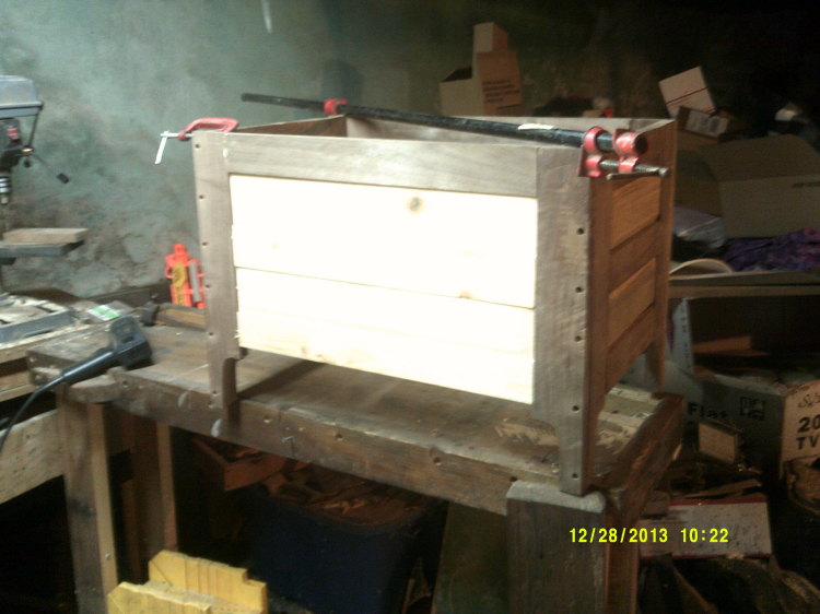

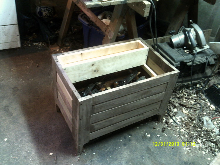

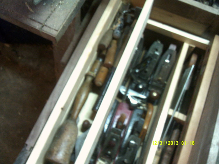

February 18, 201412 yr comment_4956 IF I can get this camera-ooski to upload a few photos, looks like it might work. Seems I have a duplicate shot. Just a Walnut & Pine Tool Box. Filling up fast, too Report

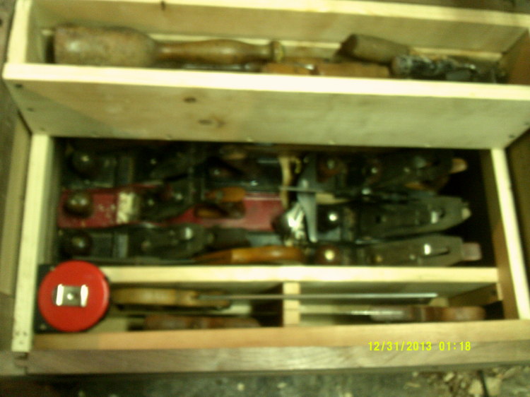

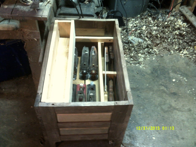

February 18, 201412 yr Author comment_4965 Think there is room for one more tray? Only a third of the Hand Planes made it into the chest. May have to build a til for them?? Report

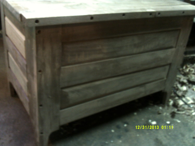

February 18, 201412 yr comment_4963 Sweet! Looks like all the family is snuggled warm in their beds!! Report

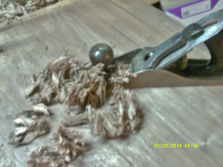

February 19, 201412 yr Author comment_4961 If one looks close enough, they will see some raised panels in the sides. I use Paul Sellers idea of using just a handplane to raise all the panels.There is also a rebate on the back of each panel, so the raised panel can fit in the grooves better. Rebate was also done with a plane. A WARDS #78 rabbet plane (made by Stanley) was set to cut just the rebate, on all four edges. Added a Walnut strip to the edge of the lid. Seven screws hold two pieces of scrap Walnut. Had to size the two chunks down to match the lid. Why two? Didn't have anything long enough in a single chunk.. And, Mister Morris, The shop is called.....The Dungeon Shop. I did have to fire Igor, though. He just wouldn't keep the place swept clean... Report

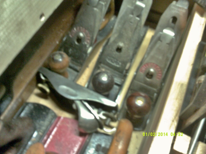

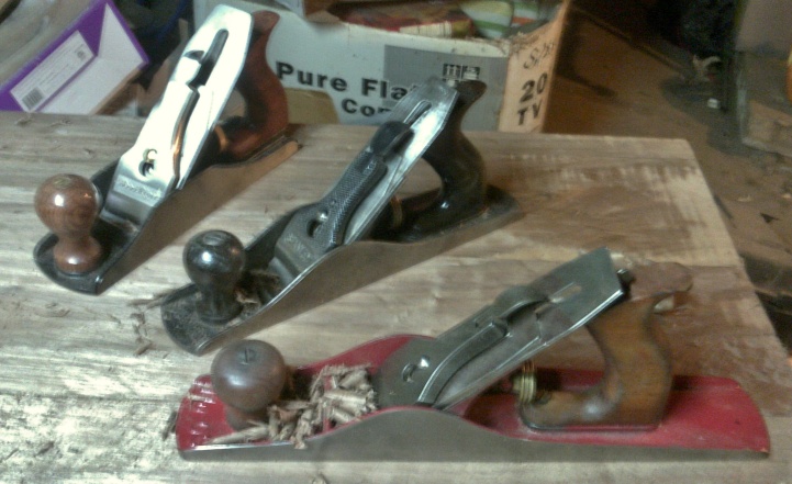

February 21, 201412 yr Author comment_4957 going to try to get that lid flat(er) sometime maybe ONE of these will work? The one in the middle might one of the few actual Stanley bench planes I have. A Stanley "Four Square" Junior Jack 5-1/4, with the SW trademark. Makes a nice #3 sized jack plane. As for the Millers Falls smooth planes They seemed to have found a hidding place. The "Dunlap" was also made by Millers Falls. The little block plane was made by Stanley for Great Neck Tool Co. Other than the "Great Neck" cast into the toe, it IS a Stanley 9-1/2. Might get the counter bores filled in, since I went out tonight and BOUGHT some plugs. I USED to have a plug cutter, but it went MIA during the last move. It was even a tapered plug cutter. Got some poly gloss to spread on the wood, and a couple brushes. Report
