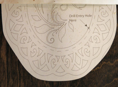

Without going into all the basics of choosing the wood, sanding, prep work, affixing the pattern, assume we have already done it. (Because this is a purchased pattern, I will not include all of the pattern here.) What I want you to notice is the "X" marked on the pattern and marked "Drill Entry Hole Here" Why there, you ask???? That is the point that we will start making our frame. The figure in the middle is going to be recessed by 1/4 to 3/8" around this line. Outside of this line will be the frame.

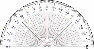

Depending on the size of the blade you use, you will change the angle from 2 to 5 degrees. I know that we are talking about very small changes - - - - soooooooooooooooooooooo - - - - - the image below is that of a protractor. Feel free to copy this image or download your own by searching "protractor image" in your favorite search engine.
ning-protractor-3433-82.jpgWhen printing this image you change its size to suit. After printing, I glued mine onto scrap, and cut the outside. Be certain that the bottom of the image is flush with the bottom of your scrap.

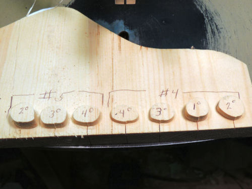

The next step that I personally recommend is to use a piece of scrap and cut some test areas as shown below. I label each area with the amount of angle on the blade. Also notice that I labeled the size of the blade. (OK, I mislabeled the #3 blade as #4). This seems to help me choose the amount of angle and size of blade by actually showing me how far the cut piece will move.

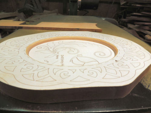

When you are finished, test fit the center by inserting it into the frame from the top. It should be something like the picture below.

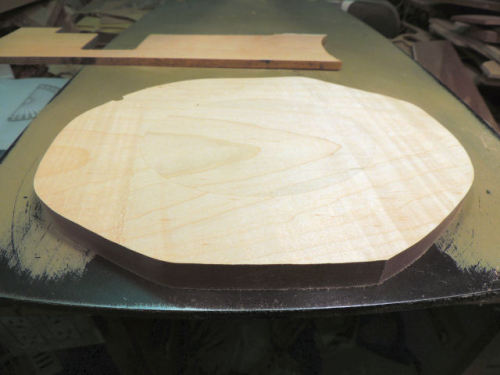

If all looks good, go ahead and glue the pieces together. Allow at least 8 hours to dry. After you are sure the pieces are cured, it's time for the next step. Using a carrier board, it is time to plane the back side. This step is not mandatory but I like to use it - makes for a more finished piece on the back side. (Shown in the picture below)

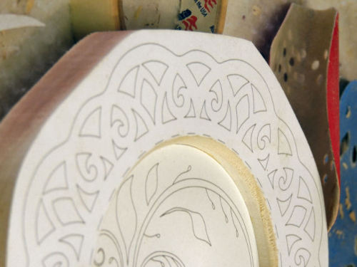

Another thing that I will do at this time, because I have some nice firm wood to work with, is to route a 1/4" round-over around the inside of the frame. You can almost see that in the picture below

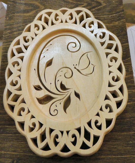

OK - now it's time to cut out everything starting with the inside and working out to the frame. Below is what I ended up with. Notice that I also put a 1/4" round-over around the entire frame.

I enjoy self framing projects, I have a few of them I do. But, I do like the tips on planing the back of the center piece and the small round over areas. Great tips!

My take on it - not gospel of course - when cutting the bevel, I am never exactly sure how far the center will extrude out the back of the frame. Hence, that is the reason I glue then plane - I will be absolutely sure that I will have a smooth back (a lot of times you can not even see the cut on the back side).

Got it now. It would be interesting for you to cut out the whole then, glue it up, then plane it. In my experience, when I have done that, the pieces start flying out of the planer. Tears up my hard work. And that, my friend, is why I started gluing them up before I start doing the fret work. Whatcha think, gang????
