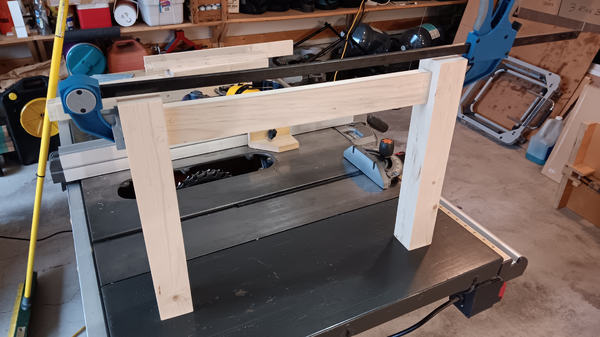

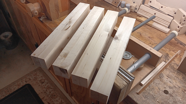

I started by laminating some 1 x Pine stock and milling it to make these four legs.
Then I used my #4 Round Moulding plane to radius the four edges on each leg. Next, I mortised all 4 openings on each leg for the rails.
This was done with my mortise chisels. It was a lot of work but turned out beautiful. They are 1 “ deep.

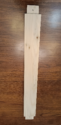

Then I cut and milled up all the rails as shown. I squared up each one by hand planing. I made the tenons at both ends for each rail.
I did a test fit for each leg with its rails. Looking good so far!

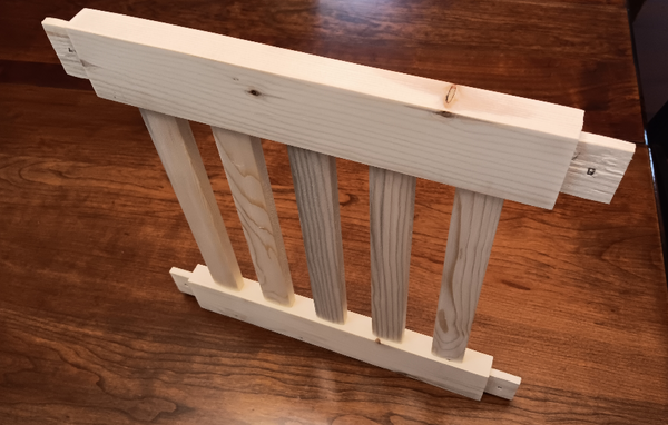

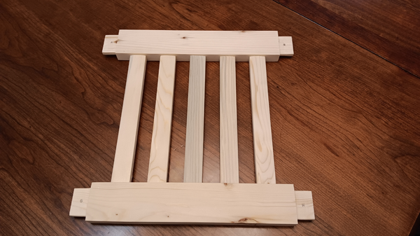

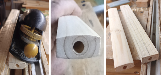

On two sides of the stool there will be small “pillowed” stiles connecting to top and bottom rails. Here I show these stiles cut, squared, and center lines marked for doweling.
Using my centering doweling jig, I then place each stile in and drill on center on the top and bottom of each one for 1/4” dowels.
Pillowing
Next, I begin “pillowing” each stile on both sides. I start by using an ellipse template and mark each end with the arcs I want for pillowing. Then I pencil hatch the faces that will be hand planed to the arcs on both ends. As the hatch marks disappear I can tell what has been planed.
Below in the left photo you see the planing begin. In the mid photo you see the finished pillowing. The last photo shows before and after pillowing.
Now, the side rails are drilled for assembly of the stiles. The stiles are then glued into place. Here are the finished sides.

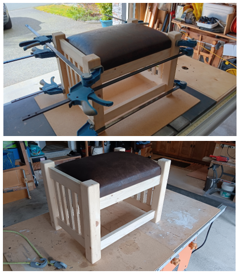

Now I do a dry fit to test how everything fits before glue up. A piece of ¾” prefinished Baltic Birch plywood is cut for the bottom and the cushion is cut to match the plywood perimeter.
So far everything is looking good!

Here's a dry fit with and without clamps. The finished upholstered cushion was a little tight assembling into the frame but luckily there was enough clearance. I learned a lot doing this upholstery. It's looking good.

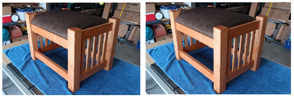

Again I did another dry fit. Here, I assembled all the finished parts again, lightly clamped up, and checked for any improvements that may be needed.
Some very minor cosmetic issues were addressed. Next I disassembled all parts. I then applied glue to all mortise and tenon joints, re-assembled, and clamped. I cleaned up any glue squeeze out which was pretty much none. I left it overnight.
This is the end result.
