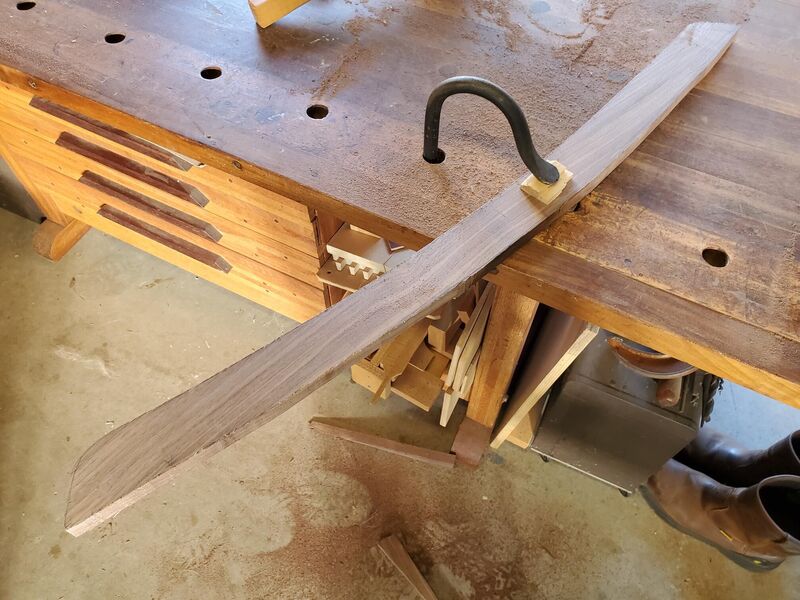

I used a portion of my Shaker Rocker template for the end outline and with a bendy board I created the bottom and top rocker line and drew it out, then jigsawed just to the line.
I worked on one rocker for now, I got it perfect, shaved it right down to the line and cleaned up any imperfections from the jigsaw.

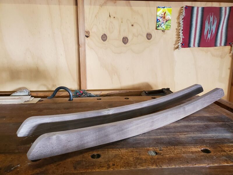

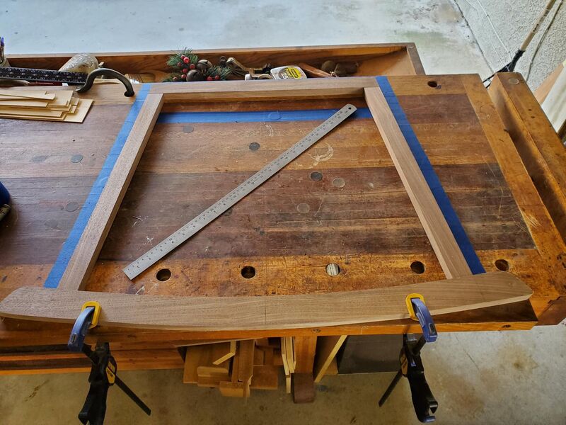

I used the first rocker to draw the second rocker out and cut it, then ganged the two up and planed them together.
And here we have two identical rockers. While I was gang planing the rockers (above) with my shave, it didn't even occur to me to keep an eye on square so the top and bottom rocker edges are square to the sides, it really matters! And I didn't catch myself till half way through cleaning them up, I said to self "CRUD!". No doubt the edges are slanted or whacked or something, so I set my square up on the edges, and all be doggone danged, they were square! Even a blind squirrel finds a nut right?

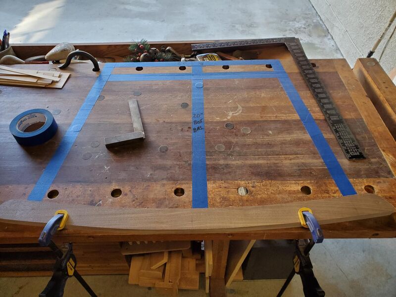

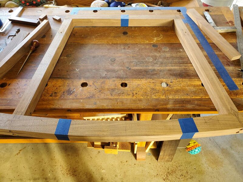

The whole reason I had to get the rockers made first is this was the way in my head to get it right so the bottom cleats of the basket would meet the cross members, I know it looks really easy, but man, for some reason I was scratching my head, it really helped to get it laid out on the bench life size.
Once I got it all laid out I cut up the parts and laid them down. Then I cut an identical set for the opposite side.

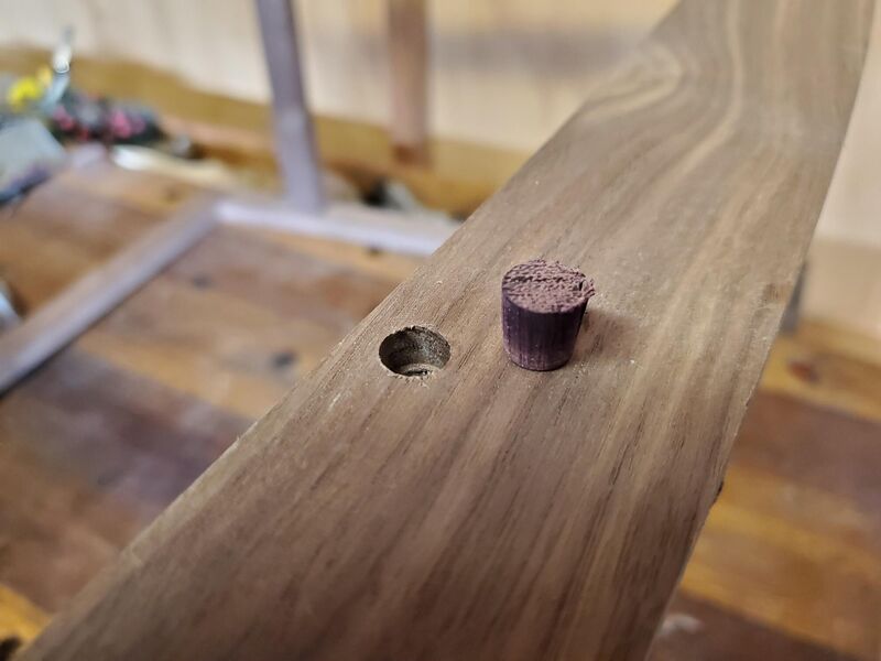

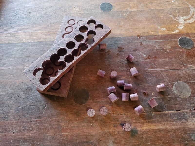

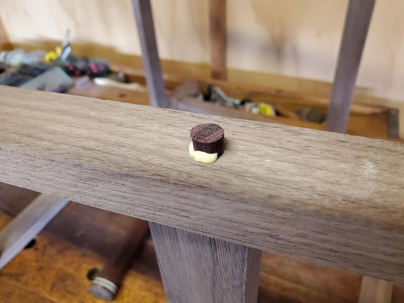

I'm gluing and screwing everything together, so I cut some plugs from some scrap whatever I had laying around, I can't remember what this wood is called, it's an exotic, I had a chunk of old Ebony (African Black Wood) for the longest time that I used to cut plugs from, but it finally wore out and I couldn't get anymore plugs out of it.
These tapered plugs will fill the counter sunk screw holes.

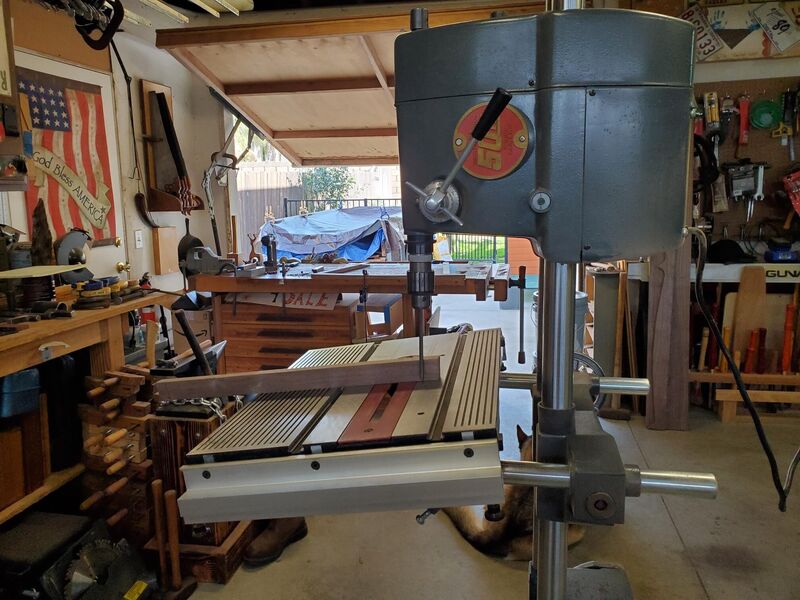

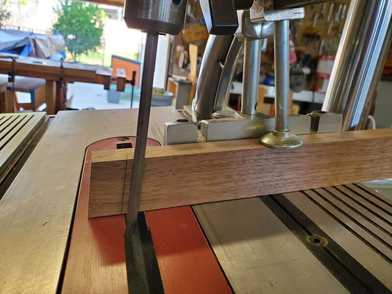

Another day, I took the two top rails of the assembly and marked for the screw pilot holes, they are slanted so I took to my ShopSmith Drill Press and matched the angle with the tilted table, this is where this drill press really shines, not only does the table have a great built in tilt function, but the table carriage also cranks in and away from the machine, and the variable speeds on the fly.
I just grabbed the nearest item that was long and skinny to chuck up and set the tilt of the table to my guideline. Then chucked up a bit and drilled away.

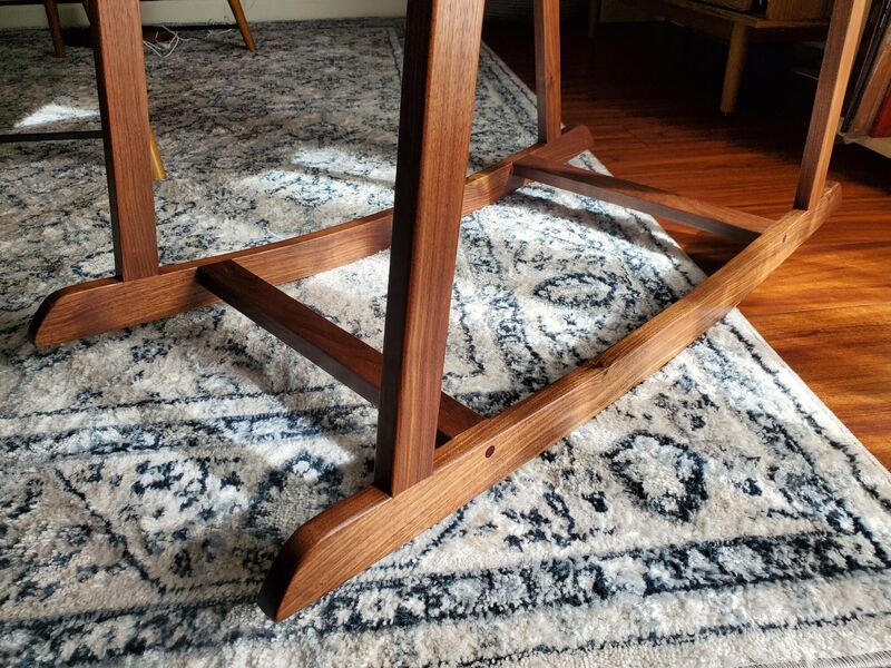

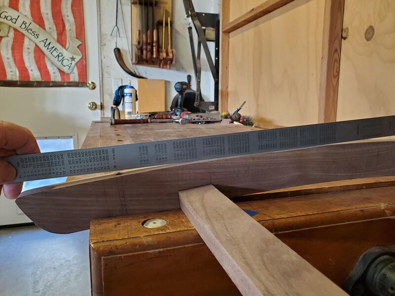

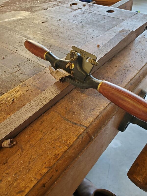

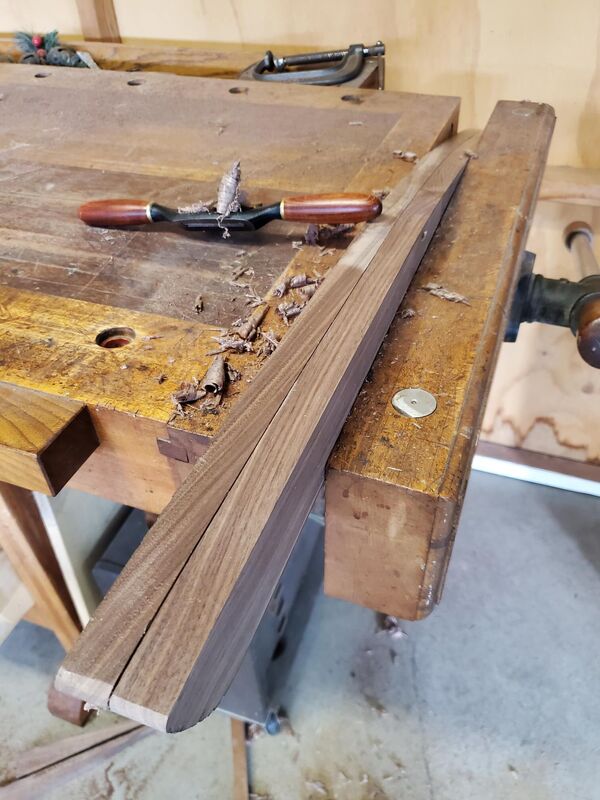

After I got it all glued screwed and tattooed, I set her on the ground and rocked it back n forth, and felt a flat spot in the rocker. I set it in my vise and set a straight edge down the bottom of the rockers, and sure nuff, you can see about 4" of flat. So I got the spoke shave out and took out the points before and after the flat and it was resolved, I had to do this for both rockers since both rockers were patterned.
For some reason this is so satisfying to me, inserting my home made tapered plugs into the screw holes, I don't know why, it just is.

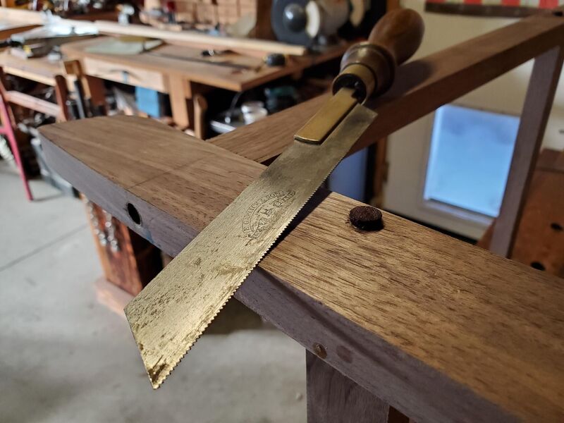

I used my flush cutting saw to take them down to the surface. You gotta be careful, there is a tendency to attack these plugs with this saw from one side only. You should score a cut line all the way around, then approach the cut from both sides of the plug. If you finish the cut from one side all the way through. on the outcut, you'll take some splinters of the plug with the final draw and along with that you'll leave a gaping tearout in the side of the plug that extends below the surface.

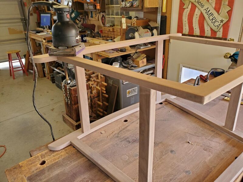

Once I got all the plugs set and trimmed, I sanded with my ROS at 80 grit to get it evened out and uniform. Then from 120 up to 320, I stopped there.

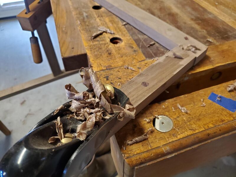

So, as I stated, I'm still getting my water wings on, and I forgot that while sanding around the harder wood specie plugs, the surrounding wood (walnut) is going to sand out quicker than the exotic wood end grain of the plugs, after sanding for some time, I started noticing the plugs were rising higher than the walnut.
The only way I could fix it is to plane the plug area flat and start over in the sanding for those areas. While planing the plugs flat again, I realized how easier it would have been to trim the plugs down with my block plane to begin with, the flush cutting saw in very hardwood plugs, takes a bit of time.

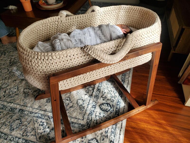

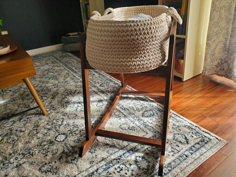

The rocking stand was delivered today, and it fit perfectly and our kids loved it. 😊 The final coat finally dried and I was able to buff it with #0000 steel wool and wax, the sheen really evened out nicely after final buffing. We had Mass at 10am, then immediately after Mass we headed to our daughters, so I only had a little bit before we left for church to finish the finish, I sat in front of the TV this morning watching my Sunday news shows, with a towel laid out over the carpet, and the stand on top as I buffed away, just in time to get in my Sunday best! It really was right down to the wire.
Bassinet in its stand at our daughter and son n law's home.
The basket looks lovely in the stand.
Little Everett, our grandson.
An adoring grandma (my lovely wife).
And that's a wrap folks! Thanks for following me along with this special project, and your support as I find my way back into the woodshop, after a long hiatus. ❤️
