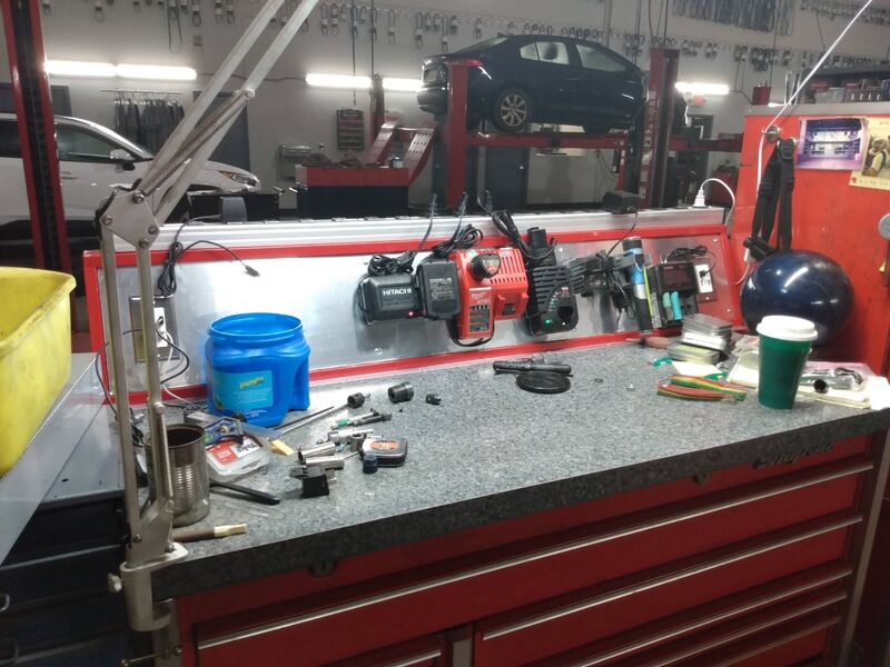

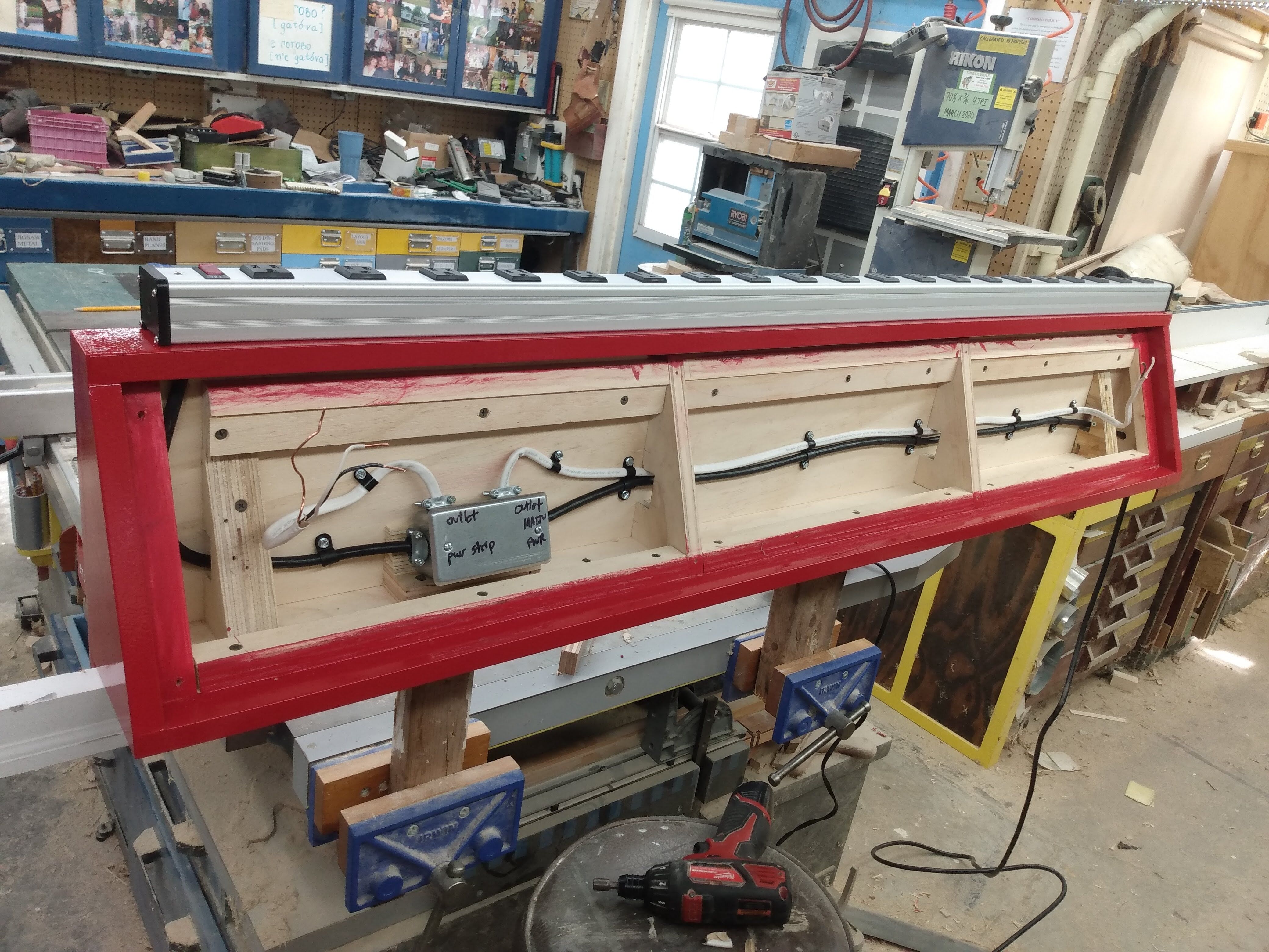

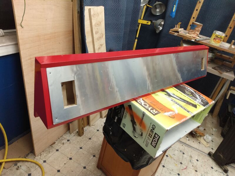

Popular Post Gunny Posted November 1 Popular Post Report Posted November 1 Unlike many in my industry I do not like tying up a drawer in my box with charging stations. Considering how many different chargers a drawer is just not good use of precious drawer space. The top of my box however, it is fair game. Developed this to handle all my charging needs plus room to grow as more are needed. Made from plywood edge banded with pine. Fo the face I used roofing tin gluing it down with contact cement. A nice addition to the shop. Gets cut off by main power switch each night so no batteries charging when I am not there. Can't forget it, my overhead light is in the mix so I would see the light on before I close up shop each night. steven newman, Headhunter, Fred W. Hargis Jr and 5 others 8 Quote
Popular Post Fred W. Hargis Jr Posted November 1 Popular Post Report Posted November 1 (edited) Nice, but where in the world did you find a power strip that long???? (I live a very sheltered life.) Edited November 1 by Fred W. Hargis Jr lew, Grandpadave52, steven newman and 4 others 2 4 1 Quote
Wichman3 Posted November 1 Report Posted November 1 (edited) Very nice setup. How did you attach the chargers to the base? https://www.amazon.com/gp/aw/d/B0D3LPHSBF/?_encoding=UTF8&pd_rd_plhdr=t&aaxitk=cecda4304df685fa134954818dd0f79b&hsa_cr_id=0&qid=1762026827&sr=1-1-9e67e56a-6f64-441f-a281-df67fc737124&ref_=sbx_s_sparkle_sbtcd_asin_0_title&pd_rd_w=KSujI&content-id=amzn1.sym.9f2b2b9e-47e9-4764-a4dc-2be2f6fca36d%3Aamzn1.sym.9f2b2b9e-47e9-4764-a4dc-2be2f6fca36d&pf_rd_p=9f2b2b9e-47e9-4764-a4dc-2be2f6fca36d&pf_rd_r=357AJ8PXYRJAMY49SK5H&pd_rd_wg=NWqNQ&pd_rd_r=c51a93d4-771f-4086-ba73-cee922c05025&th=1 Edited November 1 by Wichman3 Grandpadave52, Gunny, steven newman and 1 other 3 1 Quote
Popular Post Gunny Posted November 1 Author Popular Post Report Posted November 1 3 minutes ago, Fred W. Hargis Jr said: Nice, but where in the world did you find a power strip that long???? Amazon, took me awhile to find one with the most outlets. Had to remove the original cheap factory fuse / switch with a 30 amp one. Grandpadave52, Gerald, Headhunter and 2 others 4 1 Quote
Gunny Posted November 1 Author Report Posted November 1 1 minute ago, Wichman3 said: How did you attach the chargers to the base? Most of them had mounting holes in the back. One I had to take apart and attach brackets to the outside to mount. steven newman, Grandpadave52, 4DThinker and 1 other 4 Quote
aaronc Posted November 1 Report Posted November 1 Well done. I'm also interested in that bench light. I have one of similar design on my carving bench but not near as beefy looking and I doubt as bright. steven newman, lew, Grandpadave52 and 1 other 4 Quote
Popular Post Gunny Posted November 1 Author Popular Post Report Posted November 1 I have two, one is an articulated light I got from Amazon. Has magnifying glass, as seen in picture. Not shown is a 4 ft LED light on a bracket above my main toolbox that has an arm that extends over my lower box. Extremely bright. I'll post a picture next week of that lights base and arm. lew, steven newman, Grandpadave52 and 2 others 5 Quote
Popular Post Grandpadave52 Posted November 1 Popular Post Report Posted November 1 Nicely thought out and put together Gunny. I like the look with the aluminum flashing. lew, steven newman, Gunny and 2 others 5 Quote
lew Posted November 1 Report Posted November 1 That long electrical plug strip really caught my attention, too! really awesome setup, Gunny. Gerald, Gunny, steven newman and 1 other 3 1 Quote
Grandpadave52 Posted November 2 Report Posted November 2 Not quite as long but another source for similar power strips. Go H-F 12 Outlet Power Strip Handfoolery, steven newman, Gunny and 1 other 4 Quote
