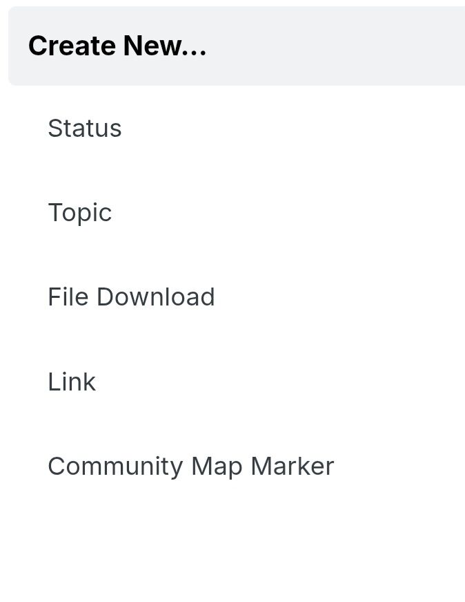

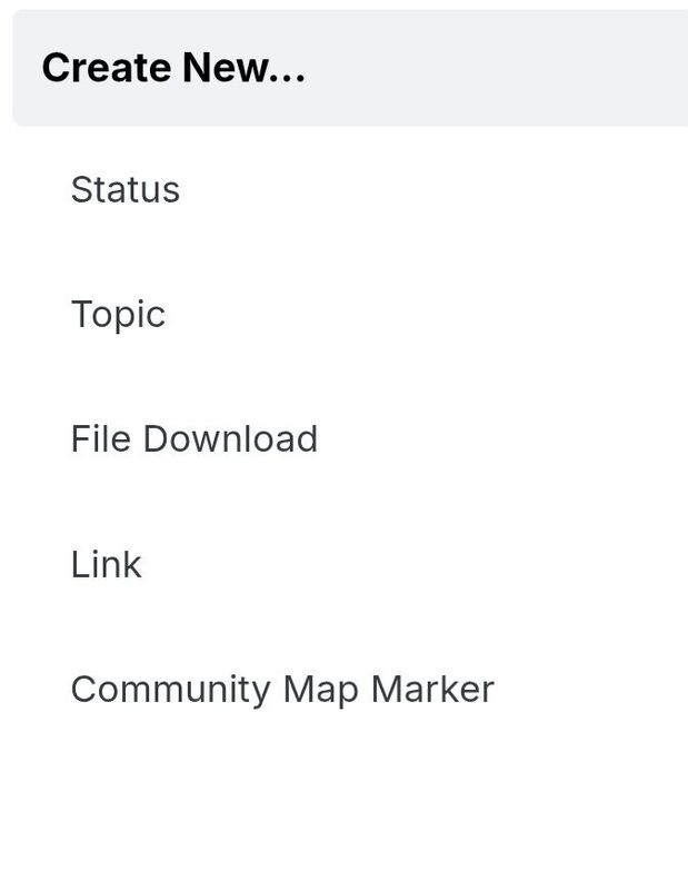

Hmmm...I'm not understanding how I can mark this for future reference?
When I hit the "+" this is what pops up for me
Me neither!
Phone
