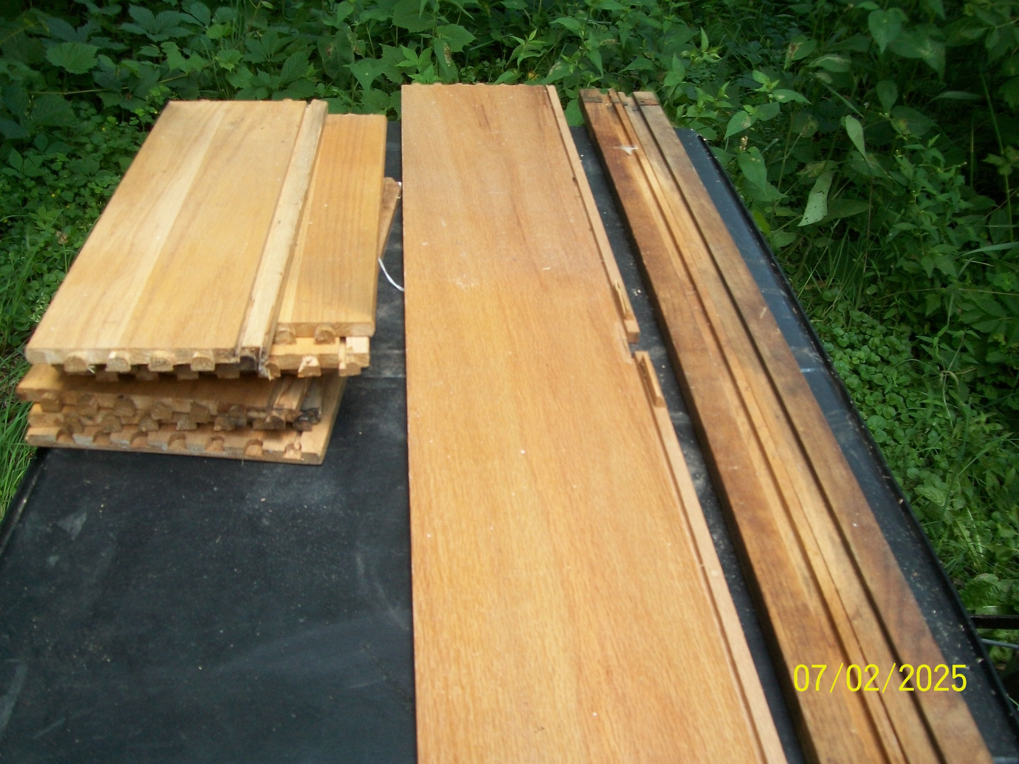

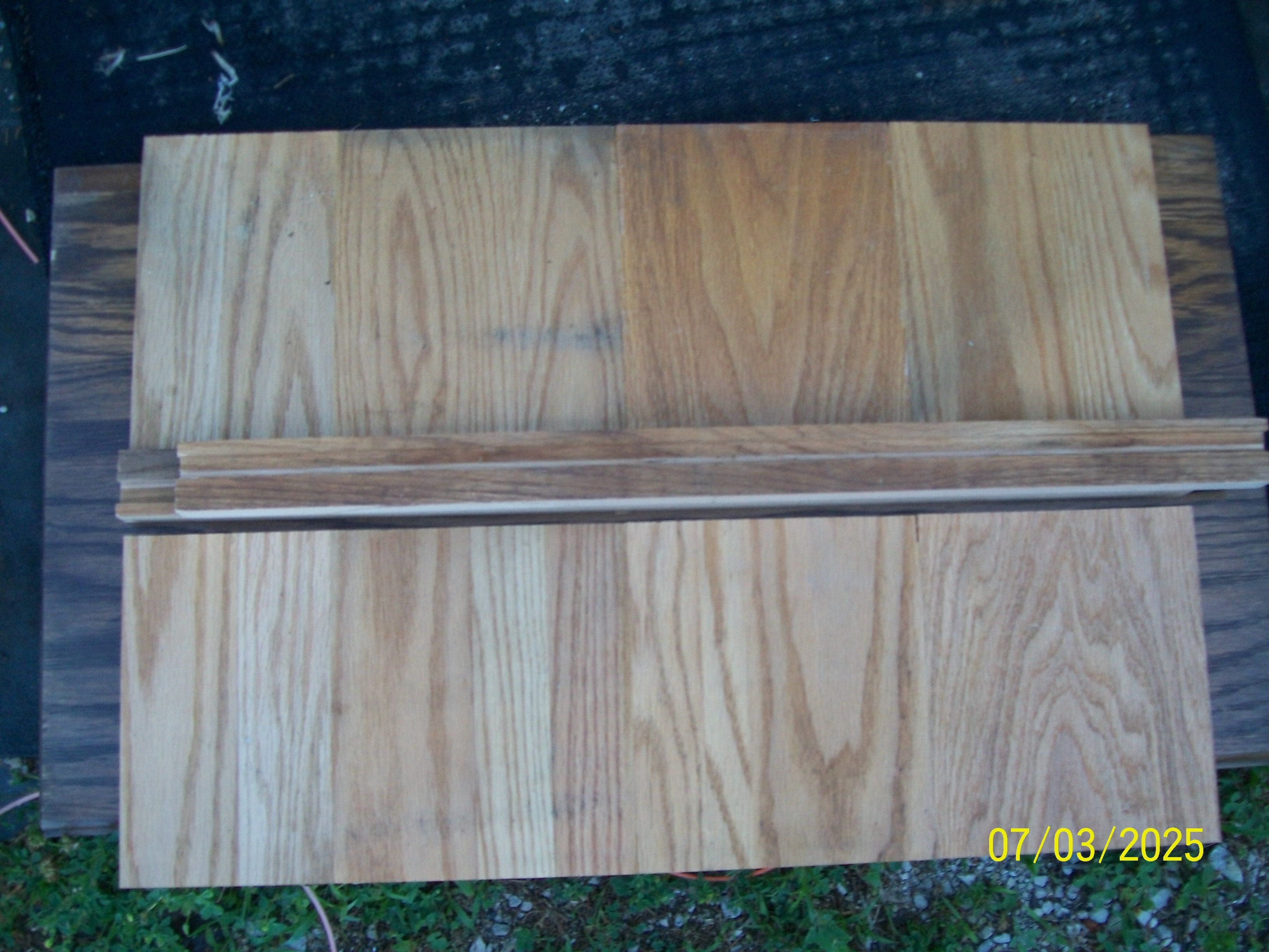

July 3, 20251 yr Author comment_358364 Looks a bit different than @steven newman wood stash. Since the drawer sides weren't long enough to run the grain horizontally,... I decided to run the two side panels vertically. The long drawer front will become the front of the cabinet tilt top. Report

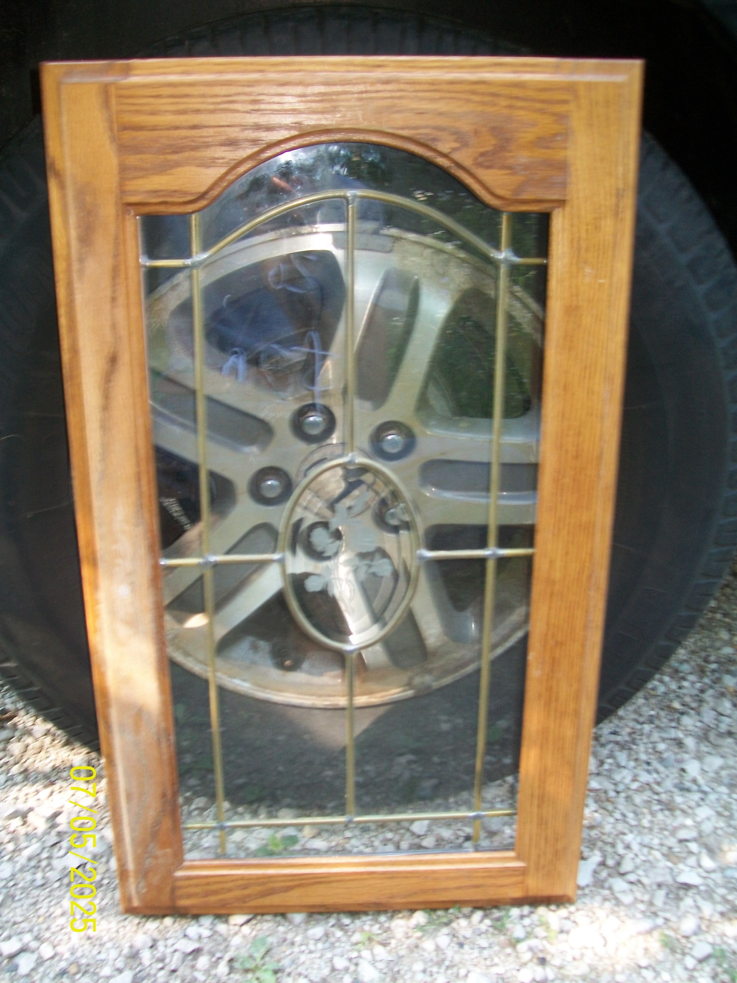

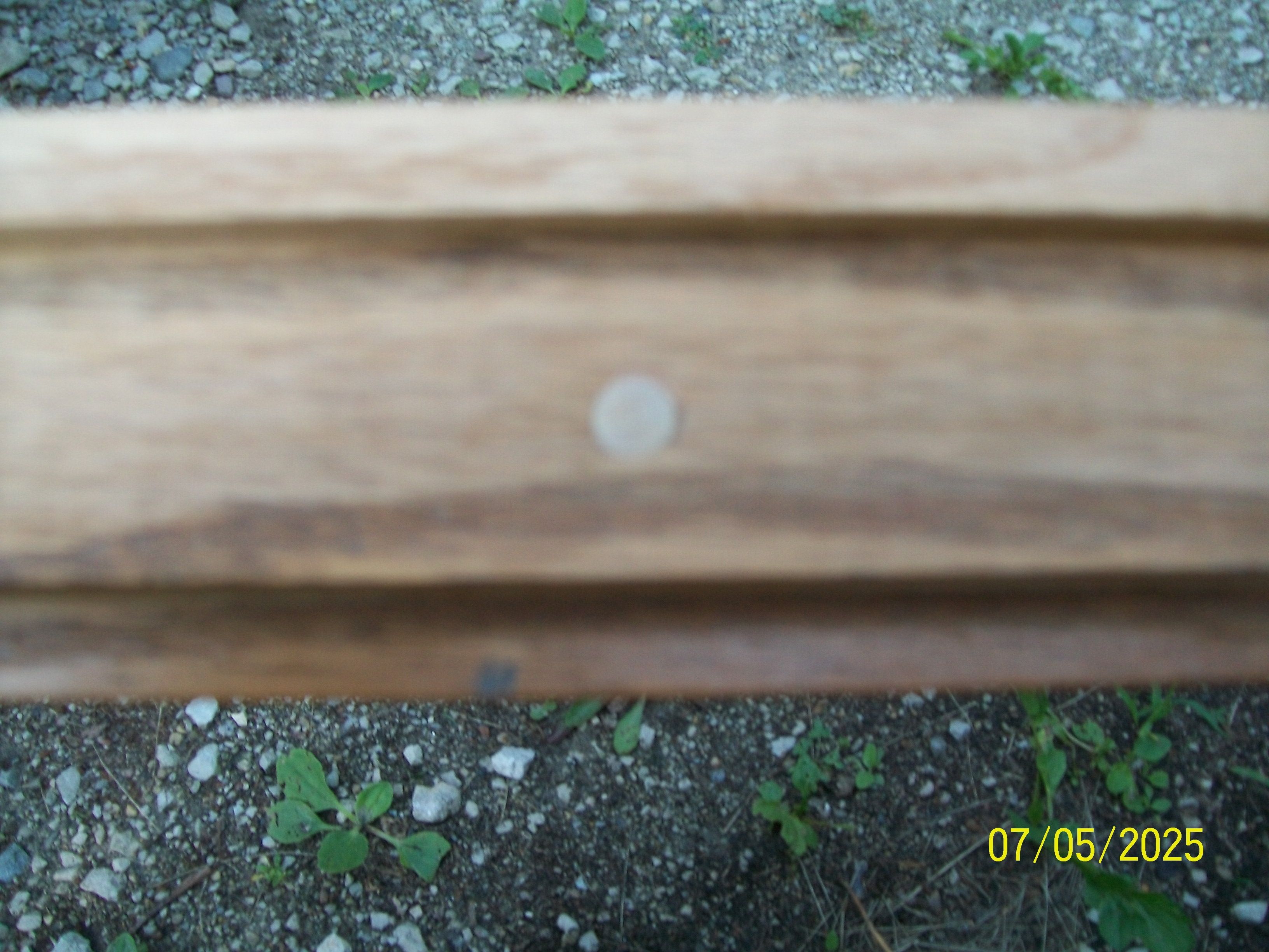

July 5, 20251 yr Author comment_358484 I have to quit looking around Bruces store. Found this while just looking around. It's the perfect width and height if I use a 3/4" filler below the door for a ledge to set it on which I've already cut out. Due to the door being hinged for the wrong side, and also being that I'll be using it for an overlay of the server cabinets door I removed the hinges, and knob. I needed to build out the back edge of the door to clear the mounting clips for the leaded glass insert and plug the knob hole. I'll be securing this door overlay to the glass of the server cabinet door using Velcro strips to facilitate cleaning when necessary. Adding this tones down the industrial look of the server cabinet but will require a slight re-working of the monitor/keyboard tray assembly. Not quite liking the vertical grain glued up panels. May switch to using a stack of thin Oak veneer plywood drawer bottom panels and Mouldings to lighten up what's turning out to be a bit heavier than I anticipated. Report

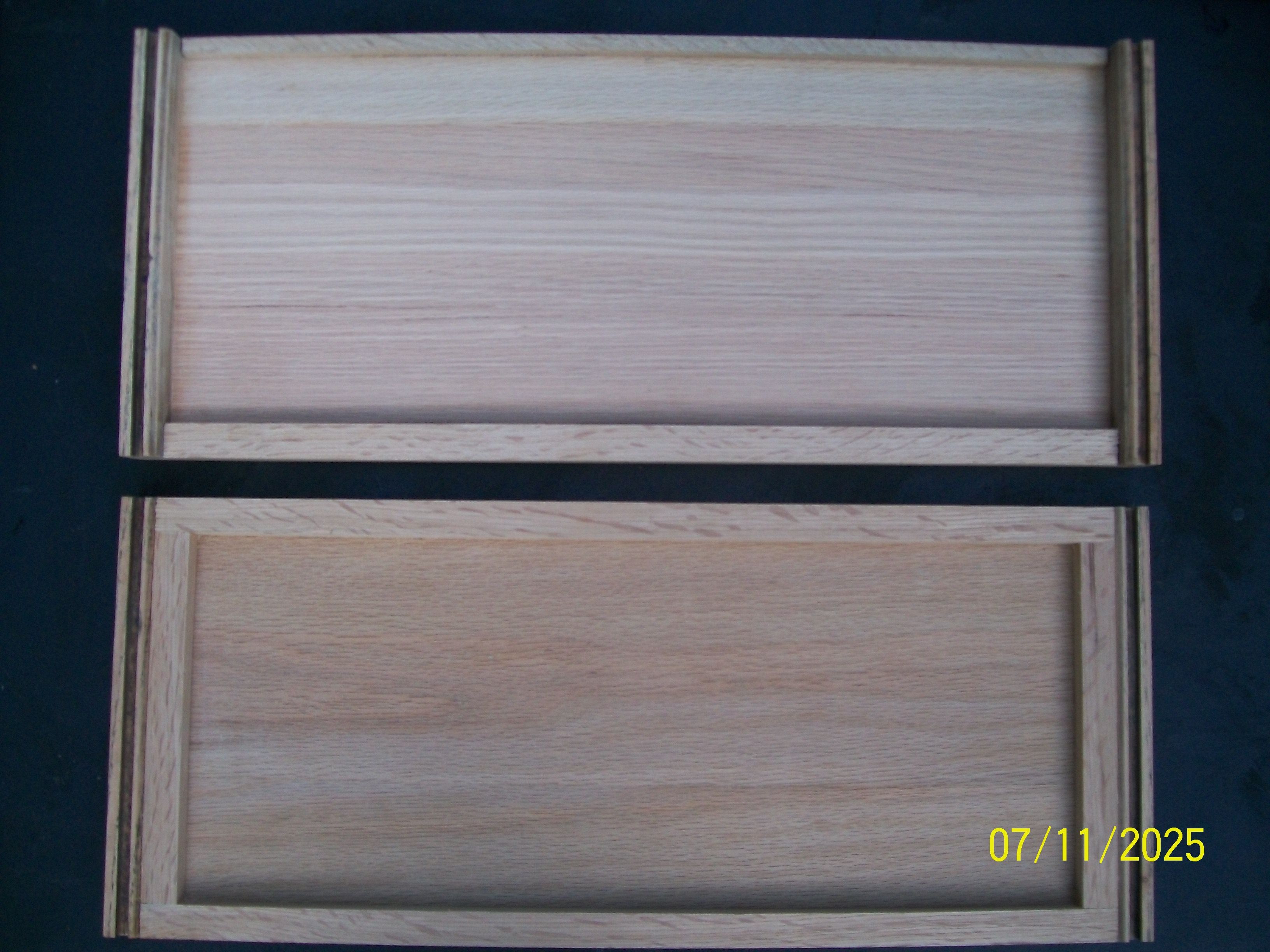

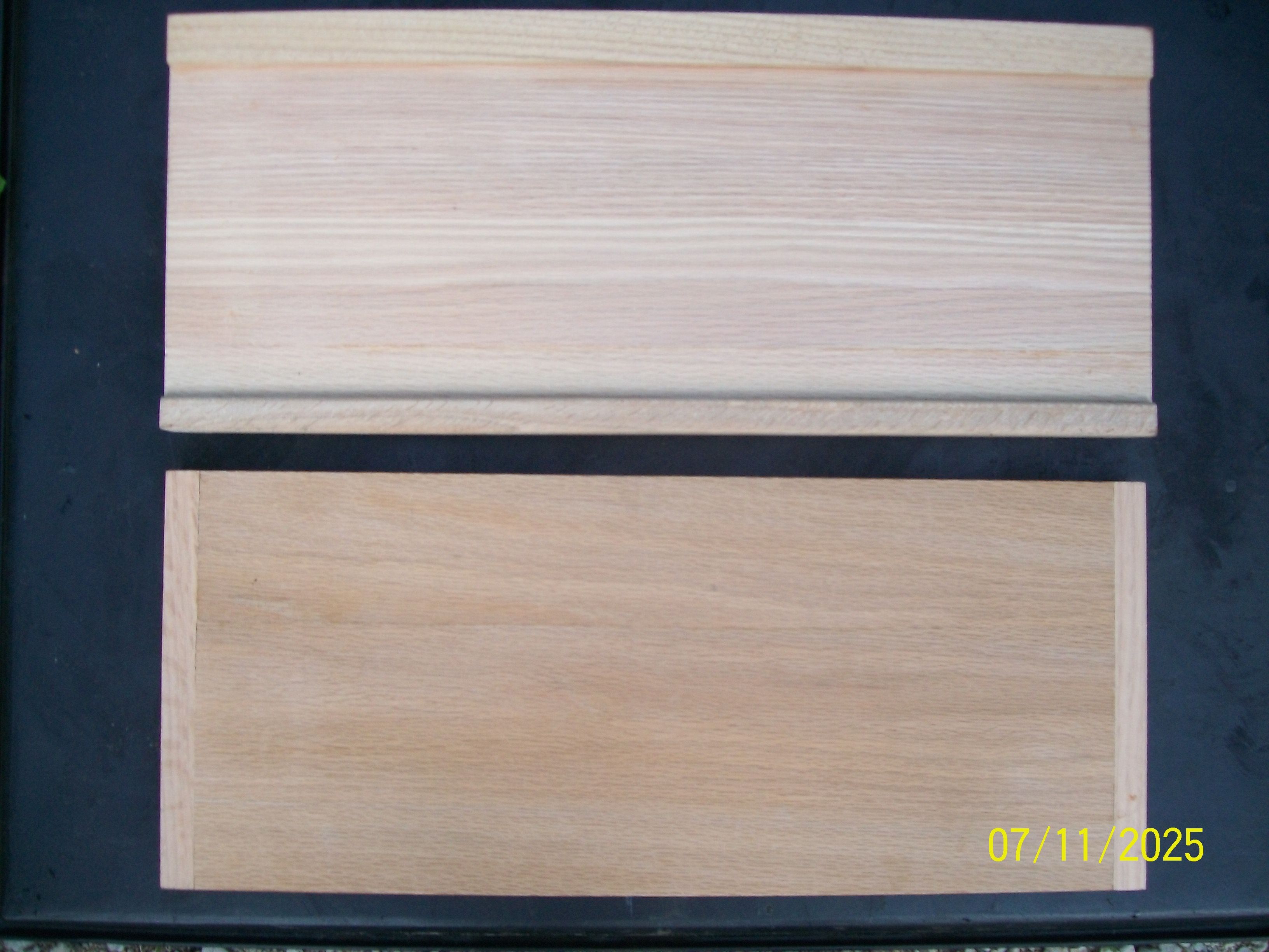

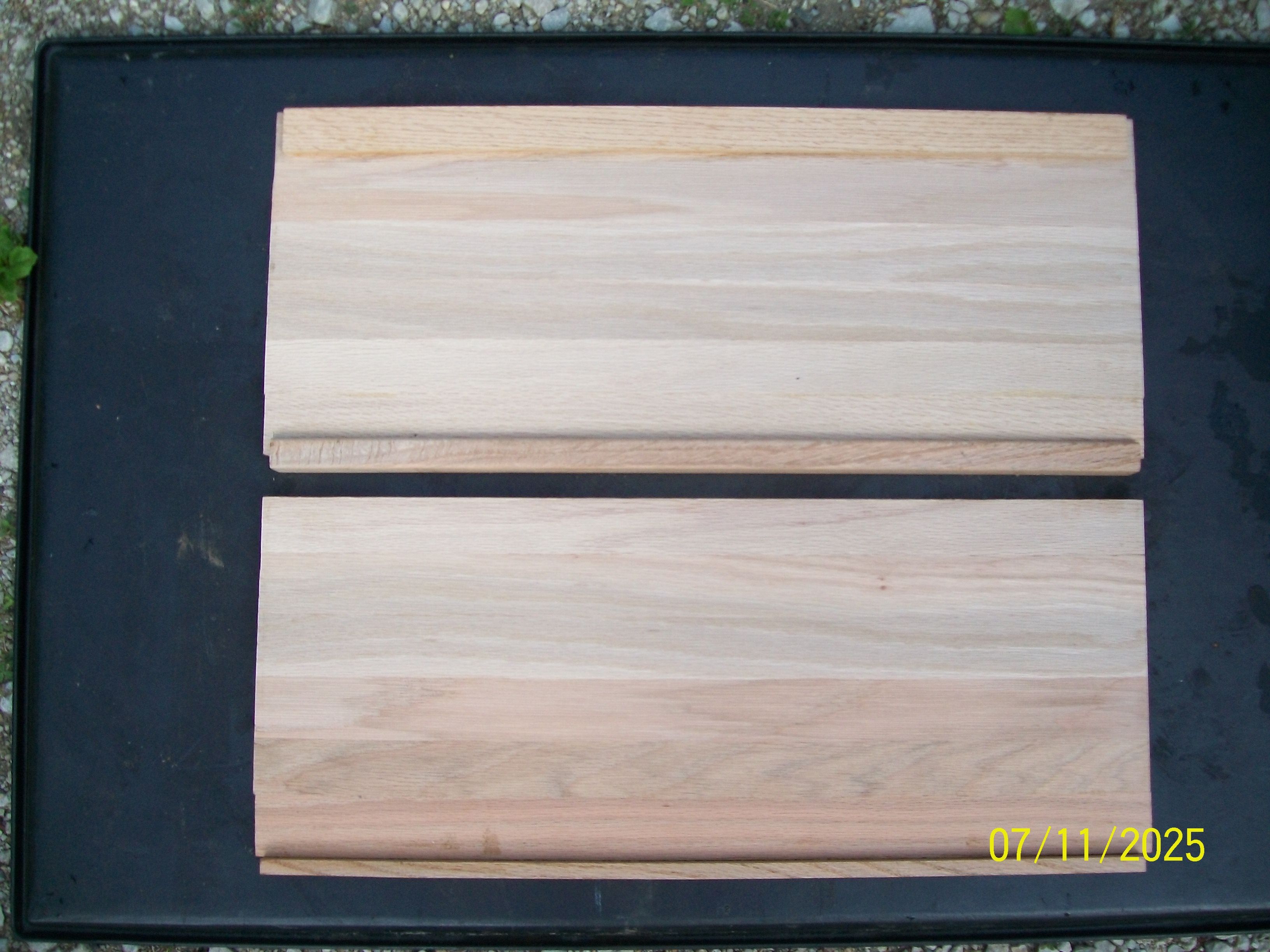

July 11, 20251 yr Author comment_358787 As I reported in the Friday Weekend Agenda Topic, I scored enough 1/4" thick Oak boards to build the front, and sides for the top of the server cabinet. Here's a view of the insides of the front, and back. The front is the top piece. The ends are cutoffs from some scrap Oak T&G boards. Here's a view of the outsides of both. The front, and sides are made from the 1/4" stock. The back is made from the back of a salvaged Oak drawer sides/back and is 7/16" thick. Here's a view of the sides, both inner, and outer sides of them. The top one is the outside. The ends fit into the T&G groove of the front and back. They're both identical. I do believe that I'm done for today, the "Outdoor Shop" is 83° RH 77% DP 74° with a feels like temperature of 94°. The Mosquitos are an instant swarm also. Report
