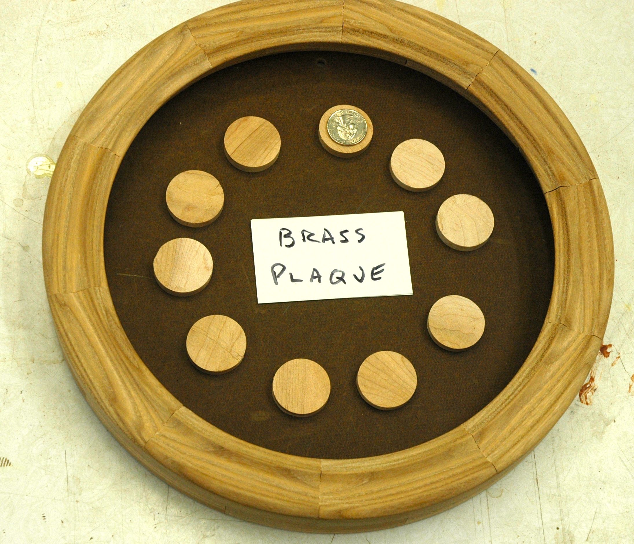

May 22, 20251 yr Popular Post comment_356637 I've got my frames turned and the glass cut. Now I've moved on (or tried) to interior board. I want to mount the quarters on a small piece of maple slightly larger than the quarter and countersunk to hold the coin. I also want this to be face grain for the coins. To keep with the turning part of this I wanted those pieces to be about 1/4"-3/8" thick, and about 1 1/2" wide. My first approach to this hasn't worked so well. I glued some maple squares together to make a stack, thinking I would turn the stack round, and then slice wafers off on my table saw. The turning part has me stumped at the moment. The pick shows one of the glued stacks I started with. Then you see a (sortof) rounded on with huge chip outs in it. Getting it to this point of being round was pretty tough. I tried a 3/8" bowl gouge and was having a lot of catches and just being very hard to turn. I switched to a carbide roghing tool and fared better, at least in getting the corners knocked off. The I went back to the bowl gouge and got to the point it is now, but with those huge chip outs. Is there another way of doing this? Do I need a different gouge? Maybe I should figure on using square mount blocks for the coins. Report

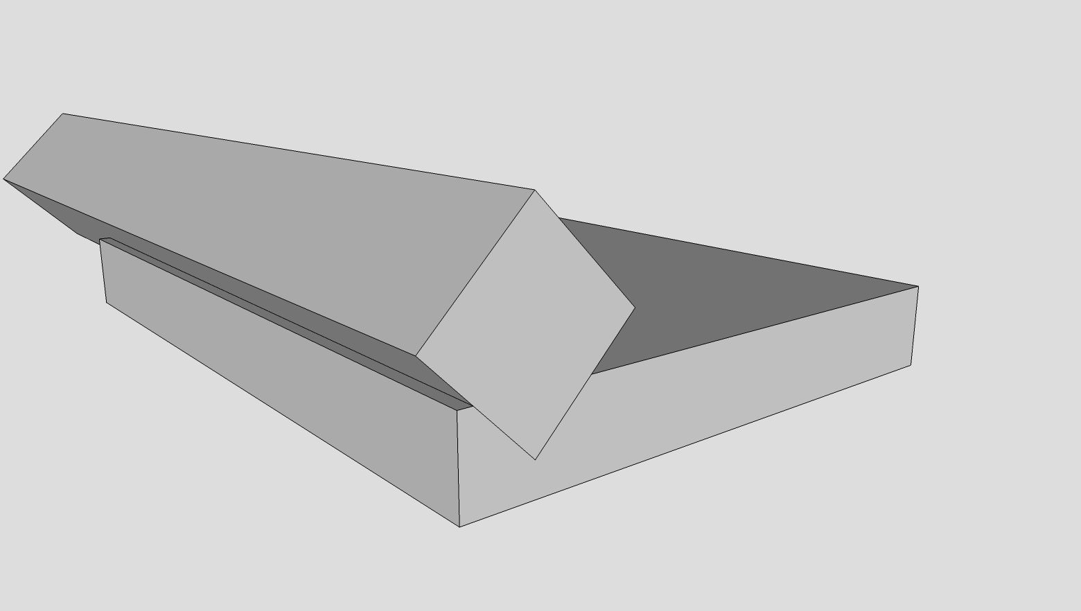

May 22, 20251 yr comment_356638 I would make a jig (of course I would ). A block of wood that has a 45 degree V cut from it. Lay the glued pieces into the groove. The corners should extend past the jig, Run the jig/glued blocks thru the bandsaw or table saw to knock off the corners along the length. I'll find a video Report

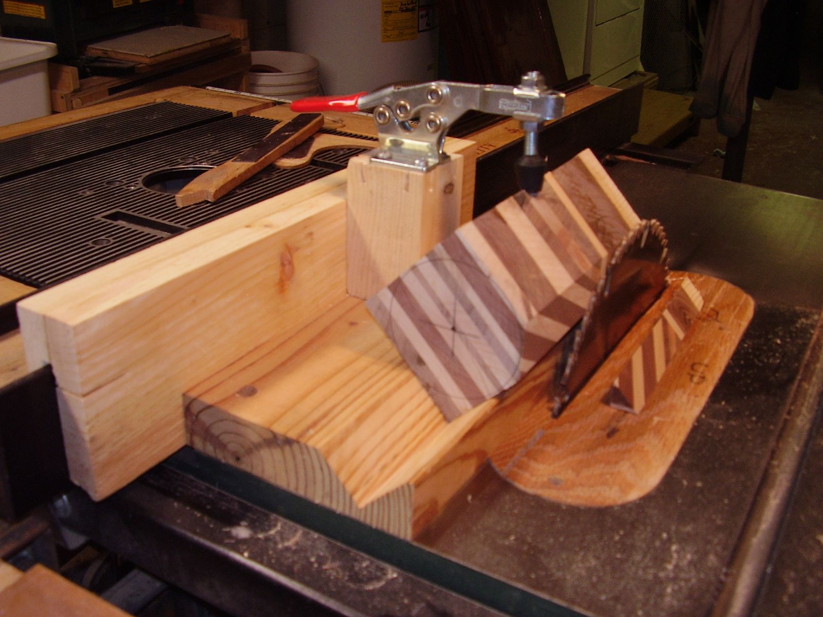

May 22, 20251 yr comment_356640 Something like this This creates an octagon and will have less catches. Report

May 22, 20251 yr Popular Post comment_356644 8 minutes ago, Fred W. Hargis Jr said: So you think my problem is more with the corners not being knocked off? I had considered that, but figured on a 1 1/2" piece it wouldn't be a problem. Yes, I think the sharp corners are doing it. With the pieces oriented so that the "end grain" is on the "sides" the chance of chipping/tearing is enhanced during the spindle turning orientation. Knocking off the larger corners should reduce the amount of end grain surface for catches. Also, instead of the roughing gouge, maybe a spindle gouge would be less aggressive. or the carbide finisher Report

May 23, 20251 yr Author Popular Post comment_356673 Gerald, that billet is hard maple....very hard maple. The reason I did it that way is to have the face grain for the wafers I'm trying to cut instead of end grain. I like the look of the face grain better, plus I think it's less likely to split over time. I need 40 of these wafers, and that glued up billet gets me 12 or so. Turns out that cutting it up into wafers is a little tricky as well. I could do this with a hole saw and then clean it up, but I'm trying to keep working on the lathe. Using a hole saw would leave that big hole in the middle, but that would be covered with the quarter once it's mounted. Here's a mock up of what I hope to put together. You can see one quarter laying on a wafer at the top. Edited May 23, 20251 yr by Fred W. Hargis Jr Report
May 23, 20251 yr Author Popular Post comment_356698 Lew, I went up to 1500 RPM and that seemed to help some more, so now I'm gluing up the remaining billets I need. I also tried cutting them on the band saw. The table saw left a very smooth cut but got the wafer spinning so fast it ran off the outfeed; I couldn't even find some of them, they went in all directions. On the bandsaw the surface is much rougher but they didn't run away. Report

May 24, 20251 yr comment_356710 7 hours ago, Fred W. Hargis Jr said: On the bandsaw the surface is much rougher but they didn't run away. My jig is for bandsaw as well. More control, I do use a 3/4 blade though. Report
