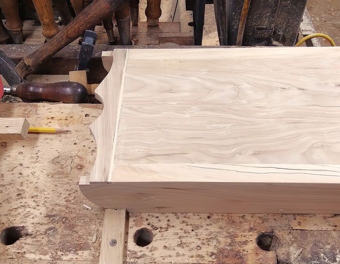

Came out of the clamps...glue joints cleaned up...sanded most of the piece to 220 grit...

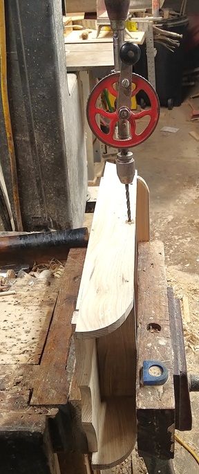

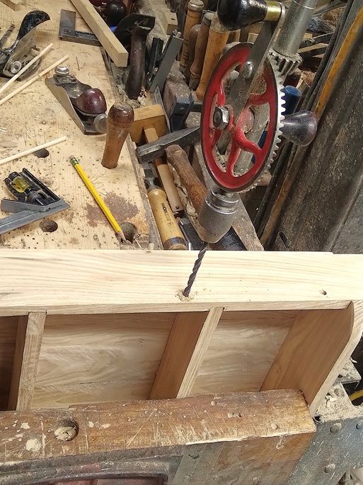

Needed to drill 6 holes, though..
Drill bit is 3/16"..with an eggbeater drill...:ChinScratch:

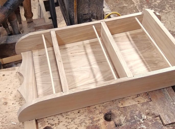

Needed to add 3 dowel rods....so:TwoThumbsUp:
Drive the dowel rods all the way through...no glue...There was a 4th rod to install....:WonderScratch:
Flattened two edges to fit into that gap...add a bead of glue, sand it down flush...:ChinScratch:

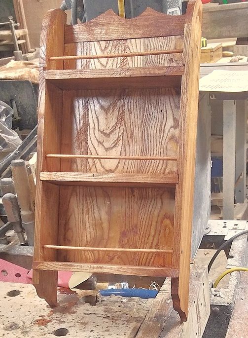

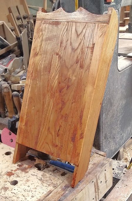

Then the can of Witch's Brew came out..back side down first..:OldManSmiley:
Then the rest...:Cheer:
Rods are there to keep the jars of spices from falling out, when fat feet walk by...:ChinScratch:
Letting this sit over night...and see about some varnish tomorrow?    Might add some "Cup Hooks" to the underside of the bottom shelf?:WonderScratch:

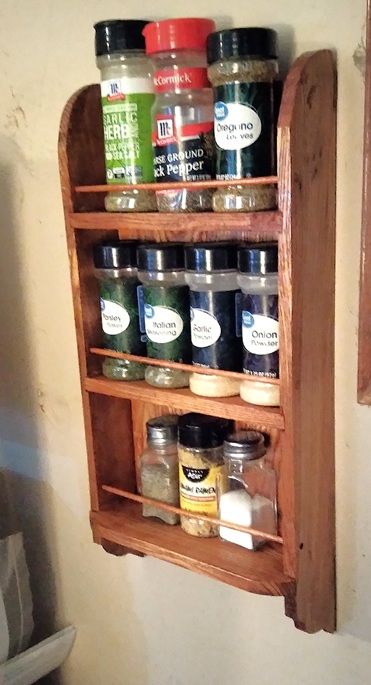

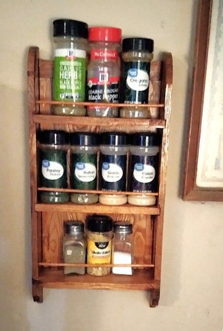

And, now filled up, and hanging on the Kitchen wall..:ChinScratch:
And all the items from the top of the Microwave Oven now have a place to call..Home..:TwoThumbsUp:
Thanks for looking in! :Praise:

You outdid yourself with this one!! Beautiful!!
