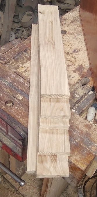

Popular Post steven newman Posted May 16 Author Popular Post Report Posted May 16 Lumber Supply? Should be enough there..counting that other piece... All are supposed to be 1/2" thick.. Was down to the shop, today.. All that rain the last few days...The Dungeon Creek has risen..Might wait a few, until the place dries out a bit? Gunny, Harry Brink, Al B and 6 others 8 1 Quote

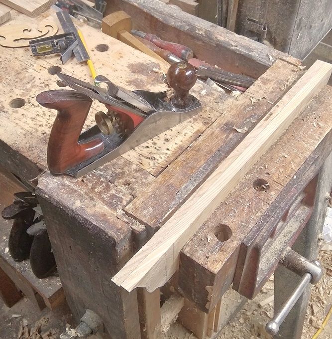

Popular Post steven newman Posted May 18 Author Popular Post Report Posted May 18 Decided to drag this old machine out, and clean it up.. Then a bit of layout.. Then, buy the time I cut both ends, transfer those lines to a second board, cut those lines, plane both edges to match the other 2 edges... Give everything a swipe with the #80.. I now have both sides of the New Spice Rack ready for Dados... Stay tuned... lew, Harry Brink, DuckSoup and 7 others 10 Quote

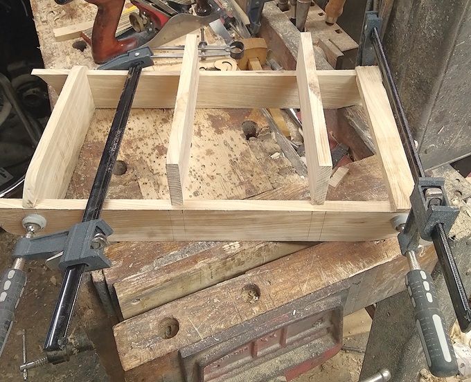

Popular Post steven newman Posted May 21 Author Popular Post Report Posted May 21 Went to the shop...merely to measure for the shelves...wound up doing some cuts.. A wider shelf for the bottom, was notched...and a finial was shaped... A dry fit was attempted... middle and upper shelf will sit in shallow dados... As for a back? These will need resawn, to match the other and last two 1/2"thick planks.. So I can glue this mess up into a panel for the back of the rack. Stay tuned... Gerald, Gunny, lew and 6 others 9 Quote

Popular Post steven newman Posted May 22 Author Popular Post Report Posted May 22 Busy morning? Resaws.. Laid out.. Need the edges cleaned up... Finial has a Rebate going on.. To house the back panel in.. dados for the shelves have been milled...dry fit .. Shelves fit, but are a blade width too long, and a bit too wide... Picking dried glue off of me fingers... Letting this sit a day. Stay tuned.. Fred W. Hargis Jr, Harry Brink, Gerald and 4 others 7 Quote

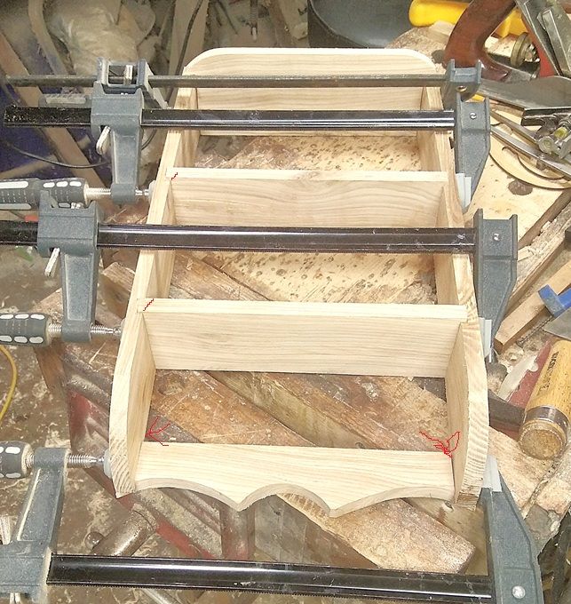

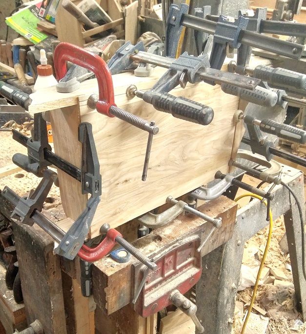

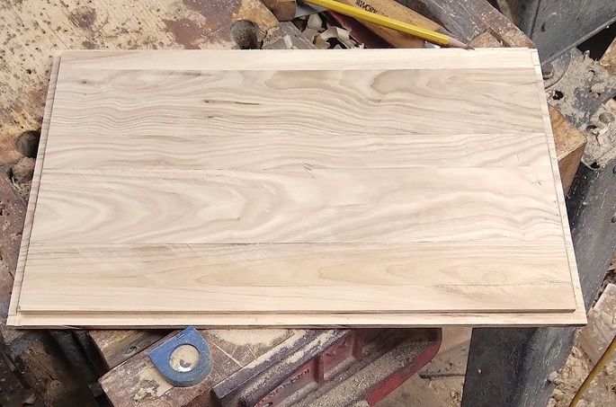

Popular Post steven newman Posted May 25 Author Popular Post Report Posted May 25 Picking glue off'n me fingers, right now... Out of the clamps, this needed a trim.. After trimmed square, it needed to loose a bit of width.. About that much from each edge....then a rebate was milled.. But first, it needed to be flat, and smooth...we have ways.. As for smooth, well... Makes things a bit easier... Tried a few dry fits, adjusted sizes as needed...until. . One of the dry fits to see how much the shelves needed to be in width,, Then..the cussing could begin And.. Bench Vise as a Helping Hand... Waiting on Glue to cure....there are no metal fasteners used, all glue joints.. Stay tuned.. Grandpadave52, Harry Brink, HARO50 and 3 others 4 1 1 Quote
