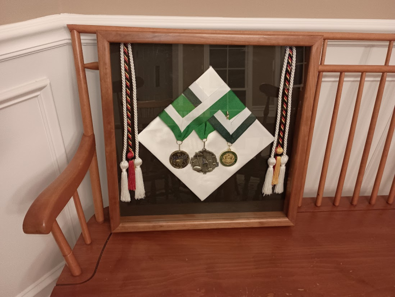

April 12, 20251 yr comment_355109 17 minutes ago, John Morris said: @kmealy is that bench one of your creations? Yes, it was a kit that I did very early in my woodworking journey. Report
April 12, 20251 yr comment_355110 18 minutes ago, kmealy said: Yes, it was a kit that I did very early in my woodworking journey. Love it! Has that birdcage Windsor look to it. What a neat piece to have in the home! Report
