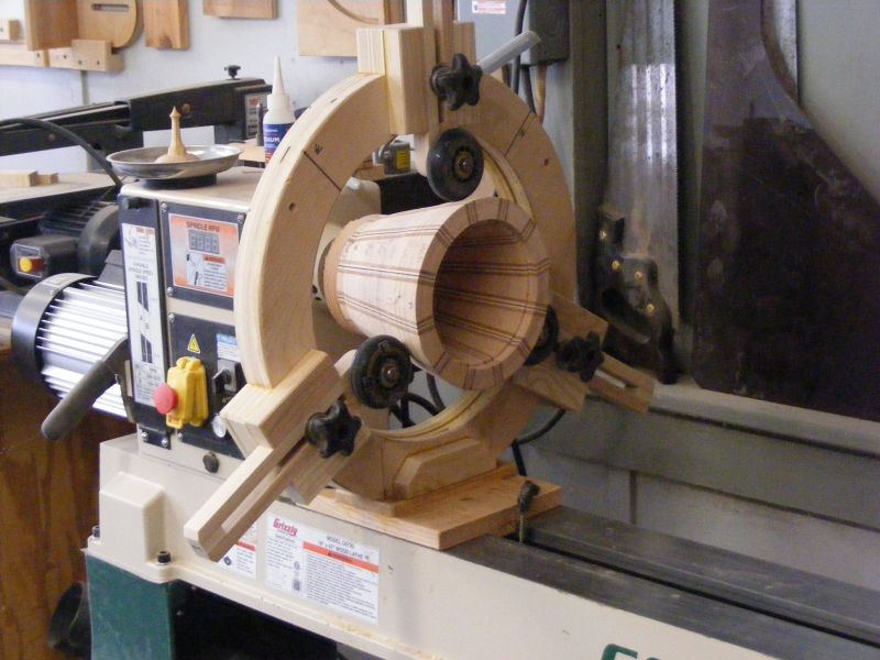

Thanks for the note wish I could contribute but never tried vacuum chucks. I made a donut chuck and used it for a time until I scavenged the material for my steady rest.
That is a really nice steady rest!
