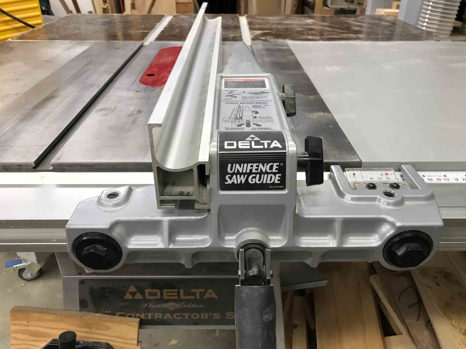

I found a Delta Platinum Edition. Tag says Delta Pittsburgh PA - Made in USA - Manual is dated right around 1999. Anybody know anything about these. I know the newer Delta's are crappy.

I am still using one.  I purchased it new in 1999 (I think).  The one issue is the switch will need to be replaced now or then.  Parts are available.   They sold both right-tilt and left-tilt arbors.  It has been a very good saw with cast iron wing.  I can rip 36" to right of blade.  What is the seller asking for price?  Danl

He wants $900.  He has it with a built in cabinet under the extension and a 3 x 4'  folding outfeed table, all on a custom base on rollers, along with all the accessories he's added thru the years.
I can not advise you which TS to purchase, but the used Delta has a cast iron wing and the three new saws have a sheet metal wing.  In general, the cast iron is machined +/- 0.010.  The sheet metal may be +/ 0.030.   Danl
Don't know if it's a good price or not AND whether it'll all fit in my space.
The pricing is hard to judge. But if that saw fits in your space it would be a good one to have. The fence alone would put it on mu consideration list. I had a delta contractor saw and then a Unisaw and both had Unifences. I've moved on to a Biesemeyer type and still miss having the Unifence.
