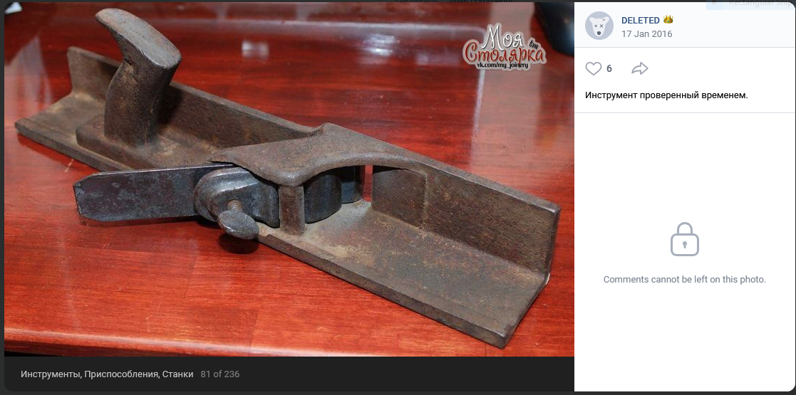

Found this picture on my hunting trips but there is no explanation for this either.
Looks like an old shooting board plane to me Dan, doesn't have the skew to the iron but I've seen them without.
Looks home made
