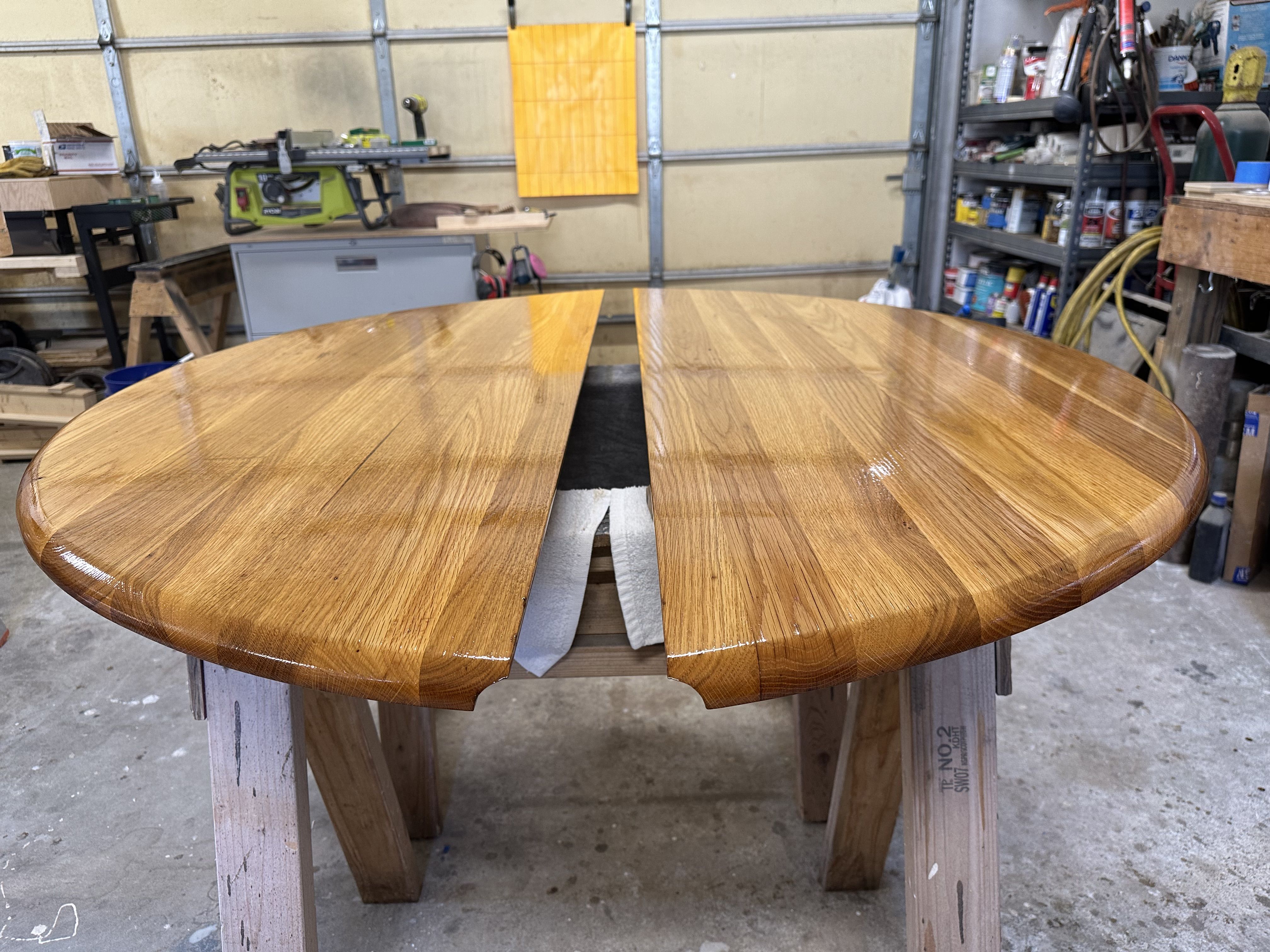

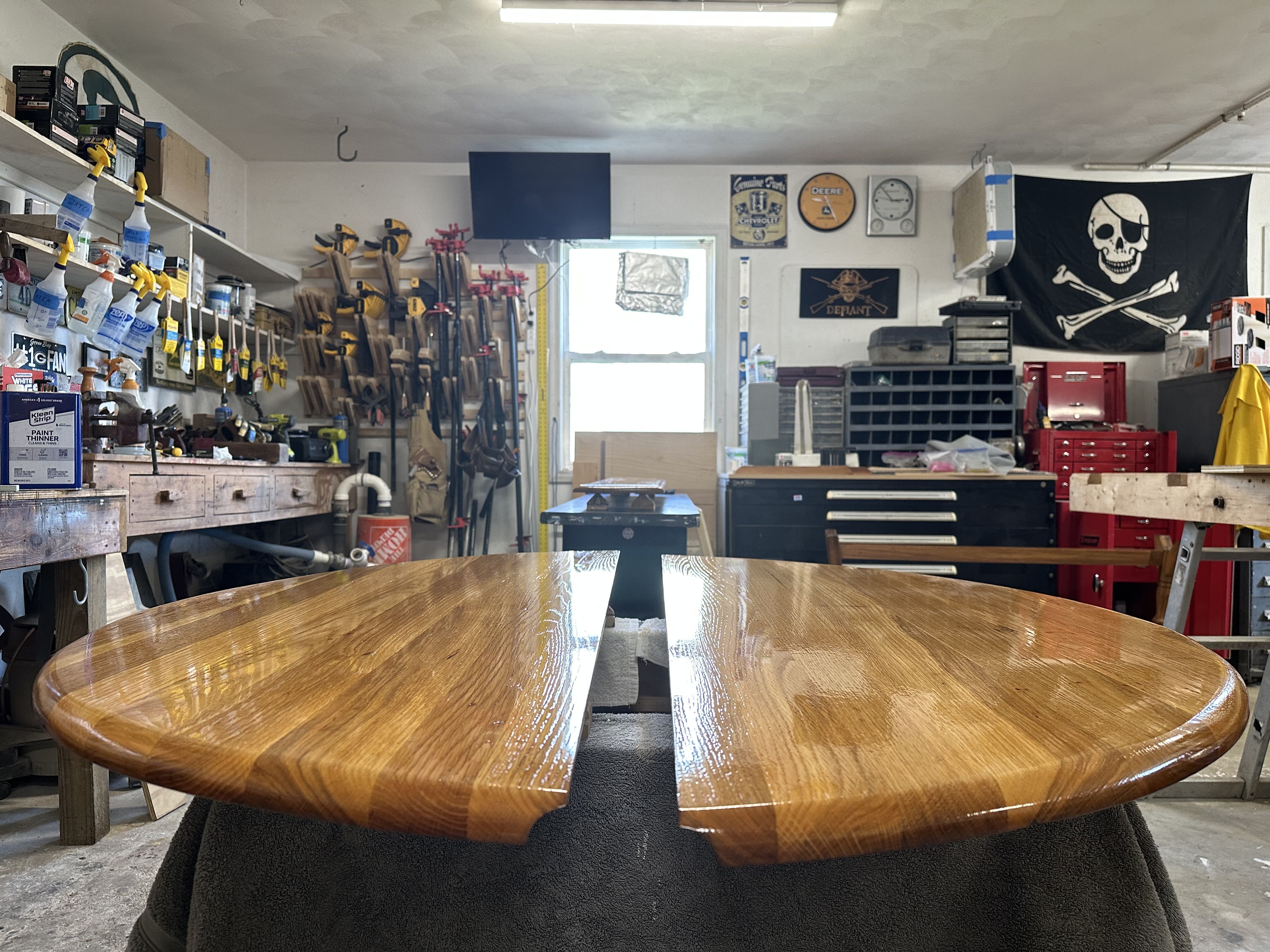

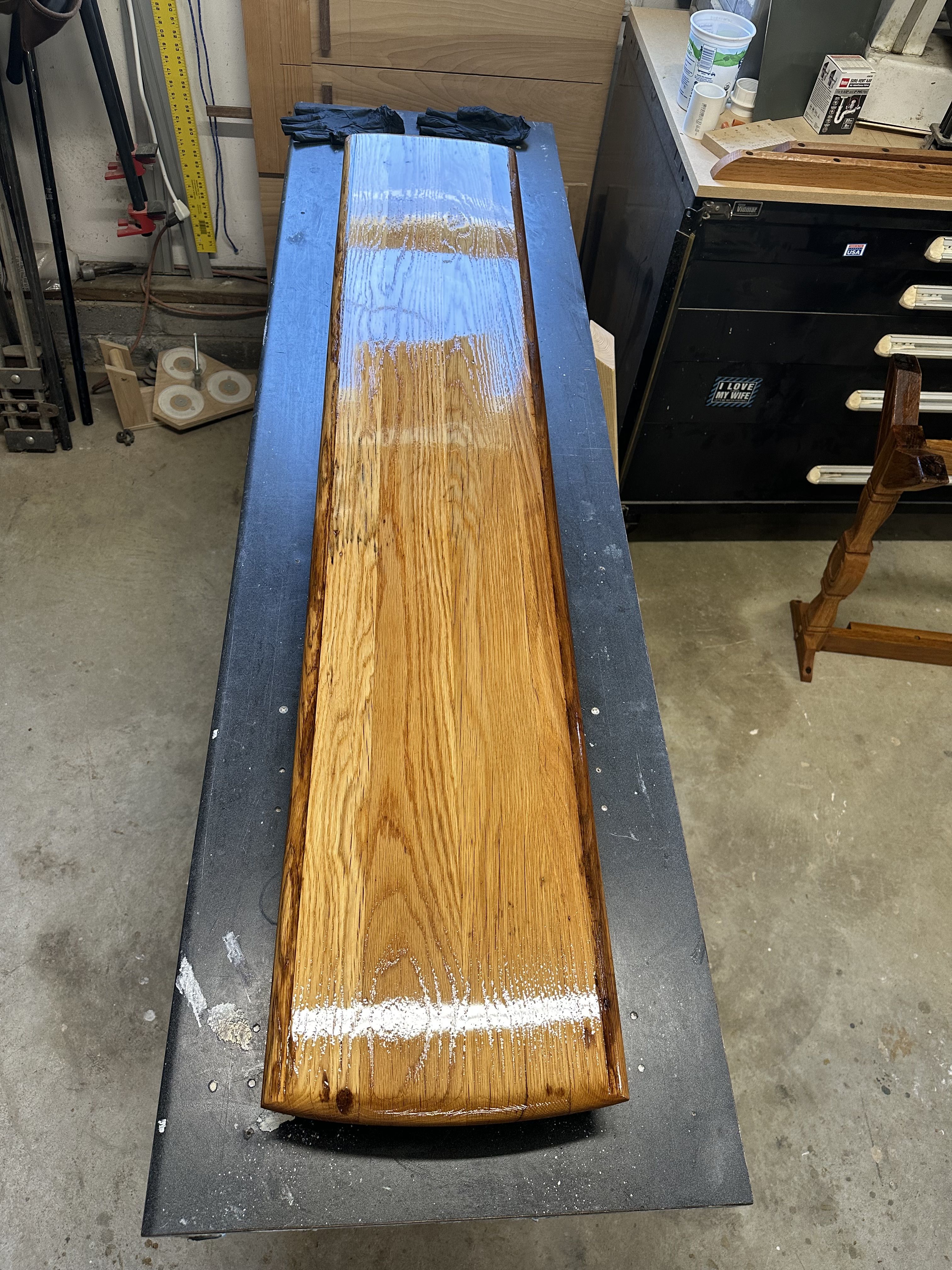

March 29, 20251 yr Author Popular Post comment_354479 Put 4 coats of polyurethane on the table top pieces. I’m happy with the amount of grain filling so stopping at 4, just the deeper grain still shows. I’ll let that cure for a couple of weeks and rub it out with some 0000 steel wool. I’ll get the frame finished while the top is curing. Report
